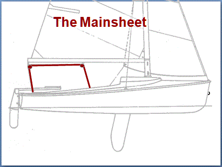

mainsheet is the last of the five basic controls.
Unlike the jib sheet, the mainsheet only moves the clew of the main in two directions, in and down. That is because the clew is attached to the boom and the tension in the foot of the sail is controlled by the
outhaul. The outhaul is another control that is adjusted on a U curve: tight for very light and heavy air, looser in-between and loosest for moderately light airs, or when you want extra power against chop. Flattening the sail depowers it, good for heavy winds, but also allows the flow over the sail to remain attached more easily, good for very light airs.
Sheeting in the main pulls the end of the boom in, changing the angle of attack of the main. At the same time, it also pulls the end of the boom down, tightening the leech of the sail. As for the jib, less tension in the leech means more twist. Because the jib changes the airflow, we can sheet in the main further than we sheet in the jib. To know how far, we use the
telltales at the leech of the mast: if they all stream aft, but the uppermost flicks behind the sail every once in a while, the main is trimmed to the correct angle.
