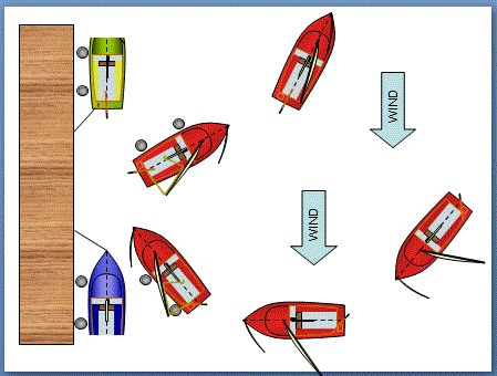

There are many situations where you can sail directly from or back to the dock. Here's the basic technique:
Sailing to and from a dock
Sailing from the dock: When you rig your boat, you have it pointed into the wind, so that the sails don't catch the wind until you are ready. With tiller fixed, sails raised, and centerboard down, you push off the dock with a bit of forward momentum so that there's flow over CB and rudder and you can steer away from the dock (or if the wind serves, just push the bow out). Sheet in, accelerate and you are off.
Sailing back to the dock: The trick here is that you need to slow down and take the wind out of the sails as you approach the dock. You may have to do a U-turn to do it. I've shown fenders out, but the older DS1s with their rub rail may not even need that, depending on the dock (at least not right away). You set up your approach so you can coast upwind with the sails slack. With a bit of practice you'll know how far you need to coast to slow down in the conditions. You can further slow down with rapid tiller movements, or even setting the tiller at full 90 degrees, or by sticking a paddle into the water and holding it still (the same paddle, or pumping the tiller, will work if your approach fell short).
The DS doesn't need all that much space for a U turn, so this technique works often even for docks that are at the end of a sort of cul-de-sac. If you need to make a U-turn right after leaving the dock, just make sure that you have good flow over centerboard and rudder blade and that you don't stall the rudder by giving too much tiller. If you stall your foils, you'll find yourself sailing sideways when that's not your intention (same if forget to drop your CB).
Other wind directions: If the wind isn't nicely parallel to the dock, that's usually not too much of a problem, as long as the wind isn't blowing directly onto the dock. If it blows away from the dock, you may have to rig your boat with only the bow tied on so it can weathervane, and sailing back to the dock you'll approach at right angles and perhaps also tie up only the bow until the sails are down.
If the wind blows squarely onto the dock, you may be able to still sail off (especially if the dock space isn't as tight as in the diagram, so you can sail parallel to the dock for a bit). However, there's no way you can set up to coast against the wind coming in. There are techniques that work, but they require knowing how to "heave to" (a useful concept in and of itself). Or you could drop your sails a bit further out and have the wind drift you to the dock (best with a paddle handy).
Finally, if you are in a place that has multiple parallel docks, you may be able to use a line and helpers to maneuver your boat in spaces that are too tight to sail out of. (Getting into such places sometimes just requires a bit of momentum)

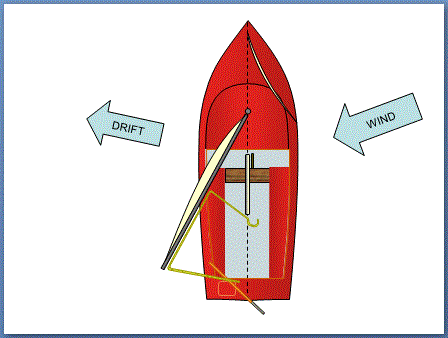

Postby GreenLake » Thu Jul 09, 2020 3:58 pm
Heaving to is a simple and very useful technique to "park" on the water. Being able to put your boat into the hove to state is an essential skill that allows you to stop actively sailing the boat, whether to take a brief rest, or to sort something out with the rigging. It can also be used in some other situations.
The basic idea is that you adjust sails and rudder in a way that they balance: the jib is backwinded to drive the bow down and the tiller is pushed to leeward to drive the bow up. The centerboard is down and provides the common pivot for both of these opposing rotations.
Heaving to
The result is a stable balance with the boat drifting slowly downwind. The main is eased, but may be sheeted in a bit to control forward reach of the boat or help with balancing the jib (if the main is engaged it will tend to turn the boat more into the wind). The drift is slow and controlled, more forward than true downwind: The boat will lie at about 60° off the wind.
Once the balance has been reached, the jib can be cleated, and the tiller lashed. The boat will remain in a stable attitude, even if the wind is gusty or oscillates. If the boat felt lively sailing upwind, you will be amazed how calm it feels when hove to. The boat will tend to itself: you can break out a snack; deal with anything you need both hands for; catch a needed breath or two; put in or take out a reef; or use the controlled drift to slowly move downwind. (The last can be useful in some circumstances: for example, in approaching a man or object overboard or in docking in a downwind direction).
How to heave to: The easiest way to heave to is to attempt a tack, but to not release the jib (so it ends up backwinded). As the boat turns, you put the tiller on the opposite side to stop and counteract the turn. You may find that it takes a bit of practice to prevent the boat from turning too far. If that happens, just release the jib and try again.
How to start sailing again: Just release the jib and sheet it in one the other side, sheet in the main and you are good.

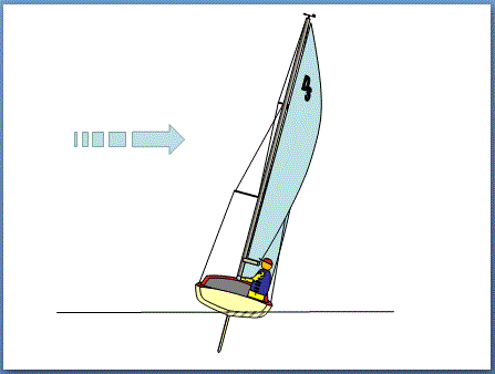

Heel boat to leeward: doing so does two things. One, gravity will now swing the boom (and the sail surface) to leeward. This helps a very weak wind to "fill" the sails. Two, you will reduce the wetted surface of the boat (hatched in the picture below).
Heeling to leeward in light winds

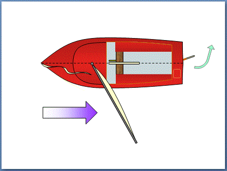

Sometimes you need to slow down or sail backwards. While you can always slow down with a paddle, if you are pointed into the wind, you can also use the sails. Or, if you are stuck "in irons" you can sail backwards to get out of it.
Sailing backwards
The process is dead simple: instead of pulling on the boom with the mainsheet, you throw the sheet loose and push out the boom by hand. The sail will fill to the inboard side of the boom and the wind will start pushing against the boat, either slowing it down or starting to make it sail backwards.
When you've got yourself stuck in "irons", that is, pointed directly at the wind, the jib will luff and the main will weathervane out of the wind, meaning you are just going to sit there. If you stick out the main, the boat will begin to sail backwards. You can adjust the tiller so the boat sails a curve, until he bow points somewhere other than the no-go zone. At that point, you pull in the main and start sailing forward again. Note that while you are sailing backwards, to boat will go in the direction the rudder blade is pointing, and if you were to let go the tiller, the water would push the rudder to full deflection (90°) at which point it acts as a brake an is no longer effective in steering. So hold onto that tiller!
PS: don't throw out your paddle yet, you'll still need it, for example, if you want to slow down the boat when not sailing against the wind.

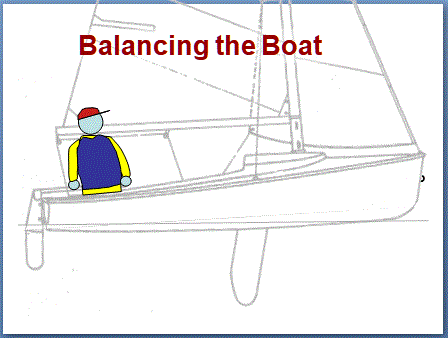

Postby GreenLake » Sat Sep 05, 2020 8:43 pm
A DaySailer does not have ballast, or a ballasted keel, to keep it upright. Instead, it depends on placement of crew weight, in conjunction with hull shape to counteract the heeling forces as discussed in an earlier post. As the wind increases, your crew and you will first sit on the same side, then one or both of you sit on the deck and finally, if the wind is strong enough, you may hike out. Many people fit hiking straps to hook their feet under, so they can lean out all the way, yet remain securely attached to the boat.
Some boat classes even use a trapeze, a wire from the mast that lets the crew "stand" horizontally suspended with their feet on the gunwale. (There's no technical limitation against adding a trapeze to a DS, but it can't be used in racing class-sanctioned events).
Balance (Seating position)
The basic technique of using your weight in gust response has been mentioned earlier: release the main, hike out to flatten the boat, then trim to the new wind. The goal is to keep the boat flat, as it sails fastest that way. If the boat heels, the hull shape becomes asymmetric, steering the boat to windward, adding to any weather helm. This forces you to give more rudder, which slows the boat (higher rudder angles have more drag).
There's an exception in light winds. Here the goal is to reduce the drag, which at low speeds is predominantly due to skin friction from the wetted area. By heeling the boat to leeward (sitting on the leeward side), much of the windward hull is lifted out of the water, reducing wetted area. Try it next time when the wind drops to almost nothing.
Finally, placement of crew weight matters not only across the boat, but also in the fore-aft position. Many people make the mistake of sitting in the middle or even aft portion of the cockpit. As a result, the bow is lifted out of the water and the stern squats. (As shown in the picture). Dragging your transom through the water is slow. How slow? When motoring at around 3 knots my boat gains .5 knots between me sitting in the back to me sitting on the foredeck. Just moving to the forward end of the cockpit gains 10%. Be aware of this and purchase a tiller extension so you can sit as far forward as possible.
Going downwind in strong winds, the wind will push the bow down using the mast as a lever. In that situation you may well want to sit further back, to reduce burying of the bow. Likewise, if you sail fast enough to get your boat on a plane.
Your seating position is one of the controls that are adjusted more frequently - except, again, in light winds, where the goal is to keep the boat as calm as possible.

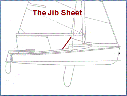

Adjusting the jib sheet is only effective over a partial range of the possible points of sail, from upwind to about beam reach. In all other points of sail that are further downwind the jib does not contribute, because it is shadowed by the main. There’s an exception for sailing dead downwind, where you can sheet the jib on the opposite side to sail “wing-on-wing”.
When you pull on the jib sheet, you are moving the clew of the jib in three directions: aft, down and in.
Which direction predominates depends on the location of the jib fairlead. Most, but not all DaySailers have a short track so that position can be adjusted. The more forward the fairlead is positioned, the more the sheet pulls down (and tightens the leech or aft edge of the jib). With the fairlead positioned aft, the pull is more horizontal. The foot of the sail is straightened, but the leech remains slack and the upper part of the jib is not as tight: the sail has developed “twist”. Twist may be desirable in light winds because the apparent wind changes direction as you move up, but also in heavy winds, to allow some wind to spill.
To find out whether the fairlead is adjusted correctly, look at the telltales or the luff of the sail (its forward edge). If you sail a little bit higher on the wind, so that the jib starts to backwind, the luff should break evenly over the whole sail. (Or the upper and lower set of telltales should respond simultaneously).
The jib sheet
Generally, you sheet in the jib just far enough that the inner telltales begin to flick up or just before it starts to break (you can momentarily point higher to see whether you are close). At some point, you are sailing as high upwind as the boat will go and the jib is trimmed to its maximum (close-hauled). Trying to point higher will slow the boat and increase side slipping (leeway). You may think you are heading higher, but effectively the boat will sail poorly and you are making less progress upwind.
If the foot of your jib is bar taut, you also have gone past the optimal setting for sailing close-hauled. A bit of camber (curve) in the sail is what helps it generate lift. In lighter, but not extremely light conditions a bit of extra belly in your sail will create more power, at the cost of pointing ability. If you are sailing in choppy waters or against a current, you may likewise trade off power for pointing ability.
Once you are close-hauled, the jib cannot be adjusted further; instead, you would use the tiller to adjust the boat’s heading to any changes in apparent wind.
The jib sheets are always routed inside the shrouds. Some DaySailers have a set of Barber inhauls. These pull the jib sheet even further inboards, which has the same effect as if the jib fairlead could be moved inwards. In moderately strong winds, this allows a flatter angle of the jib, which helps in pointing.
Instead of one setting for light winds and the opposite setting for heavy winds, jib fairlead and Barber inhauls are adjusted in a U curve if you will. For both light winds and heavy winds they are at their zero position (aft, or off) and for moderately strong winds around 8-12 knots they are at their maximum position (forward, or in).

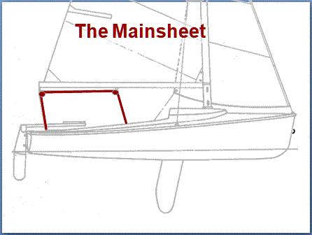

The mainsheet is the last of the five basic controls.
Unlike the jib sheet, the mainsheet only moves the clew of the main in two directions, in and down. That is because the clew is attached to the boom and the tension in the foot of the sail is controlled by the outhaul. The outhaul is another control that is adjusted on a U curve: tight for very light and heavy air, looser in-between and loosest for moderately light airs, or when you want extra power against chop. Flattening the sail depowers it, good for heavy winds, but also allows the flow over the sail to remain attached more easily, good for very light airs.
Sheeting in the main pulls the end of the boom in, changing the angle of attack of the main. At the same time, it also pulls the end of the boom down, tightening the leech of the sail. As for the jib, less tension in the leech means more twist. Because the jib changes the airflow, we can sheet in the main further than we sheet in the jib. To know how far, we use the telltales at the leech of the mast: if they all stream aft, but the uppermost flicks behind the sail every once in a while, the main is trimmed to the correct angle.
The Mainsheet
For the jib, we are able to change the position of the fairlead to affect the relative strength of the pull in the fore-and-aft and down directions, for the main, we can use the traveler or the vang to change how much leech tension we get when sheeting in the main.
The traveler allows the angle of pull of the mainsheet to change from sideways to down, by allowing the mainsheet block to move from side to side. Not every DS has a traveler, and some that do, don’t have a traveler that is adjustable. If you are a beginner, you might start out with centering an adjustable traveler until you are ready to try to set the sheeting angle and twist of sail independently. When you do, remember that the traveler adjusts the sheeting angle and the mainsheet tension adjusts the twist.
A traveler is active only for a small range of angles when sailing upwind, basically only as long as the boom is inboards. In contrast, a vang acts over the entire range of angles. When sailing downwind, it is used to pull the boom down to maximize the area projected to the wind. If your DaySailer has a stock 3:1 vang, it is intended for that use. Some boats have a much stronger vang (12:1 or even 20:1) which can be used to directly control leech tension (or twist) even when sailing upwind. When used this way, the main sheet mainly controls the angle of attack for the sail. This technique is called vang sheeting.
As a beginner, you can leave the vang off (loose) except when sailing downwind, or when sailing upwind in stronger winds. If you tighten the vang, it will keep the sail flat so it doesn't power up when you let out the main sheet to respond to a gust. At all other points of sail, you can ignore it until you have sorted out the basic controls first.
If you don't cleat your main, but hold it in your hand, you will be able to respond faster to any gusts, a definite safety feature. This is made easier, if you install a ratchet block, which will help you hold the mainsheet while not cleated. (Ratchet blocks can also be used with the jib sheets). Ratchet blocks and a vang are useful improvements that make your boat more controllable.
Another safety improvement would be to add reef points to your main and to install jiffy or slab reefing. However, that's a topic of its own.

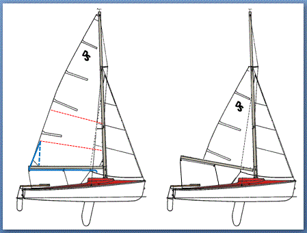

Reefing is a method of reducing sail area when the boat is overpowered in the given conditions.
The sail is prepared beforehand by sewing in reef points, which provide a new clew and tack at some position above the boom. You start reefing the sail by heaving to. Next, you drop the halyard and hook the new tack into a reef hook at the gooseneck. Then tighten the halyard again and also tighten the reef line to pull the new clew down to the boom and away from the mast, tensioning the new foot of the sail. Flake the unused portion of the sail along the boom.
Some sails are fitted with a series of little ties that can be used to tie the unused part of the sail to the boom. However, they have to be released before shaking out the reef. Some sails are made of stiff fabric that does not need to be secured (at least not for the first reef).
When to reef? An old saying has it “as soon as you first think about reefing”.
Reefing the main
The image on the left shows possible locations for a first and second reef, together with a typical placement of the reef line for the first reef (blue). Note that one leg of the reef line (going up from the boom behind the sail) pulls straight down, while the other leg, going to a block at the end of the boom, pulls aft. From there, the reef line is lead forward along the boom to a cleat.
The image on the right shows how what a reefed mainsail might look like for a second reef. Not only is the area reduced, but also the remaining sail area is now lower on the mast (and more forward).
A couple of things worth noting:
• Making the sail area smaller reduces the total heeling force and having more of the sail area closer to the boom reduces the lever arm for a double reduction in heeling moment.
• Because of this, even the first reef with about 18% reduction in sail area has a noticeable effect, and might be sufficient in many conditions.
• For people sailing in heavy wind areas on extended cruises a third reef may prove useful.
• Any sailmaker can add reef points to an existing sail, but there are also kits available.
• Reefs are often placed so that the boom rises slightly from the horizontal position.
• Some boats do not have a reef hook, but use a reef line for the tack as well.
Finally, the more severe a reef is put in the mainsail, the more the sail plan becomes unbalanced: the jib begins to dominate not only because of its unchanged size, but because the remaining area of the mainsail is also further forward. This can make it harder to point. Eventually, it may be advisable to switch to a smaller jib, especially in conditions where you might be using a third reef.

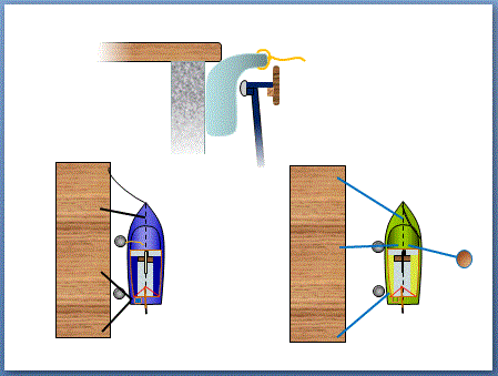

Some comments about tying up a DS at the dock.
If a dock has a simple vertical wall, no fenders may be needed, particularly for older DS1s which are equipped with a rubrail. That rubrail is often good enough, except for tying up for extended periods, or where there is strong wave or wake action. On other types of dock, the rubrail can be either too high or too low, so that some fenders are needed.
A 5.5" diameter fender extends comfortably from the hull past the edge of the rail to make contact with the dock. Sometimes it's enough to tie a single fender at the widest part of the boat and use three lines as shown to hold the boat in place. (Usually it's a good idea to add a second fender near the stern as well, because it could more easily make contact with the dock). Because there's not much freeboard even at the cuddy, it may be easier to tie off a fender on the cuddy deck cleat than on the chain plate.
Some boats come equipped with special clips into which a washer attached to the fender line is inserted. In that case, the locations for the fenders are pre-determined.
Tying up at the Dock
Note that I've shown the bow line as slack, and instead show a line attached to the foredeck cleat. That's because a sideways pull on the bow eye is not recommended. But the bowline can be used at a shallow angle to limit the fore-aft movement of the boat.
If the top of the deck for the DS is lower than the dock, the boat can "dive" under the dock. For that situation there are special L-shaped "low freeboard" fenders as shown in the sketch at the top. Not only do they protect the top of the deck a bit, they also hang over the rubrail and increase the distance between hull and dock. That fender works particularly well in the rear of the boat.
However, if wave action from the wakes of passing boats is likely to slam the DS into the dock from below, even a low freeboard fender may not be enough. To keep your DS safe, you need to tie a line to some post or dock opposite to hold it off the dock, as shown on the right.
A bit about terminology: a line that is tied going forward or back along the dock is called a spring line. It limits the fore-and-aft motion of the boat. A line that goes from bow or stern at right angles to the dock is a breast line or stern line.
When tied up at the dock, raise the CB and tie off the tiller so it's amidships.
If you plan on staying away for extended periods you may want to use additional lines or fenders for added security, as well as unship the rudder and storing it in the boat. For a short stay, it may be enough to loosely wrap the sails so they can't catch the wind, but if you are leaving the boat behind, you may want to remove the jib and cover or remove the main.
Every dock and every docking situation is slightly different. What works in one case, may not work everywhere, and conditions can change with weather and passing boat traffic. For that reason, the discussion here can at best serve as a starting point.
