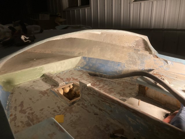

What is this thing called? It's the ledge where the rubber "bumper" is attached that goes around that boat. Seems like it's where the two sheets of laminate of the deck and topsides are stapled together.
IMG-7275 (Medium).jpg (95.09 KiB) Viewed 452499 times
I've been putting off sanding it because it kills my orbital sanding discs really fast, what with the small edge and the staples. It's in mostly good condition, except some spots that need fairing on the bottom of it. Also, the outside edge of this ledge seems to be pretty raw laminate/wood with little epoxy, so I guess I'll just paint a thin coat of epoxy back on there (don't want to make it took thick so the bumper still fits,) before priming and painting?

I can't help with the proper name of that joint, but do you have an air compressor? If so, and it's big enough to run a die grinder, there are small sanding discs/pads that can go in a die grinder. They are available at Harbor Freight and many other places, and of course online, in many grits. They seem to hold up better than the pads for my RO sanders. If no air compressor, I believe electric die grinders are out there too but they are a bit clunky to use. I like the air ones better as they are small and light so less fatigue.

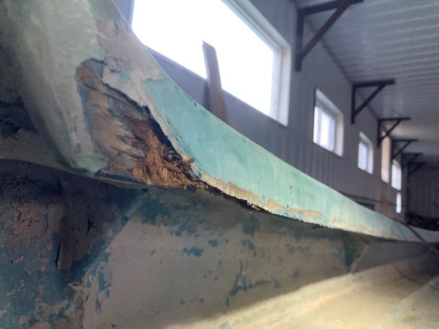

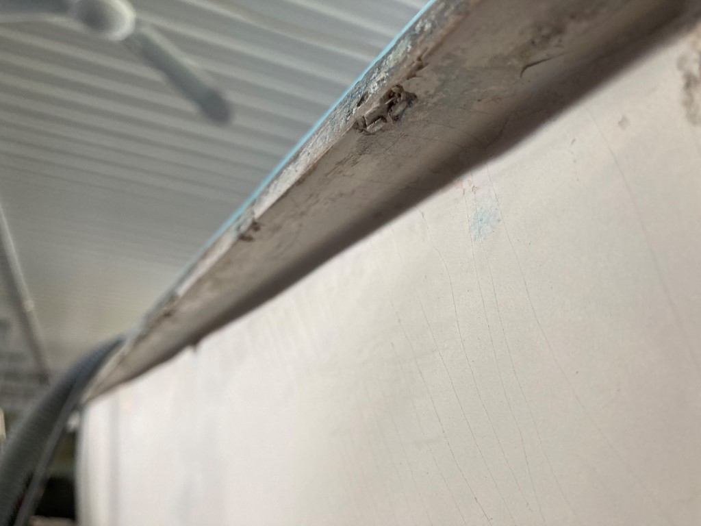

Found another surprise today.
IMG-7318 (Small).jpg (68.72 KiB) Viewed 452476 times
IMG-7321 (Small).jpg (89.86 KiB) Viewed 452476 times

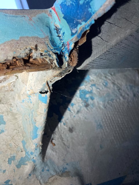

This is what the coaming bolts onto, and is attached to the deck on the sides, but is just a right angle piece of wood covered on both sides by glass/gelcoat. The gelcoat/glass is fine, but the wood is SUPER rotted, so much so that I can just pull it out through the bottom where it's exposed. I guess this happened because some of the fiberglass on each side and bottom delaminted and let moisture in. Funny enough, it was just this side that was rotten, both the other side of the boat, as well as the identical coaming-holder to the aft were both mostly fine.
If it wasn't only open from the bottom, I'd just soak the whole thing in Rotfix and fiberglass over it. But I can't get Rotfix to soak upwards, and I'm not going to flip the boat. I don't have experience removing structural wood from the boat and replacing it, and especially with this piece being attached to the deck at a 90 degree angle, I don't even know how that would work. It seems like, besides being glassed to the deck on its underside, it's also glassed in on the sides.
Another thought was to sand/pry away the fiberglass/gelcoat on the front face of this thing, scrape away/rotfix any rotted wood, and then replace it piecemeal or wholesale with filler (sculptwood or 3m) just like I did on the transom. Since it the wood seems to be sandwiched in on both sides with fiberglass, I could use the backing as a canvas to "repaint" wood onto, and then reglass the front, fair it up nicely (especially on that angle..) and maybe that's easier than replacing the whole piece?
Or I could just fiberglass over the rotten wood and pretend like it's not a problem. It's definitely not very weak, although this structural piece is noticeably weaker than the same one on the port side.
I'm tired of finding new things wrong everyday! Lol.

Postby GreenLake » Wed Nov 04, 2020 9:03 pm
Have you tried locally reversing the gravity gradient?
I would:
  1. try to determine the extend of the worst
  2. cut the inside fiberglass and wood where you think you might need to replace
  3. bevel the cut edges of any fiberglass
  4. make up a piece of exterior grad plywood to fit the removed
  5. glue in place w/ epoxy
  6. seal any other sides in epoxy
  7. re-laminate to restore the fiberglass sheath
Lots of steps, but none that are very complex. The "woodworking" is limited to cutting plywood to where it fills what you've removed. There's no need to try for tolerances much better than 1/8", not only will the epoxy bridge that, but the piece you are repairing has backing and once you re-laminate the front, support from that side also. If you don't have an electric jigsaw, even a coping saw would do for cutting the replacement.
The way this is designed, if I understand correctly that there is fiberglass in back as well, the plywood would be like the core in a sandwich. If that's the case, much of the strength comes from the skins being spatially separated (and for that to work, the bond to the wood needs to be good - another reason to cut away crumbling wood. If one side is better than the other and you need to preserve your limited capital of project time, then I'd fully understand if you focused only on the worst areas.
Other people might tell you to place your cuts at the top of the coamings and taking all the wood out. That would ensure you don't have to do it again in your next three lifetimes, but some of us are more hesitant about radical surgery. Just season to taste and go with it.

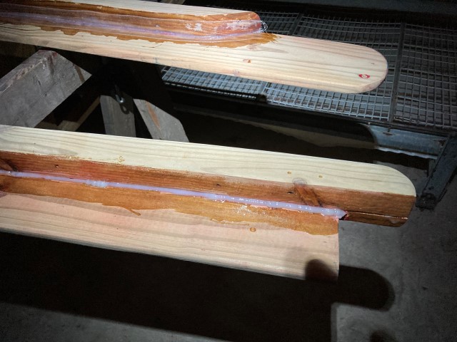

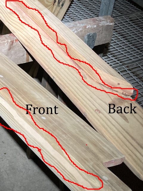

Had to open a new GelMagic tip today, so wanted to make the most of it and use it on a bunch of different things I was going to "Magic." One of which is the aformentioned coamings, which were actually constructed out of two pieces, one that lies on top of the deck and actually holds most of the weight by being bolted into the deck from below. I really like the original coamings because having this extra over-deck piece allows them to have a slightly back-learning slant. Plus I didn't want to buy new wood and cut everything when these are fine with a little care.
The thing is, there is some separation between the two pieces of the coaming, a crack. On top, this crack seems to maybe have rotted at some point, as the PO gouged out a 1/2" wide strip (inconsistently) along this crack and then filled it with wood filler. Or maybe it hadn't rotted, as I saw no signs of rot after taking out that old filler, maybe they just wanted the filler to have a better bite. Anyways, for resealing that crack on the top - easy - just take out old filler and add new. Done.
The bottom and sides are another thing. So for the bottom, I thought to essentially do a bit of a fillet with GelMagic, and then cover that with glass tape and epoxy. (Actually, I'll be glass tape and epoxying over the wood filler on the top crack too.) I did that tonight, but was disappointed by how poorly the glass tape absorbed the epoxy. It was 4 oz bidirectional. After reading Amazon reviews, seems like I wasn't the only one with that problem. For covering fillet seams like this (and the upcoming one on my footboards) what type/weight of glass tape is good? I'll probably order my next batch from S3.
Here's a shot pre-Magic/tape. You can see the front of one coaming (with the new wood filler on the top of the joint) and the back of the other coaming (with the back crack of the joint circled.)
IMG-7326 copy (Small).jpg (124.1 KiB) Viewed 452454 times
And then here's the result after my meh job of sealing them:
IMG-7330 (Small).jpg (85.28 KiB) Viewed 452454 times
I used two slightly different techniques. The back coaming I "filleted" how I think fillets work: I ran a bead of GelMagic on the crack, didn't wait for it to gel or anything (is that right?,) and then used one of my mixing sticks to sort of smooth it out (it was a narrow bead, maybe 1/8") and then threw on my dry glass tape, and wetted the glass tape from the top. It took a LOT of work to get the glass tape to absorb the epoxy, but eventually it did seem to wet down quite well, and this might be just because of the quality of the tape I have.
In the front coaming, I ran a bead of GelMagic on the crack, DIDN'T smooth it with the stick, but just left it as the long bead, and then also pre wetted the board itself, like I normally would when I put a fiberglass patch on something. This, however, perhaps again because of my tape, didn't really help the wet down process when I put the dry tape on and then painted epoxy over top of it. I'm worried this second board won't fit quite as well onto the deck, as the 90 degree angle of the joint might be a bit obstructed since I didn't smooth the bead of GelMagic out. We'll see tomorrow. Either way, not a big deal, as I'll probably do what the PO did and seal the space between the back part of the coaming and the deck with silicone.
Was an interesting experiemtn, and leaves me with what I'd do if this was me doing my real-deal fillet on my footboards where any mistakes I make will be much more visible (albeit Easypoxied over.)
1. How do you use glass tape? I assume you don't pre wet out the whole 8' tape, nor use it in short lengths, but do what I did, and either wet the surface it attaches to and then on top, or just on top?
2. When filleting (with Gelmagic, EZ fillet, or whatever) how is the filleting compound and tape supposed to interact with each other. I found this on S3's site about EZ Fillet:
"Alternatively, the tape can be applied after EZ-Fillet starts to get stiff. Use SilverTip Laminating Resin for this purpose and work EZ-Fillet under the wet tape for a smooth, bubble-free composite."
So wait for the fillet compound to start to cure, and then wet glass tape onto it and "work EZ-fillet under the wet tape." What does that mean? Are they talking about using the glass tape to sort of mold the fillet into shape somehow? That sounds like a mess.
3. I know I should've removed more epoxy, as I didn't really work to "drag" it with my plastic scraper, as the glass tape tended to want to move around a lot when I did this. Same for my GelMagic -- I was very quick with my fillet technique, and I don't get how there can be so much wiggle room to so carefully sculpt this little line of sticky goop. Or maybe it was because I didn't let it start to set first?

Gel-Magic is non-sagging, but it's not really great filleting material, since you want the bulking effect of the wood dust. However, while I did help a friend fix rot damage from exposure on a wooden (plywood) dinghy once, it's too long ago for me to accurately remember what we did (and I didn't report it here, not being related to a DS :( ).
The point of filleting is twofold. One, it widens the joint, so strengthens the connection. Might not be equally important for all joins. The other thing a fillet does is to limit how sharply you need to bend/fold the fiberglass to make it connect two pieces. If you let the fillet "gel" it won't move when you apply other stuff on top of it. The thing in those instructions I find a bit puzzling but interpret that having a bit of a fresh layer makes sure the tape is well and evenly supported.
So, if you used GelMagic as a poor man's fillet for a 90 degree join, then, if you were dead set on following those instructions, you would let the fist applied gel, then add a bit more right before you place your tape. Taping a join mostly matters where two pieces meet at a right angle, if you glue two pieces of wood flat, there's no need to tape that join. (The only other use of tape/glass is on high abrasion locations - like on the DS our coamings have exposed wood where the top edge will get nicks etc. That would be a good place for a bit of glass sheath.).
When you laminate with strips of glass whether tape or strips you've cut from cloth, the way I usually do it is to brush a bit of epoxy onto the surface, put the cloth on, and then lightly brush the top side. After that, I use a spreader to squeeze out excess resin (and force any air out - there should be nothing that looks "white"). There are other techniques, like wetting out strips of fiberglass on a plastic sheet / surface and then transferring them wet.
Any of that make sense?
Speaking of sense. I'm not making sense of your pictures. You've lost me as to where these particular pieces go and in which orientation. They seem a bit unique to your boat model in their shapes.
Sealing wood requires full coating of ALL 6 sides (and the inside of any holes).
