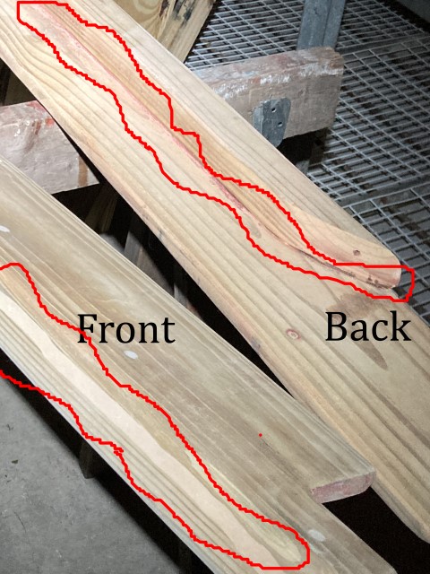

Here's a shot pre-Magic/tape. You can see the front of one coaming (with the new wood filler on the top of the joint) and the back of the other coaming (with the back crack of the joint circled.)
- IMG-7326 copy (Small).jpg (124.1 KiB) Viewed 452426 times
And then here's the result after my meh job of sealing them:
- IMG-7330 (Small).jpg (85.28 KiB) Viewed 452426 times
I used two slightly different techniques. The back coaming I "filleted" how I think fillets work: I ran a bead of GelMagic on the crack, didn't wait for it to gel or anything (is that right?,) and then used one of my mixing sticks to sort of smooth it out (it was a narrow bead, maybe 1/8") and then threw on my dry glass tape, and wetted the glass tape from the top. It took a LOT of work to get the glass tape to absorb the epoxy, but eventually it did seem to wet down quite well, and this might be just because of the quality of the tape I have.
In the front coaming, I ran a bead of GelMagic on the crack, DIDN'T smooth it with the stick, but just left it as the long bead, and then also pre wetted the board itself, like I normally would when I put a fiberglass patch on something. This, however, perhaps again because of my tape, didn't really help the wet down process when I put the dry tape on and then painted epoxy over top of it. I'm worried this second board won't fit quite as well onto the deck, as the 90 degree angle of the joint might be a bit obstructed since I didn't smooth the bead of GelMagic out. We'll see tomorrow. Either way, not a big deal, as I'll probably do what the PO did and seal the space between the back part of the coaming and the deck with silicone.
