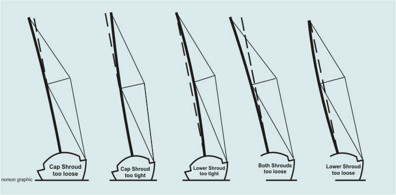

So what are the lower shrouds good for then? Well, for a larger BALLASTED (has a lead keel) boat, over 25' or so, where you'll have a taller mast than we do. If it's a masthead rig, then the side shrouds have to go all the way to the masthead as well. So you have a much larger span for the spreader/shroud combination (the shroud that goes over the end of the spreader like on our boats is called a "capshroud") and there are larger forces involved, thanks to the added height and the counterweight of the ballasted keel. You need extra help to control the side/side (lateral bend) of your rig:
- Rigging
- rigart2.jpg (28.81 KiB) Viewed 23896 times
Bottom line, our little Daysailers don't need that. And, as GL wrote, go for a sail with your lower shrouds rigged and then without, feel the difference. Should be none, except for less aggravation handling your jib.
