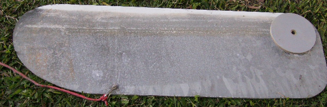

Postby DSGregLS » Sat Dec 27, 2014 4:51 pm
Hi Greenlake,
Here is a photo of the steel centreboard and these are the dimensions. I found these in an earlier post from Brad which was posted by Graham, the PO of my boat. BTW I have been able to contact Graham, although as he never got to sail the boat before selling it, he was not able to provide much info.
LENGTH: 47 5/8 INCH 1210MM
BREADTH: 15 INCH 380 MM
THICKNESS 3/8 INCH 10MM
BOSS AT PIVOT : 1 5/8 INCH THICK
WEIGHT: 70 LBS
CASING DEPTH: 16 ¼ INCH
I understand the standard CB is only 24lbs so at 70lbs these Australian boats should be a bit stiffer. Returning to the issue of side deck stiffness, I can only say that the Australian boats must be made of stronger stuff. Without any coamings to stiffen the side deck at present, there is absolutely no flex. I weigh 175lbs and bouncing on the side deck there is no movement. From some recent holes drilled to fix cleats etc, I estimate the deck at over 12mm (1/2inch) thick. The foredeck is 16mm (2/3inch) thick, measured from a piece I removed to fit a hawse pipe. No wonder Brad suggested their weight would make them quite uncompetitive with US boats.
