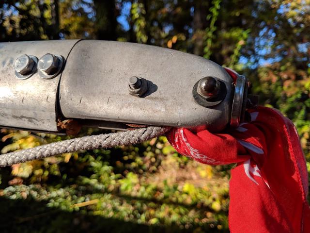

My journey with DS #37 continues, lots of tweaking, sailing on weekends or after work and doing rigging changes/improvements during the week. Time to tackle my biggest rigging issue - and I'll admit it's a "first world problem" - I can't hoist my mainsail all the way to top of mast! It gets stuck aprox 6 inches from the top. Since I'm not racing, I just downhaul the boom and don't sweat it, but 1) it annoys me and 2) limits the space for my boom vang, cunningham line, etc. Besides, it's not class-legal, I have the gooseneck about 6-7 inches below Band #2 - OK, so I'm sweating it a LITTLE! I'd like to fix it, preferably without major surgery or expense.
I know why it gets stuck - simple, the halyard gets jammed into the top of the mast track. I have a single-sheave masthead, rather than the usual two-sheave masthead, so the loaded side (aft, tied to the sail) of the halyard doesn't clear the back of the mast enough and when the sail is near the top... jams. Here's the masthead, laid down sideways for trailering, with my "Road Safety Bandanna" to safeguard against automotive impalement, and yes, I've since replaced my raggedy-old halyard with Sta-Set:
Masthead
See that "shelf" at the top of the mainsail track? That's where is jams. Last year it even jammed while I was sailing, I had to take the mast down with the main still on it! Simple fellow that I am, I took a champagne cork, cut it in half and shoved it into the top of the track:
Cork
Which works fine to keep it from jamming while I'm sailing, but not enough to raise the sail those final 6 inches. What should I do? I'm thinking aloud here, I see several alternatives:

Just finishing out this conversation, main halyard is MUCH better now. I didn't use plumber's putty, instead I put a appropriately-sized aluminum rod in the slot at the very top, with two screw holes tapped through it crosswise to hold it in place - the screws jam against the inside of the track. Once again, I probably overcomplicated it, but I already had the aluminum rod in my junk drawer. It's easy enough to cut and tap and I wanted something that I can adjust. In my limited testing, I can get the mains'l all the way to the top of the track. A bit of outhaul, a tug on my boom downhaul and wow! my old blown-out sail doesn't look so bad anymore - smooth curves, no wrinkles.

I can't believe it! First, dead calm no wind day, despite the forecast and the front that blew thru. Second, I was doing some new rigging and found that my mainsail was jamming AGAIN, can't get the sail up the last 4 inches (was 6 before). You can queue the "That's what she said" jokes here!
Anyway, even staring thru the handy second-floor window, looking with binoculars, still couldn't figure it out. Thoroughly frustrated and taking advantage of the fact that there is NO wind today, I lowered the mast with the mainsail still on it. OK, I slid the foot off the boom first - actually slide the boom off the foot, same thing but had to unrig a lot of lines. Carefully lowered the mast and went to see what's jamming. It was the bowline knot! Tugged all the way to the top of the track, about an inch of halyard shackle, another inch to the thick part of the knot, and the knot was jamming sideways against my aluminum rod "Stopper" at the top of the sail track. At the very acute angle when everything was raised, there just wasn't enough room for the knot to pass the top of the sail track, stopper rod or no.
Solution? I got rid of the stopper rod and found that the halyard itself was not jamming at the top of the track, it was also the knot - I don't need to modify the top of the track. I got rid of the halyard shackle, put the end of the halyard thru the very small hole at the head of the sail, tied a Figure-8 stopper knot and voila! Pulled the sail all the way to the mast sheave! Too tired out to raise the mast again and try it fully rigged, but this looks like the way. Note that the hole in the sail head is too small to pass a bight (doubled halyard) to make a luggage hitch. So, stopper knot it is, I can see where it may be impossible to untie in the future, but I'll worry about it then. Anyway, tolerances are VERY tight at the top of the mast, at least with my single-sheaved halyard pulley. Must be why O'Day soon went to a double-sheaved masthead :)
