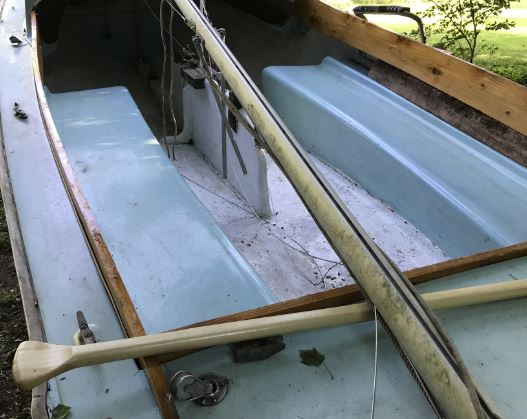

Postby spoke36 » Thu Aug 29, 2019 10:41 pm
I have made new coaming out of 1x8 red cedar for the sides and 1x6 red cedar for the transom. It looks good now but has not been "sea trial tested" or time tested. The side pieces were 8 feet long; I did a free hand taper from the front to match the 1x6 used in the back. The back piece was under 5 feet but I purchased a 6 foot piece which I fitted after the sides were in place. The wood cost about $50 in the summer of 2019. I had to sand the wood with a belt sander on the rough side and where the saber caw cuts were made. I stained the wood with a clear stain/sealer and then used Epifane (a UV-resistant varnish). I spread the sides with boards and clamps to keep the new coaming in place. I used 2 inch stainless #8 screws at 12 inch intervals to hold the new coaming in place. I put the plastic sealing pieces in place -- on starboard with a glue/sealer like 4400 and did not use any glue/sealer on port - just compression from the screws.
I am looking for suggestions for making floor boards. The wood for the coaming and floor boards all rotted. From the forums, it seems to have been Philippine mahogany. Has anyone tried an inexpensive wood and, if so, can share the measurements and any construction hints?
What are the pros and cons of having floor boards? Appearance? Safety?

Postby jalmeida51 » Fri Aug 30, 2019 7:20 am
On my DaySailer1 the p.o. replaced the original coamings with 5/8 mahogany cut even with the side decks. I find it very comfortable when sitting on the rail. In fact it is more comfortable than using the seats. He also removed the floor boards. I painted the hull floor with Petit non-skid which works well. The only advantage is the floor boards look nice when they are varnished and it keeps your stuff dry in the cuddy. To me it means it is something else to maintain.
jalmeida51
Posts: 229
Re: Cockpit trim question (cut or remove)
Postby GreenLake » Fri Aug 30, 2019 3:02 pm
The problem with inexpensive wood for floorboards would be the water-resistance, or lack of it. Anytime the boat ships some water, the boards sit in it. First thing to consider is whether to make the cross-pieces that rest on the hull from something like manufactured decking material. The actual boards would then only sit in water when there is a lot of it in the boat. (Even when you are reasonably diligent, that is bound to happen sooner or later).
In the footwell, the floorboards would distribute pressure of someone standing in the boat, particularly while rigging it on land. Not having them gives more room for your legs (depends on your size, how much that matters) but you can end up with wet feet. For winter sailing, where that would be most annoying, I use sailing boots. In other seasons, it may not be that critical (and while standing water will happen, it is a bit an infrequent problem, esp. in substantial enough amounts)
In the cuddy, this is a different story. Unless all your gear is in dry bags, even a little water will soak it. The floorboards make a nice platform there.
Now, I have a set of very nice floorboards, but I took them out to refinish them (a while back) and then my friends insisted I leave them out when racing my boat - even though what we race in isn't all that competitive. The lack of a forward platform proved annoying rather quickly (everyone always brings loose jackets etc) and I simply put a piece of plywood across the space between mast and CB. The rear end is wider, so I screwed some short stubs of 1x1 to each corner using long screws. I left the screws loose, so the 1x1 tilts against the hull; surprisingly effective.
Like all successful jury rigs, this has stood the test of time: I haven't found anything better, and the original floor boards are still in the middle of being refinished.
For your coamings, you'll want to keep them well protected; oiled or varnished regularly and kept out of sun&rain when not used. Special attention is needed where they are bolted to the boat; in my experience, even with the little vinyl strip, that's the the kind area most prone to rot when wood is exposed.
