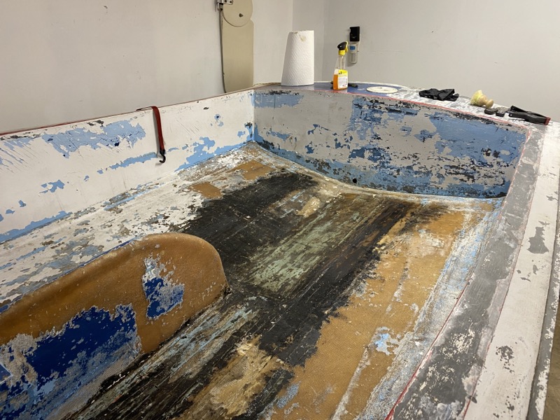

I pressure washed the cockpit, which removed most of the paint. Looks like the PO may have tried to fix some leaking by coating the bottom with 4200? At least is is not 5200. It does budge with some muscle from a scraper.
I have to believe the lack of stringers and/or bonded seats have caused significant flexing that has caused prior leaks. This may explain the goop on the centerboard truck. I also found a lot of silicone which I am sure did very little to stop leaks. The way I see it, the only fix is to completely remove everything to the bare glass and add synthetic coring to provide some structure. Then also add some layers of glass to the centerboard trunk. Not a cheap or easy fix, but still doable. To your point, Green Lake, at least nothing is in my way.
I was actually kind of encouraged I was able to get down to seemingly viable fiberglass (scroll to the bottom of the picture). Still a lot of stripping to do before I can consider coring it, but I really only spent an hour or so with the pressure washer, no sanding or grinding yet. I think I would need to suspend the boat off of the trailer to get the hull in the proper shape for coring.
I read the thread on coring you suggested.
Initial Pressure Wash.JPG (163.63 KiB) Viewed 16655 times

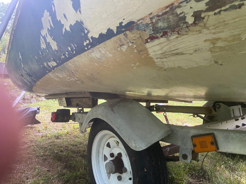

In this picture it shows the lack of tone in the hull sitting on the pads. We can also see on the right, which has no paint, what looks to be the original gel coat with some longitudinal cracking, probably from flexing. Looks like maybe the boat was originally white with a maroon waterline stripe. Every inch of this boat requires some love.
On another note, the mast jack, it looks like it is a big screw. Is there a tool used to rotate it?
saggy bottom.JPG (109.64 KiB) Viewed 16655 times

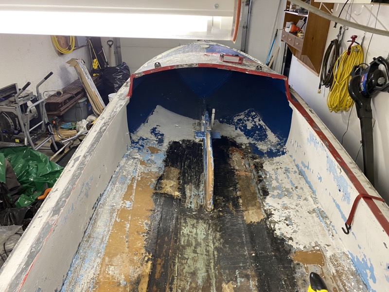

Moved the boat indoors and suspended the stern on pallets and bags of wood pellets to take the load off of the deformed spots in the hull. I can see the boat had stringers at one time but they were removed. I can only guess why.
The boat leaks from the aft end of the centerboard trunk despite prior efforts to remedy the issue; glob of epoxy on the underside, silicone, Bondo, and worst of all an eighth of an inch of tar over the inner hull. I think the continued flexing from the lack of stringers has been causing unresolvable leaks.
Anyway the solution is to strip back to bare glass and address the lack of rigidity with some new glass and coring. For now heat gun and scraping of paint and tar is the task. I have removed about 3 lbs of tar already. Next is likely Goo Gone and acetone prior to sanding. I will also probably use Citri Strip for the remaining paint.
I will post some pics once I get them resized.

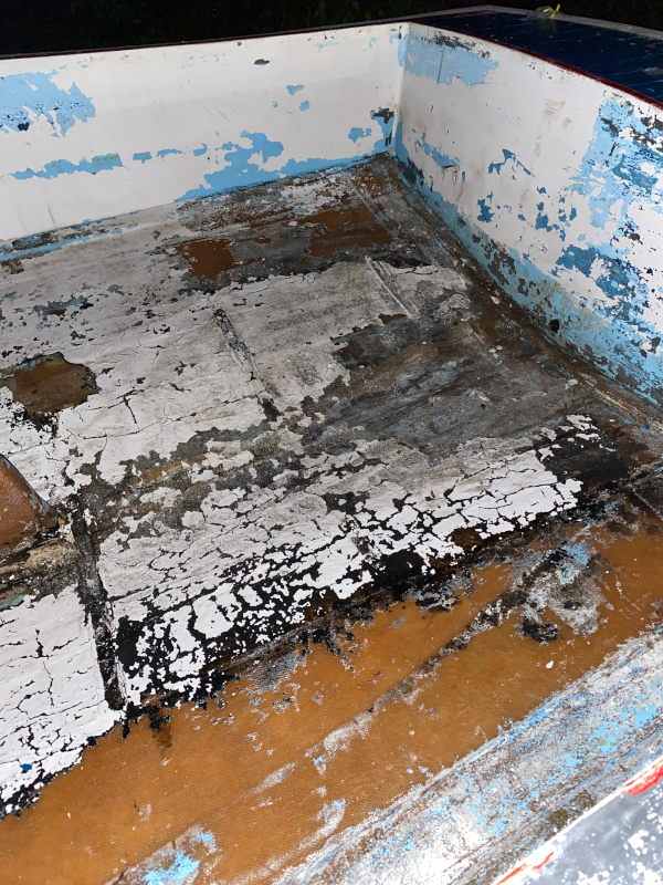

Inner hull

Stern

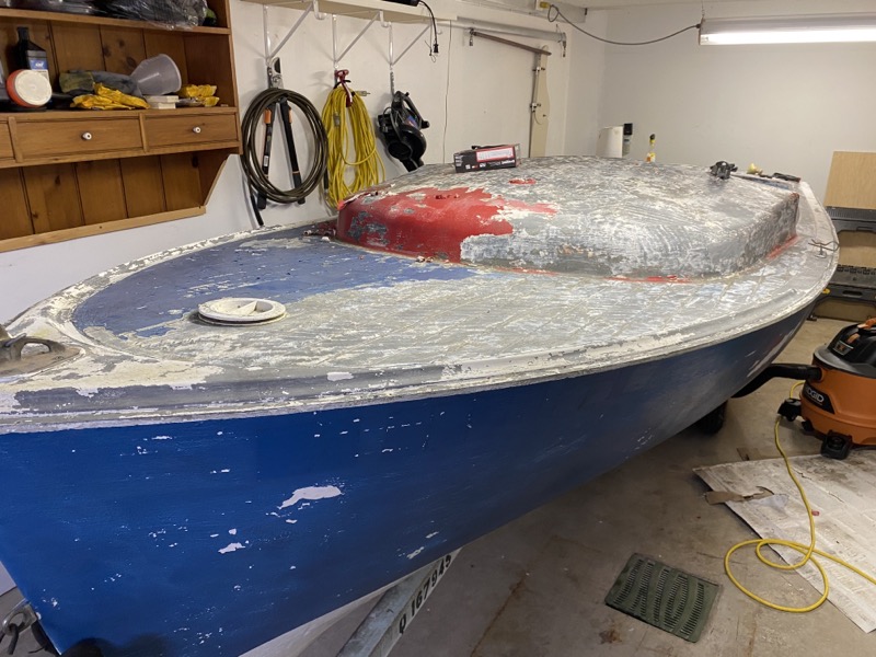

Bow
