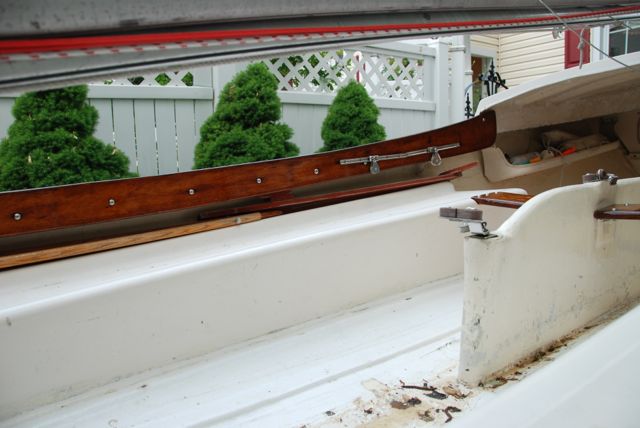

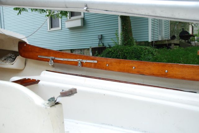

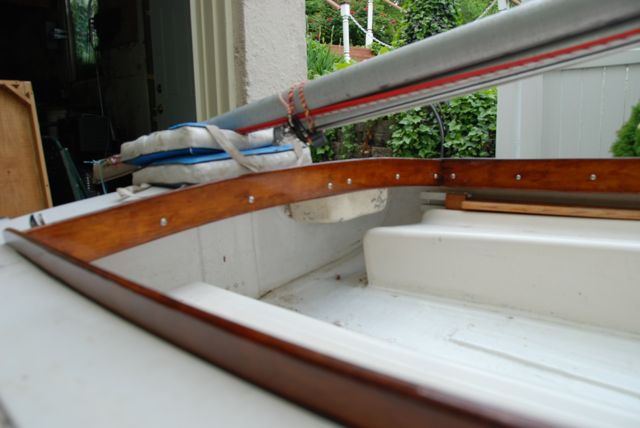

Postby seandwyer » Fri May 17, 2013 3:33 pm
Hi Guys,
I wanted to check back in and let you know that the project is pretty much over, and pretty much successful. I stripped, stained, epoxied, and varnished everything and reinstalled with all new stainless hardware because so many of the screws had their heads stripped out. Also, I epoxied on blocks to the ends of the thwarts to take up the space I had--if you will remember, there was way to much gap. Everything has been tightened up now. My only concern is in how soft the varnish seems to be. I feel like it scratches way too easy. Any thoughts on that?
I'm posting pictures here, too.
Sean

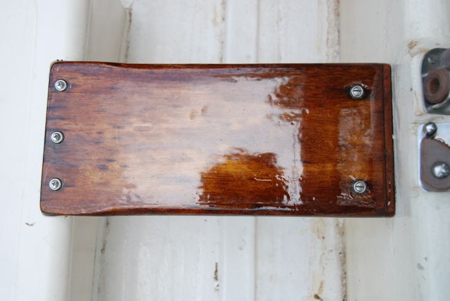

Postby seandwyer » Fri May 17, 2013 3:34 pm
and here'es a picture of a thwart showing the blocking on the centerboard trunk side.

Re: Refinishing coamings--the fine points
Postby GreenLake » Fri May 17, 2013 3:52 pm
seandwyer wrote:I wanted to check back in and let you know that the project is pretty much over,.... My only concern is in how soft the varnish seems to be. I feel like it scratches way too easy. Any thoughts on that?
Good job! Nice pictures!
I can't be sure because I don't know what you used, but one thing that could be happening is that the varnish will take some time to fully harden. Some things do take a bit of time.
Nothing beats LPU for final hardness, that's why I used that on my boat - but it makes it harder to remove any of it should that be needed for touchup. So there is always that for compromise.
Normally, outdoor finishes are more flexible so that they can better withstand the moisture and thermal expansion of the wood. With epoxy sealed surfaces, that's no longer an issue, so some of that flexibility is wasted, and the tradeoff, which is less scratch resistance is then just a downside, no longer a tradeoff.
First, see whether your varnish hardens up over the next week or so. If not, live with it, and be ready to retouch it as needed. That's all I can think of right now.
