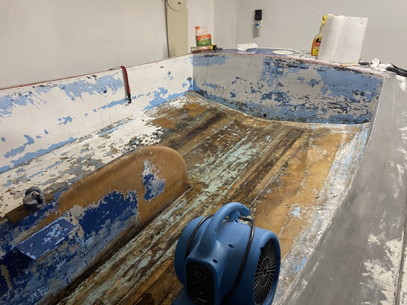

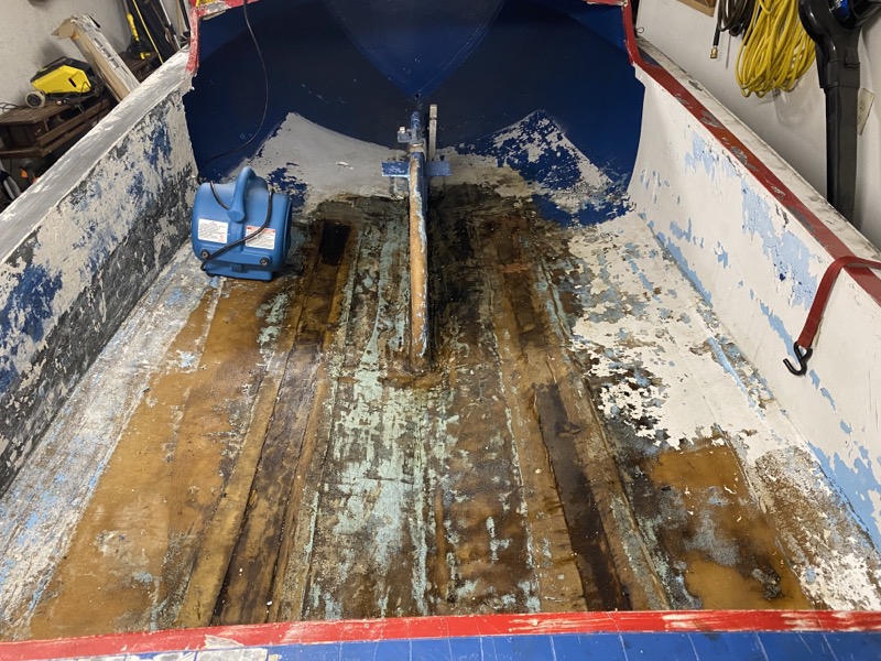

2 bottles of Goo Gone, a wire brush, two rolls of paper towels, and a scrapper.
Not perfect, but good enough to be able to sand it in next phase without fouling the sandpaper.
I also did a first stripping (Citistrip) of the port side gunwale. From old paint I can see where the seats must have been mounted. Anyone have any idea of the depth of the seats? I did a little research recently and I am considering using Iroko wood (African Teak) for the replacement wood for the seats and coamings. It is a quarter the price of teak and it seems I can get it in much wider board widths. Farmed teak is pretty stingy on width as the trees get harvested young. I know the original's were probably mahogany per the forum, but Iroko might be better option rot wise.
looking aft
towards the bow

Thank you gentlemen. Lots to think about. I appreciate the measurements for the seats. I get what you are saying about the variable width, Tomodda.
I just started a new job so the attention I can give to the boat is going to be a little less than I would like, however, I have the whole winter to tackle the project.
I just bought the HEPA bag and filter set-up for my Rigid shop vacuum which I will hook up to my sanders. I read a nightmare story of this guy grinding away at his boat in his garage and the ventilation system sent fiberglass all through his house. Yikes!
Lucky for me I don't have forced hot air and the lower garage can be closed off while I am working. Still, I want to limit the amount of glass I get airborne. Planning one wearing a respirator too. I think I should be OK as long as I am careful. Safety first, right.
