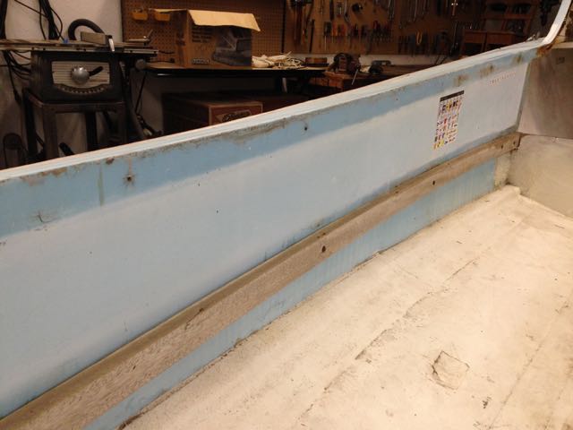

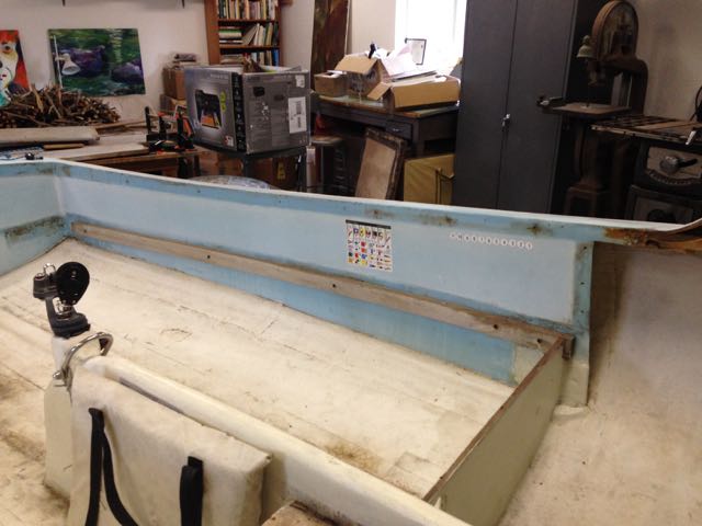

Hi again. I've gotten the bench seats, thwarts, and coamings all stripped, and I am in the process of sanding in preparation for refinishing. In going the epoxy envelope route, I will probably go with System Three, as it is available within 90 minutes of my rather remote location (MAS is six hours away, near SF). GreenLake, you mentioned using one quart of resin, along with the required hardener, was a little more than enough to do your coamings and thwarts. But with the addtion of my two bench seats, I would assume I will need more. Do you think two quarts will suffice?
Unfortunately, one of my bench seats split completely down its length during the stripping/sanding process. It is a clean, bevel-type split that fits back together perfectly, so I plan to epoxy both pieces together before I do the finish sanding and refinishing.
Getting back to my previous question about how the "shelves" the outboard and aft edges of my bench seats rest on are mounted on wall of the side floatation tanks (just through the FG, or that and into a wood backing or carlin of some sort), I am uploading some pictures:

I am not sure how any sort of backing carlin could have been installed during manufacture in this tank, so I am thinking the mounting screws just go through the FG wall, but I would welcome any insights/advice about this. Several of the original brass screws have sheared and I want to make sure these "shelves" are solid before reinstalling the seats.

On whether there is any wood backing the screws. My money is on yes. It's not that hard for a builder to glue a strip of wood in the right position before enclosing the tank. The fiberglass really doesn't do a good job of directly holding screws (other than for non structural trim pieces). I don't know what the proper name for such a strip would be, because unlike the carlins (wood pieced behind the coamings placed at the edge of the cockpit opening, these strips aren't part of traditional wooden hull layout. For example, I don't know if they'd be called stringers if they aren't part of the outer hull.
If you take off the wooden strips shown in your top image you should be able to probe the holes and verify whether they have a backing piece behind them. (If you hear a "thunk" when you pull the last screw, it's time for inspection ports ;) -- I do think that they would have glued in any backing strips). Actually, fitting some large diameter 8" if you can fit that much, otherwise 6", would be something I'd recommend anyway. You would be able to view the condition inside the tanks and fill them with soda bottles, pool noodles etc. which act as backup in case the tanks spring a leak. Should your tanks have foam, it would be a good idea to remove. If it's not waterlogged already, it will be when there's the smallest leak.
Also, in your top picture, if there's a carlin behind the coamings you should be able to probe that easily and also get an idea about how firm the wood is -- a few posts above we were discussing how to restore these with epoxy. With inspection ports you'd be able to make sure that neither carlins or backing strips have been attacked by dry rot -- on my boat, there's at least one crumbly section, so the next time the coamings come off I may be looking at replacing some of all of them.

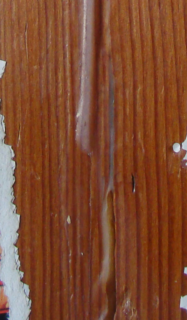

To give you an idea, I found a messy sample I had lying around and took a picture. In the top half, you can see a raised ridge, that one does look very strongly milky as the light hits it. In the bottom half (you may have to scroll) you can see a gaping joint, part of it is filled, and part of it is only partially filled. The effect in one case a bit like tapioca, in the other you can see a bit of the amber coloring surviving. (Image is magnified at least 200%).
Over the entire surface there's a thin, but still substantial film of GelMagic of varying thickness, and you can see it's hard to impossible to tell it's there in the picture. It's just not opaque enough to show up in very thin to medium thin layers -- once you add some layer of ClearCoat and whatever varnish you are using, I predict any accidental thin layer of GelMagic will be invisible.
GelMagic on soft wood. Magnified. For scale note the wood grain.
