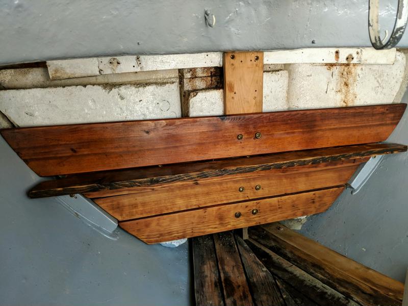

I finally refinished my forward bulkhead planks and put them up. Was halfway thru when I remembered that I wanted to show y'all a close-up of the foam blocks filling the forepeak:
Styrofoam

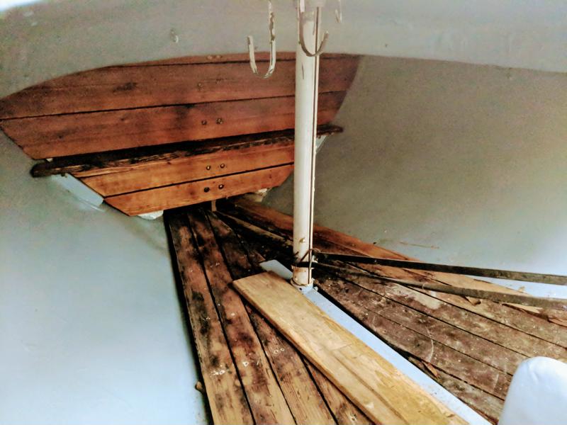

These are just big styrofoam blocks, cut to fit (more or less) and held in place by planking. There are three "cleats" glassed onto the interior for holding the planks in place - the white one under the deck, for a vertical center plank, and the two grey cleats in the bilges for holding a crosswise-plank, right below the shelf. Everything else screws to those. No attachments to the styrofoam itself, those just sit there. Here's the finished product, it was getting late/dark so I boosted the photo exposure, don't take these colors literally:
Forward Bulkhead 1957
For what it's worth, my floorboards are original and just this side of unsalvageable. I gave them a quick once-over with the orbital sander, will think about repairing, rebuilding, or replacing over the winter. Depends on my tolerance for actual work (very low, let me tell you!). We shall see.
P.S. Yes, GreenLake, those "cleats" might be "stringers," especially the one under the deck which is long enough to be a structural reinforcement rather than merely there to hold the center plank.

Something molded into the boat. Apparently wood that's been glassed onto the inside of the hull. My DS1 (from 1957) has a forward bulkhead made of wood planks, covering the foam flotation blocks. These planks screw into "stringers" along the hull and under the foredeck, you can see those in the photos up above, they are painted grey.

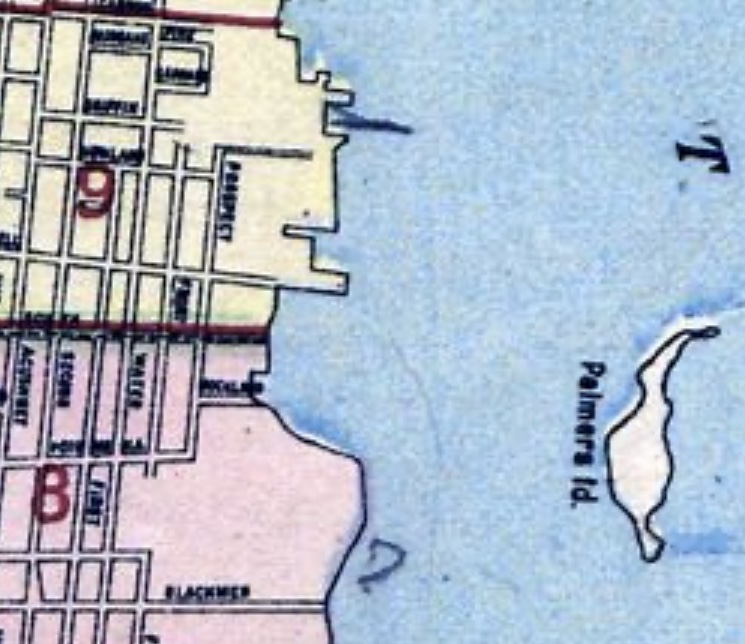

I was able to locate a Prospect St. Could this be where you are talking about. 56 would’ve been on the first full block at the north of the street.

Great find! You're absolutely right, there was a Prospect St in New Bedford up until 1967-68, when the whole area was redeveloped and Mass Rt 18 (JFK Expressway) was pushed through there. No wonder the folks at R&W Rope didn't remember the street at all, been gone for over 50 years. I have to admit that amateur historical sleuthing is one of my favorite hobbies, especially about early American industries. Following your lead of looking at the Library of Congress maps, I think I actually found a photo of the building that housed Whaling City Marine Co. The company itself was bought out by Schaefer Marine in 1967. So for all of us who use Schaefer parts (I do, when i can find it cheaply), we are indirectly touching back onto original O'Day heritage. But we're getting way off topic here (DS1 Design changes), so I'll post what I've got over to the history section of this forum. When I got a handy round tuit available, of course... hopefully later tonight.
