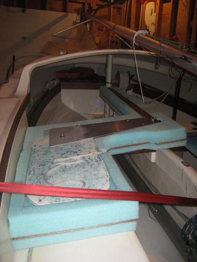

Postby kokko » Mon May 05, 2014 9:07 pm
Found this pic in the gallery. You can see the inspection ports
gallery/image.php?album_id=135&image_id=1752

Re: Drain Plug?
Postby kokko » Mon May 05, 2014 9:11 pm
Nothing to it. I used the port to inscribe a circle, which I cut out with a dremel. My foam flotation was severely waterlogged so I replaced it with swim noodles. Others have collected a mountain of liter soda bottles.
