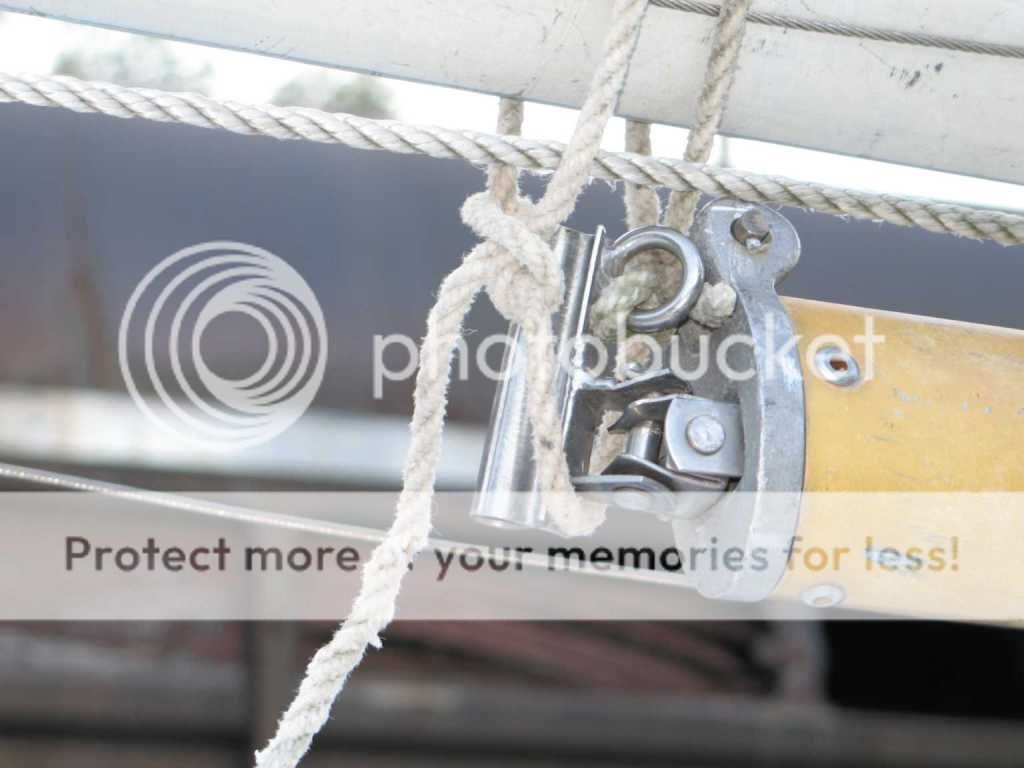

From your description of how the attaches to the mast it sounds like the goose neck might be broken. You state that the boom end has a square opening that you put over a square peg with a universal joint on the mast. the whole assembly should be attached to the boom to slide the assembly into the mast slot. Attached is a picture of what the end of the boom should look like. The ring is on the bottom when the boom is on the mast.
Here is a the complete gooseneck part from D&R Marine http://www.drmarine.com/proddetail.asp?prod=DR116

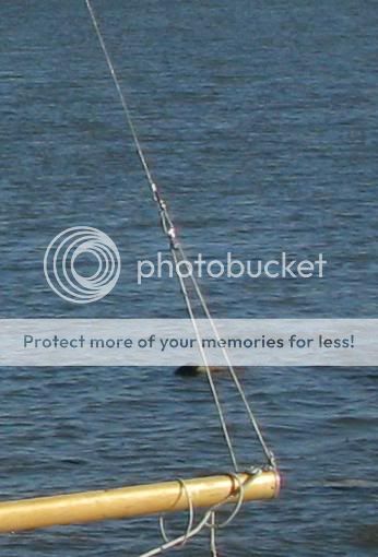

As far as keeping the boom up on the end, you need to make a topping lift. I made mine by attaching a small cable to the mast head and running it down to the end of the boom where I attached a small block and some line to adjust the boom height.
Postby navahoIII » Fri Sep 07, 2012 12:02 pm
John,
Our DS1 has the same gooseneck fitting that's in your photo, and the "ring" [b]should be "on the bottom when the boom is on the mast" because, of course, it's the downhaul!
I bet you have 'roller furling' (as we do) and just happen to have turned the gooseneck 'upside-down' in the photo...right?

Postby jeadstx » Fri Sep 07, 2012 1:49 pm
The ring is upside down in the photo because the boom is tied to the mast for trailering. That's why I mentioned that when the boom is on the mast the ring is down. Sorry for any confusion, it was my only picture of the gooseneck.
I do have roller reefing which I do not use. I use jiffy reefing instead.
In Triathjohn's post he mentioned a square opening in the end of the boom and putting it on a square fitting attached to a toogle on the mast. Even if the boom does not have roller reefing, the whole assembly should be attached to the boom, not attached to the mast. With the assembly not attached to the boom, the boom will slide out of place if the sails are not up to hold it somewhat in place.
Postby navahoIII » Fri Sep 07, 2012 3:37 pm
Yes, I see that the ring is upside down -- but the boom isn't! My point is that the goosneck and ring must have been turned as one would to do a roll reef because it's on the same side of the boom as the pin on the end-cap that secures the tack when bending on the mainsail. Normally, that pin is on top of the boom (as in the picture) and the ring is on the bottom. Again, in the picture the boom is NOT upside down.
Sorry for going off topic.

Postby GreenLake » Fri Sep 07, 2012 3:57 pm
It's easy to give the gooseneck an accidental twist when it's one that allows rotating the boom for roll reefing. I'm sure that's what happened on the day John took the picture.
Postby jeadstx » Fri Sep 07, 2012 4:43 pm
Had to look at my picture again, noticed what your looking at. Just got it twisted like GreenLake said when I tied it to the mast for trailering. When the boom attaches to the mast the downhaul ring and line are in the right place. Now I'm going to have to take a new picture to replace that one.
