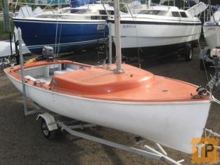

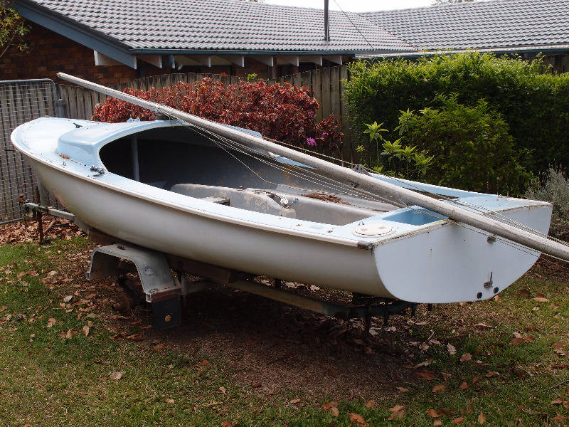

I had not realised just how rare the Australian Daysailers are . I include a picture of my own , purchased recently from Peter and another one that I spotted in July2009 on the (Australian) Trading Post website . I wondered whether the TP one was the basis for Brad's boat .

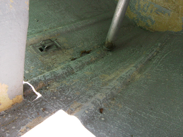

I cannot find any numbers inside the hull of my own . Mine has a steel centreboard (centerboard) , it has an aluminium mast support bolted to the mast foot under the cabin roof . The bottom of the support sits on a semicircular section of glassfibre . I note that this glass re-enforcing is different to other DS1's that I have seen . The sails with the boat were made locally by Geo Manders a sailmaker from Brisbane , Australia .
Interestingly s/s fittings on the boat are marked with Fico and Ronstan Australia brands . The implication here is either a re-fit or , manufacture here in Australia .
Hopefully the history of Aussie daysailers may be discovered.
Mast support base detail Australian DS1
Daysailer graham5494.jpg (141.67 KiB) Viewed 21964 times
Brisbane bought from Peter
Brown / orange deck from Australian Trading Post site July 2009
July 2009 TP.jpg (17.28 KiB) Viewed 21964 times

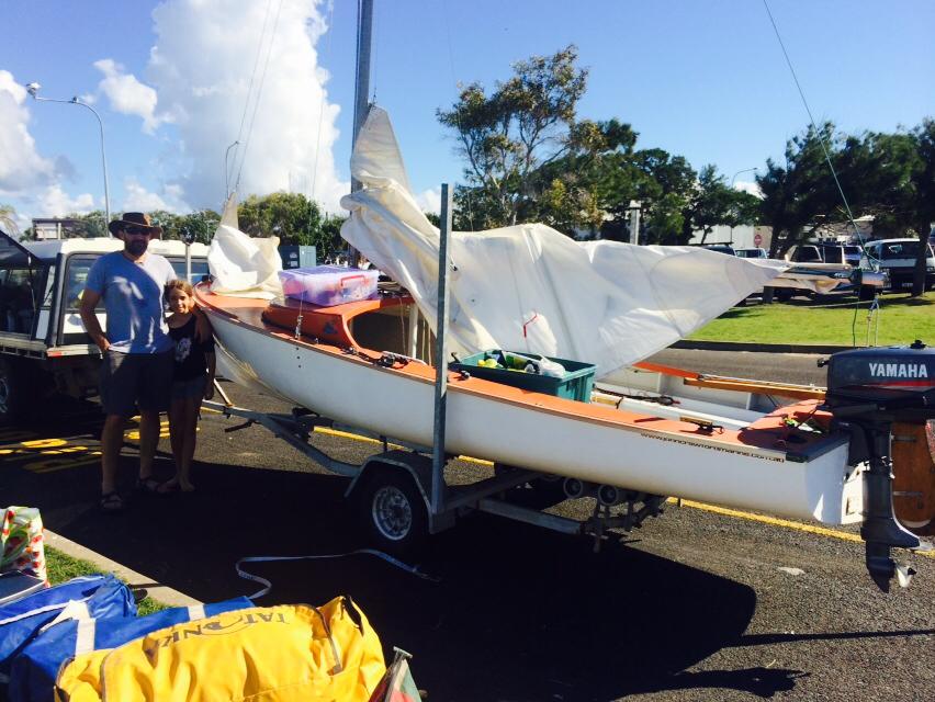

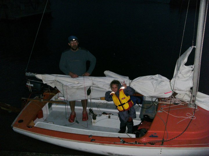

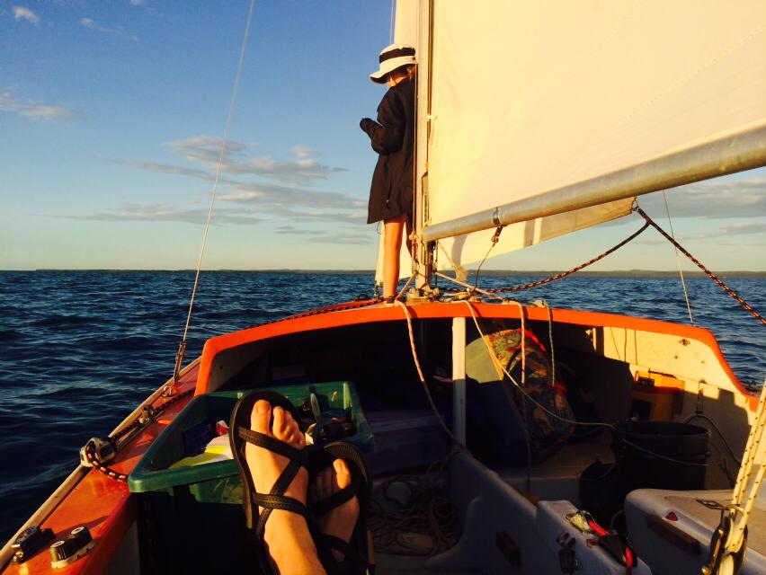

Hi Brad, i now own that orange DS1. Purchased it around the time of that picture from John Crawford Marine, Tingalpa (Brisbane). I sail it mainly around Moreton Bay with my kids (usually 3-4 day stints) and have ventured up to Fraser a couple of times. I'm actually planning do some sailing up north around the Whitsundays pretty soon. The boat has a steel centreboard and i am just in the process of rigging up the spinnaker. I have made a boom tent for it and two bunks out of ply that stow up the front when not in use.

Nice boat. Your DS1 looks a lot different then then one I have (next up for a restoration). You say you go out with your kids for 2 to 3 day stints? Would that be sail camping? Sounds like fun. Hoping to try that around here but it's pretty populated in the NY area. And my kids are grown.
My DS1 has the vee hull shape into the bow with a bulkhead near the front with 2 small access hatches. The front of the centerboard tunnel has wooden boards like an extension of the seat supporting lateral loads from the centerboard, through the CB tunnel and into the seat. Around the rail is a wooden back rest. Your looks so cleaner.
I wonder if you have a DS-III?

actually im not really sure if its a DS1,2 or 3. I have had a look around and can see that DS1's do not have a closed in cuddy whereas the DS2 and 3 appear to have partly closed in cuddy's? this is why i assume mine is a DS1...

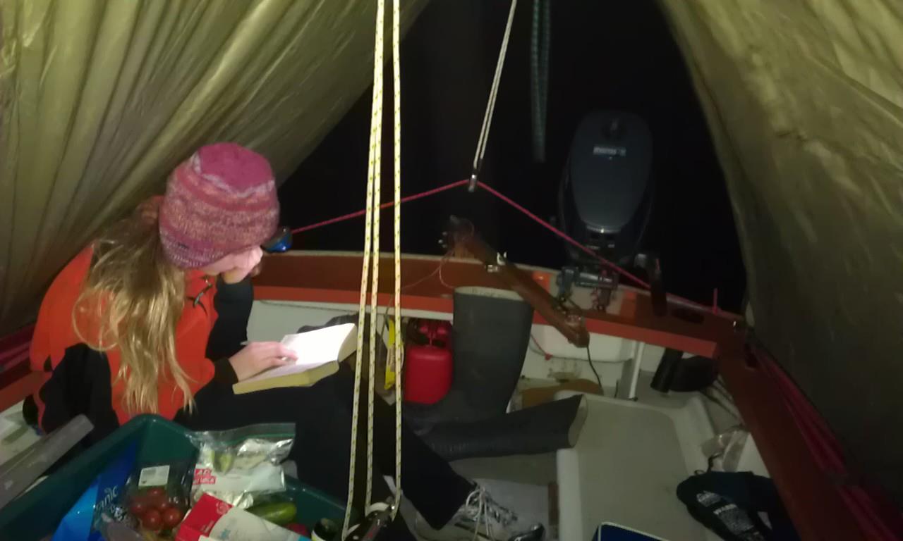

yes it is camping and we sleep on board. i will get a pic of the bunk panels next time i have them up but have included a pic of what it looks like under the boom tent (without the bunks set-up). I have never been over to NY but through google earth it looks like there is plenty of awesome sailing up on the lakes to the northwest or even the water body to the east! is it New jersey Harbor?

On second look, it looks like you have a nicely modified DS1. Not that I'm anything close to an expert. I haven't even sailed mine yet! But I have 2 of them. Yours has a raised flat floor and a higher raised floor in the cuddy. My DS1 does not. It has only minimal floatation and there is no raised floor at all. You also have cutouts and blocking for wood bracing notched into the seats like my DS1.

In the picture with the young lady reading by a headlamp, I think I see that the block on your Crosby rig going to your mainsheet is not knotted.
Is it free? And if it is, how do you bring it to the centerline when you're close hauled?

Solarwinds yes the main does at the moment run free and the only way to bring it to the middle (or close to the middle) is to pull down hard on the main sheet. Funny you mention that, and this is mainly why i recently found the DS forum. I was looking up how to rig one of these boats - found info here https://www.daysailer.org/Rigging-Guide. I was a little concerned with windward performance so when i fix the problem you mention i hope it is better... Another thing i have been struggling with and which has also prevented good windward performance (i think) is the position of the blocks where the jib sheets are cleated to the deck. they appear to be too far out to the side and on other DS's that i have seen in this forum have the block positioned in further on the seat back. Rather than moving the current jib blocks i am going to try a technique i discovered on the rigging guide using "barber in-hauler". I hope this will help improve the windward performance. You can see the current jib sheet blocks are close to the outside edge of the boat in the pic...

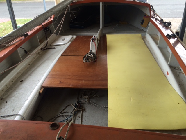

I have included a pick of the plywood bunks i have made for your interest. There are three boards that i use for comfortable sleeping. Two go either side of the centreboard housing and one straddles the gap across the seats aft of the centreboard housing. They are held in place by small timber lugs glued just below top of the seat to make the board and seat flush. I actually made a fourth to cover the cap even further back but have found that it is not needed. I use a swag (canvas bivvy bag) that has mosquito protection if needed which it generally is where i live in the sub-tropics.
IMG_4624 (1).JPG (97.57 KiB) Viewed 19716 times

Thanks for the pic, Damian, I have to get to work on that project, even if I never overnite, I could take a serious nap.
