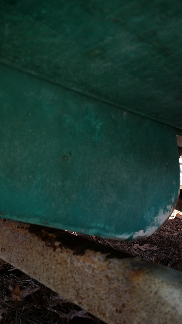

CB hangs 8"

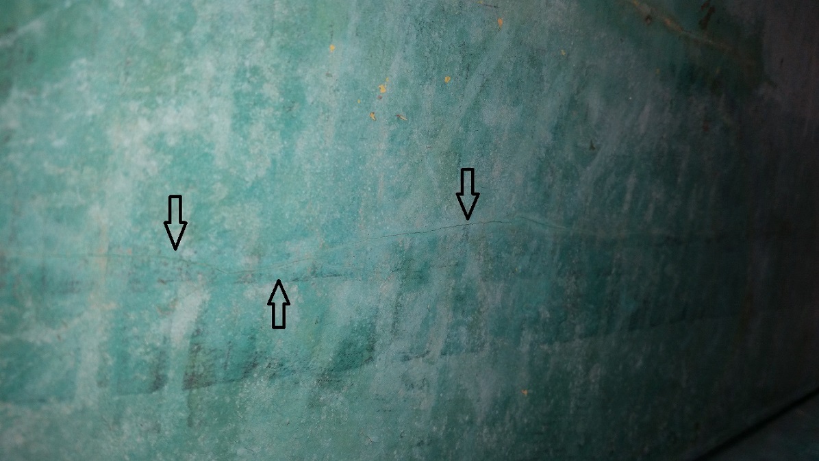

Port side gel coat crack
Starboard side gel coat crack.

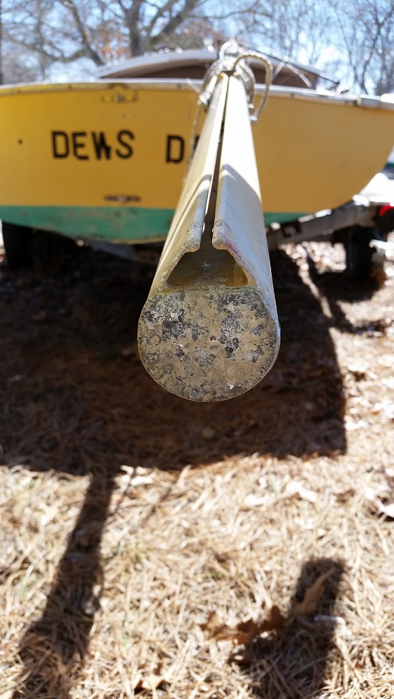

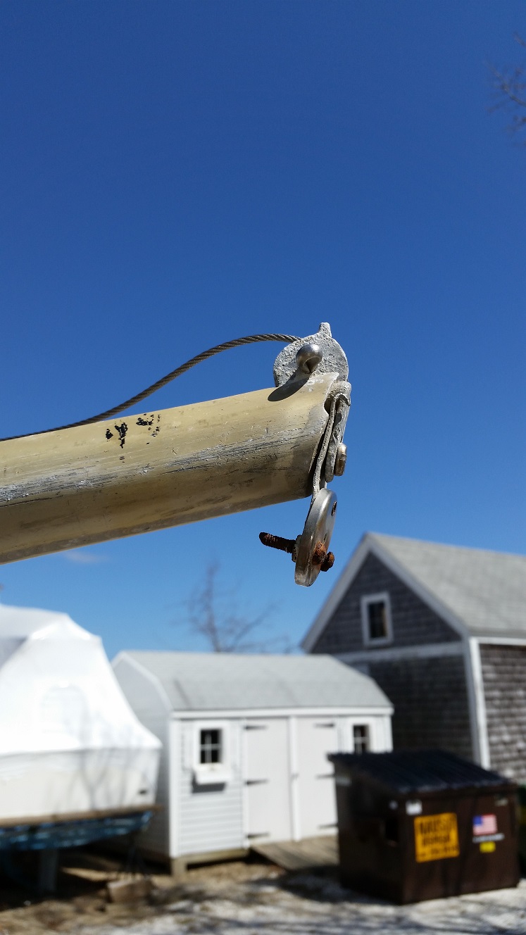

Here are pics of mast
Goose neck
Masthead

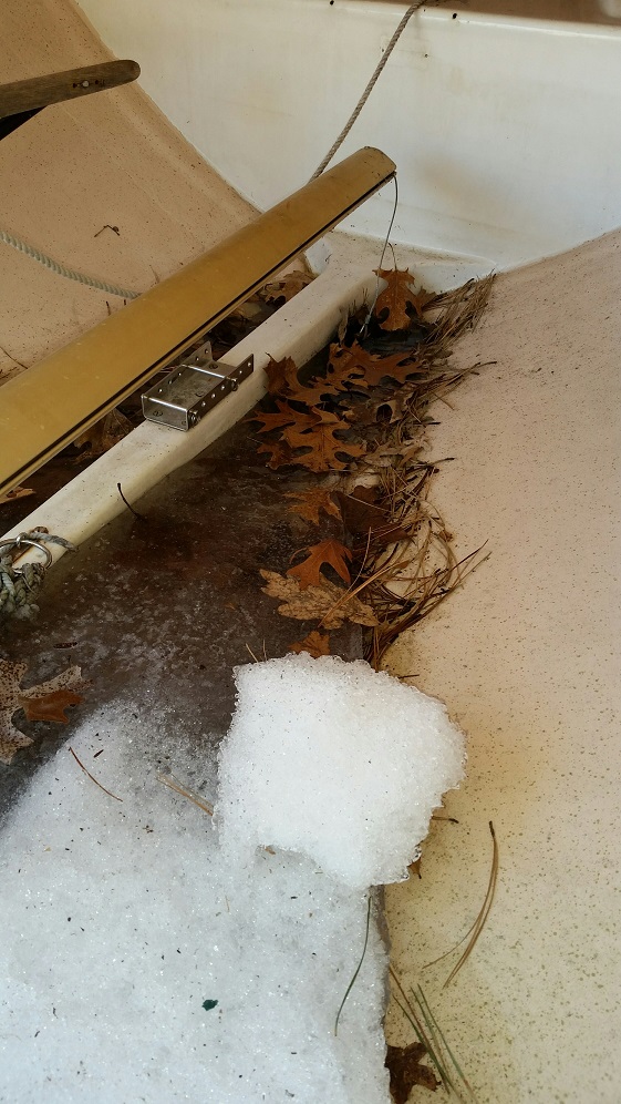

Step seems to be missing

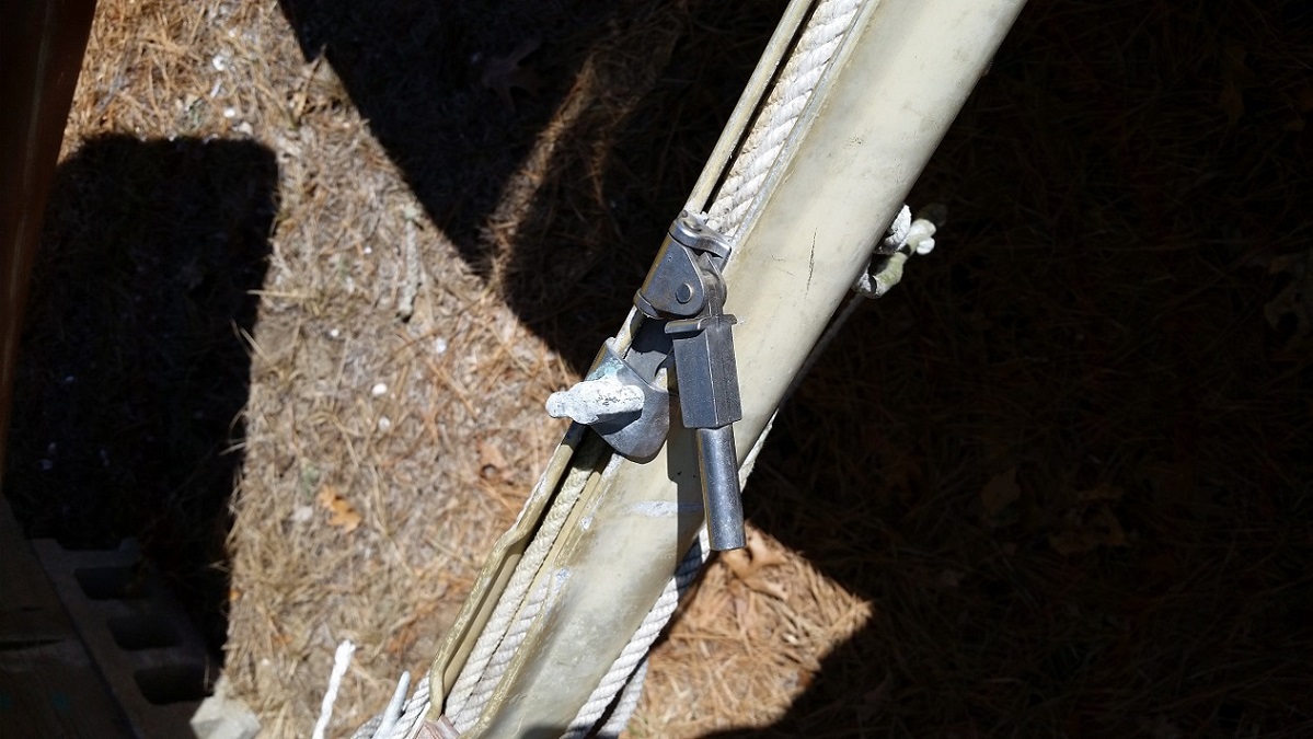

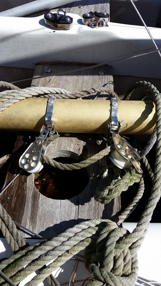

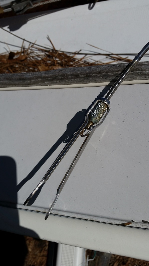

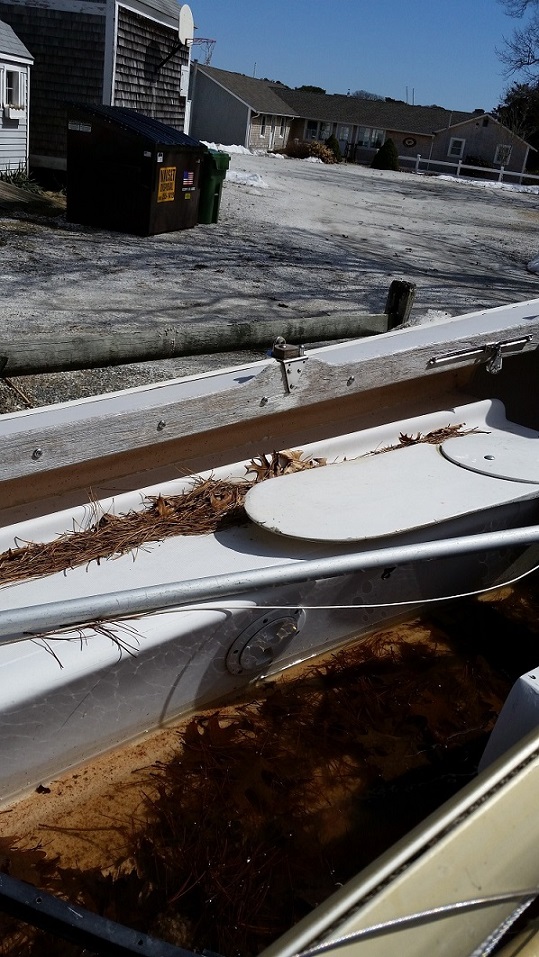

A few more pics, two main sheet blocks on boom? Don't know if there is anything missing from the turnbuckle assembly.
Low comings with cam cleats at center
never saw a turnbuckle like this.
Need help on this one.

Judging by the photographs it appears to be later model O'Day or someone bought and installed the fiberglass centerboard cap cover with the molded-in Jib Sheet Cleat mounts?
Double blocks on the boom would be for a mid-boom traveler but I don't see a traveler in the photographs so maybe it came off of another DS?
Tapered gold Proctor appears to be in good overall shape for its age and the SS Gooseneck is a Proctor.
The shroud or forestay in the photograph is missing the SS Pin to attach it to the chainplate or forestay plate but I would recommend replacing both shrouds & forestay if you buy the boat as that is probably original.
The galvanized trailer looks good from the one photograph from astern.
Keep in mind that you're looking to buy an inexpensive 40-50 years old mass produced one design dinghy and most if not all of the cracks in the fiberglass are probably stress cracks from sitting outside all of its life in extreme conditions and are not structural except for possibly the fiberglass tanks taped to the interior of the hull being popped off from the water in the bilge and tanks freezing, thawing, freezing,.....! Mike

Postby xraydude » Wed Apr 01, 2015 2:26 pm
Thanks Mike,
There is a traveler sitting on the floor (not attached to the boat), and a spinnaker pole. Is the stainless steel pin you're referring to a clevis pin? The mast is straight along with the spreaders, do you know what the round disk at the masthead would be used for? There is a mast step on the keelson (Attached Picture), does the mast just fit between the pins?
Thanks again for your help.

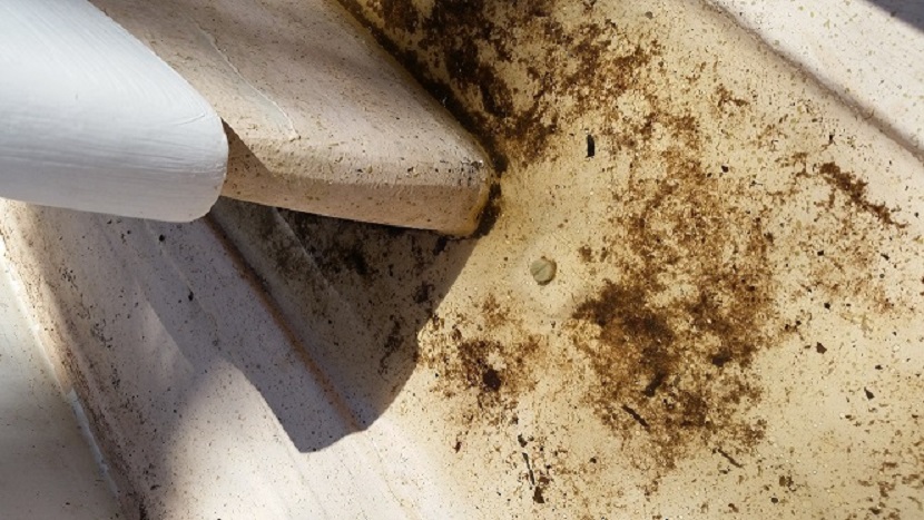

Postby xraydude » Sat Apr 11, 2015 1:53 pm
Brought the boat home last night, and now wondering how to remove the little drain plug that sits 2" behind the CB trunk. Tried to turn with a screwdriver then pliers and a screwdriver, and this thing won't budge. It might have been glued from the previous owner. Should I just leave it alone?
