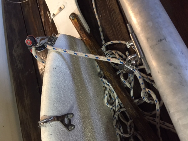

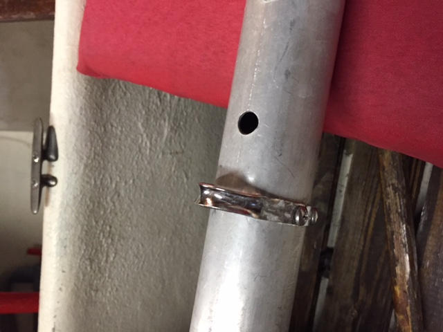

Some photos showing second boom sheet (sort of). Have the boat in my pole barn and the mast down putzin on some stuff. The second sheet they had is one of the photos showing where it hooked up to the boom and the other photo where it hooked up to the CB housing top.

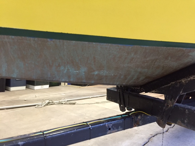

The other photo is the boat bottom which looks copper all the way and is tarnishing like copper--anybody possibly have any idea at all on what the previous owner could have used here?
Crap, wrong picture to show second sheet hook up on CB housing but it's basically about mid CB hgousing location where the original cam cleat is on the bend towards the aft part of the CB housing.

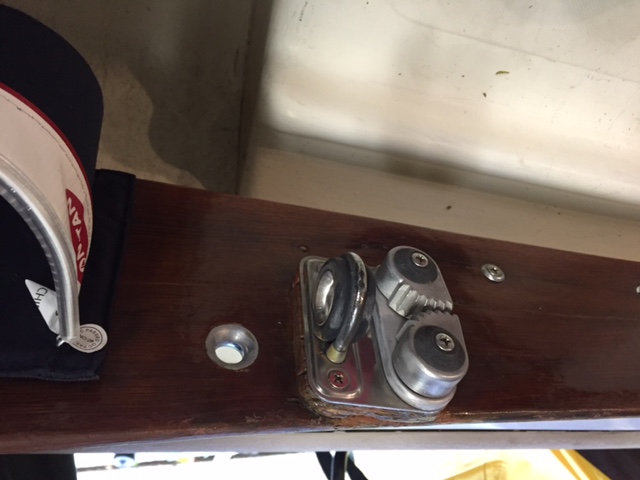

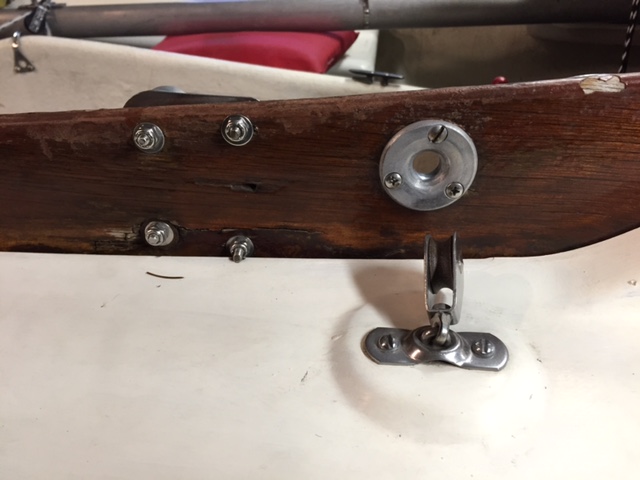

Jib sheet through teak setup--wanted to show everybody what the set up is currently the way I bought it for the jib sheets. Sheet goes through a small block outside of the teak, then through the hole in the teak that you see and then through the cam cleat. Not a bad setup but the cam cleats are way too big for the size of sheets this boat uses. I can see on the inside of the teak where a small traveler once was.
I am pretty sure I am just going to order the JIB CAR set from Rudy and after redoing the teak, add those and get rid of what is on there. I assume the block and hole in teak are original and still needed correct?

It is hard to tell from the picture but my guess is the PO put a second coat of bottom paint of a different color. Some people due that on purpose. It appears to me the copper is worn off in spots and the turquoise is bleeding down a little from the spots where it is exposed.

My 2 cents on question 1. From the description I think what you are seeing as the second mainsheet is actually the boom vang. If it goes from the boom to the mast, lower near the cuddy top then it probably is. Either way I'd leave it out of the picture for now and deal with it later.
Good luck and enjoy the boat, great boat to get back into sailing with.

Looking at your pictures I have the same jib sheet arrangement where it routes through the coaming. Then the line continues straight and the cleats are mounted on the centerboard trunk. I can see where your arrangement would be less than optimal. Two solutions one to remove them and mount on the thwarts, the boards that go from the centerboard to the seats. The other is to route the lines all the way across so you're cleating on the other side, port jib cleats on starboard coaming.
