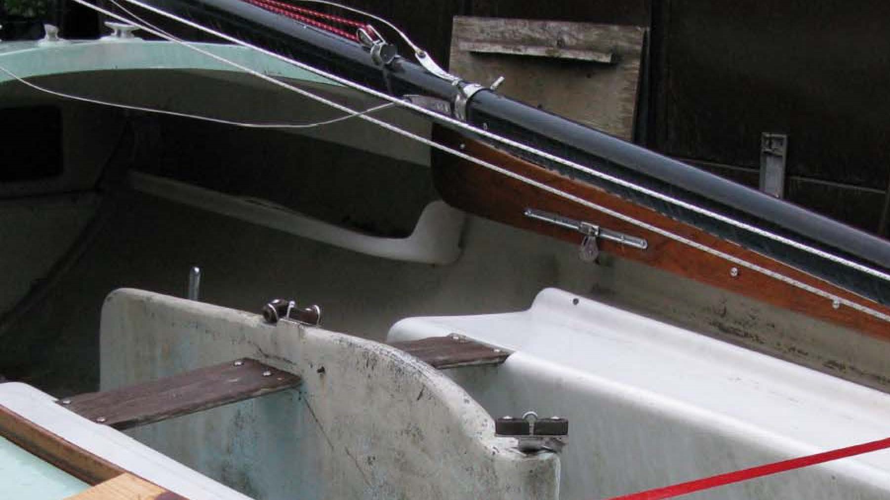

1969 Day Sailer I
1969 Day Sailer I - Jib Setup.jpg (244.71 KiB) Viewed 21430 times

I really, really dislike that setup with the captive jib sheets.
I don't dislike the tracks, that's what I have, and I don't dislike the cleating on top of the CB either. What I dislike is the bullseye in front of the cleats. It makes it impossible to adjust the jib except from the windward side. I find that there are too many occasions when I need to adjust the jib sheets while sitting in some other location. Whether I'm single handing, teaching a newbie, or simply want to heel the boat to leeward in light wind, I end up reaching for the jib sheet close to the track, pull it in, and then bring it in from the top to clear in my (open, non-captive) cleats.
Here are pictures of my setup.
1818
1034
A while ago I decided to tie the ends of the jib sheets together, so that I can grab the sheet anywhere and don't have to worry whether it's the active or the lazy sheet. Originally, I did that for single handing, but I liked that setup so much that it's now "standard".

Well, I posted a picture of the bracket I had a local shop manufacture for me from SS.
You can see where it is held to the CB by bolts that go across. It turns out that the ended up just a bit below the "roof" of the CB, but there's enough clearance there.
Here's the picture again (you can click on it to view it better).
1034
The cleats are held with bolts to the bracket - they are not bolted into the CB. This required a bit of a stand-off to have room to fit the nuts. However, the top of my CB was raised in that area, probably as a result of having provided the kind of angled support you can see in John's picture. These had been ground off (partially) by a PO. I ended up drilling some shallow holes of wide diameter to allow more room for the nyloc nuts for the cleats.
