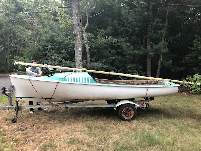

Just picked her up for a whopping $400. She's in decent structural condition. Just need to knock the ugly off her. The plans for this fall/winter are to sand and repaint the hull. Also, Paint the deck and cabin. Also, the woodwork could use some love. The standing rigging is all great. The running rigging is a mixed bag. I'll likely be replacing all of it. Lastly, it has the original floorboards that are in rough condition. I'll be replacing them if I can find someone to make me a new set. I'm ok with refinishing woodwork, but creating new floorboards is beyond my ability. The trailer needs some serious attention also. Picture below.

Looking at you photos, she's in really good shape. Needs paint, obviously. For the coamings, assuming no rot, you should be OK with sanding and a few coats of varnish. Do you have a decent orbital sander? Don't need anything fancy, but a 4" sander will do most of what you are gonna need. I have new floorboards somewhere in my future, seems to me that it's all easy carpentry except the outermost plank, which has one curved edge. Bandsaw it, or farm it out to someone with a good bandsaw. Anyway, a small winter-time project.
In the meantime, go sailing! Nevermind the rust on the trailer, but repack your trailer bearings ASAP.....

I’ve got all the tools I need. The trailer is rough because it has a bad leaf spring. I’ll be redoing the trailer. Luckily the previous owner repacked the bearings recently.
