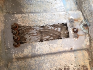

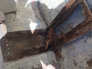

Postby Relentless » Sat Mar 02, 2019 11:37 am
Came off really easy
I cut off and glued new piece of plywood on with west epoxy with structural thickener.
I would have more done but doing work outside and weather here in Tx has been unusually cold and crappy.

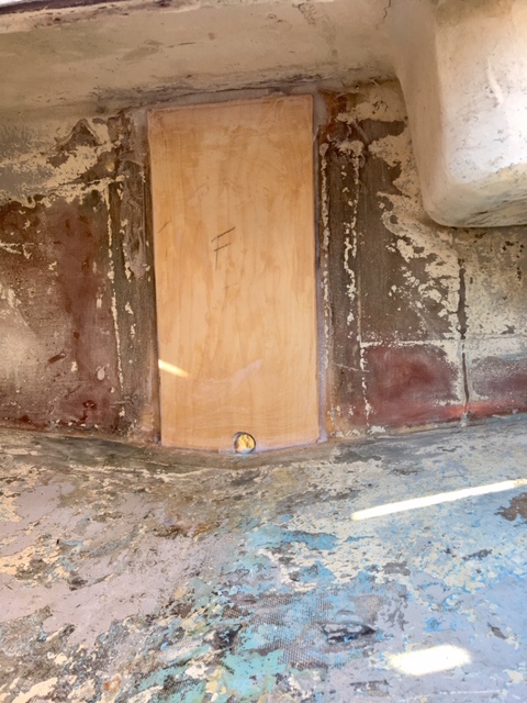

Postby Relentless » Mon Mar 18, 2019 8:45 pm
Ready for fiberglass.
New plywood glued in with west system thickened with structural filler

Postby GreenLake » Mon Mar 18, 2019 9:14 pm
Looking good.
