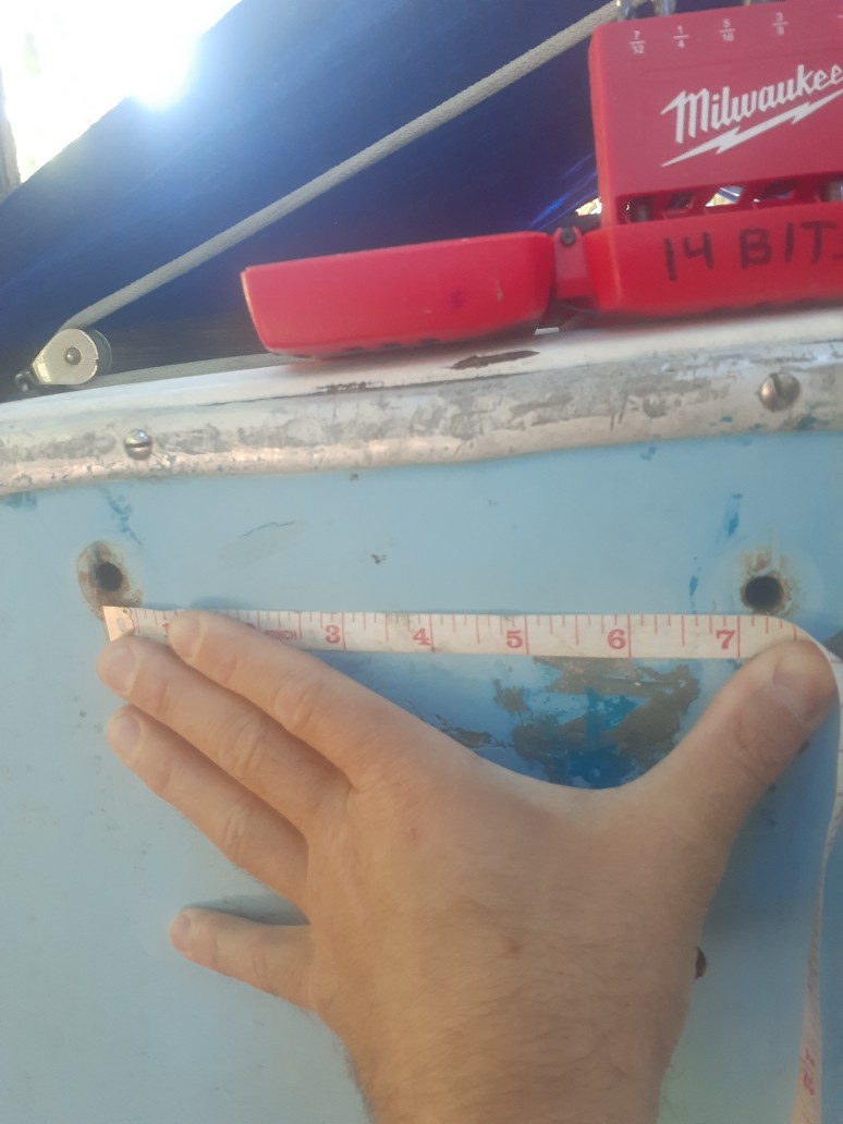

In the mean time I'm building a motor bracket off the transom. I realize this will move weight further back which is not desirable but its for a small electric trolling motor so I"m hoping this will be negligible. I'm planning on running some wire to keep the very heavy lead acid battery near the foot of the mast as has been recommend on this forum. The goal of the bracket is to keep the motor throttle etc away from the running rigging. It has been in the way when the motor was bracketed onto the well.
My question is regarding materials for this project and in up coming projects. The boat had 3 holes drilled though the transom to the well when I acquired it.
20220718_160238 (2).jpg (93.87 KiB) Viewed 23355 times
I may have to drill 2 new whole and plug up one of the existing ones. I imagine i'll need to coat the inner aspect of the holes in epoxy of some kind. I've also seen other folks here mention coating wood they've added to their boats in epoxy.
What products should I be using for coating wood, filling holes, lining holes, and sealing screws for that matter? And where should I look to buy them? (I'm in Portland OR, so some marine and construction stores in the area). If there are good guides elsewhere online for this question that would be helpful. All I'm finding are specific companies advertising their products so its a little hard to sort out.

A good coating on any bolt holes is essential. If there's a gap, between transom and motor well wall, perhaps insert a tube or something and fix with epoxy.

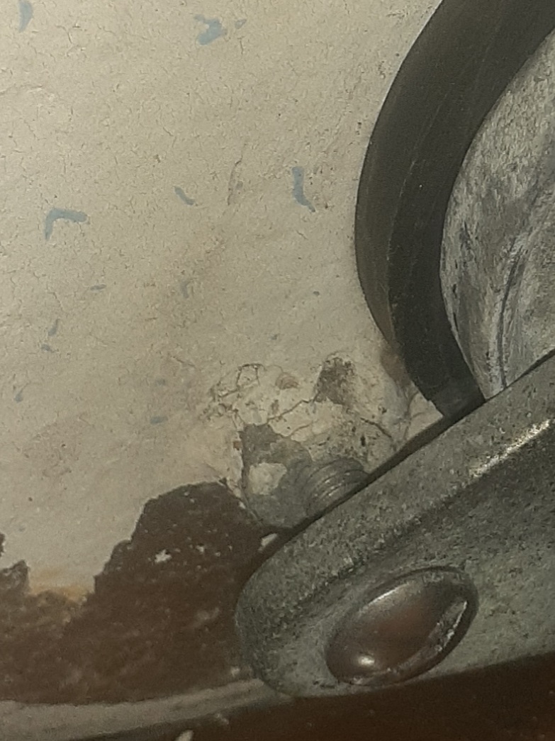

Quick update here, while I'm still waiting for the centerboard gasket to arrive, I got under the boat and was able to get a good photo of the inner starboard aspect of the CB trunk near the handle. There are a number of other problems I discovered but there dont seem to be any cracks there. The only entrance for water is through the handle through hole as far as I can tell. I'll write more after I take it apart and follow up here with my other center board issues. More to come.

OK. Then with some 90% probability the leak at the screw is water finding some alternate route from the hole. Seems more likely that that route is outside rather than between layers of laminate, but water does what it does. Once you got the handle sealed, if that location is the only one still leaking, we can speculate more.
Glad to hear that you don't have a crack in the CB trunk.
