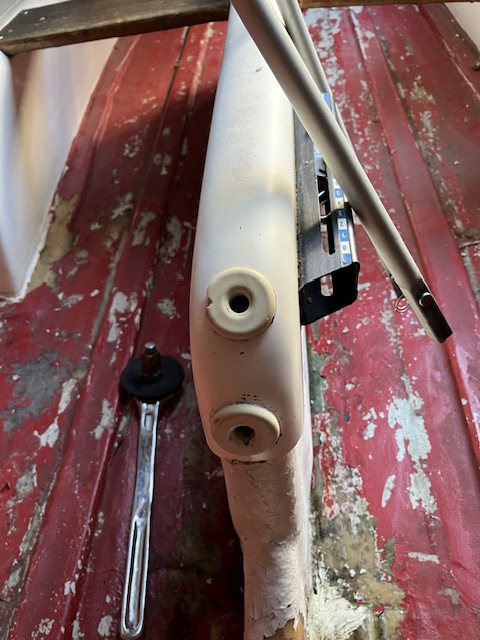

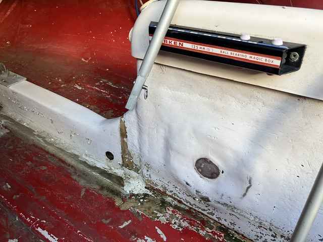

Here are a few views of the cb trunk. I can’t figure out the purpose of the two “ports” on the forward edge of the trunk, but confirmed that they are open to the trunk and I can see daylight Saving brought them when I look up through the CB trunk underneath the boat. No other cracks or gaps apparent around the trunk inside or out. I guess I can plug these until I decide whether to seal them permanently.
The drain hole on the port side of the keelson drained a few quarts after my last outing, and there is some loose styrofoam pellets in there. I assume the foam is from the bow tank and there wasn’t factory foam in the keelson. No hull cracks/breaches are obvious, but I’ll keep looking.

One more view of the ports

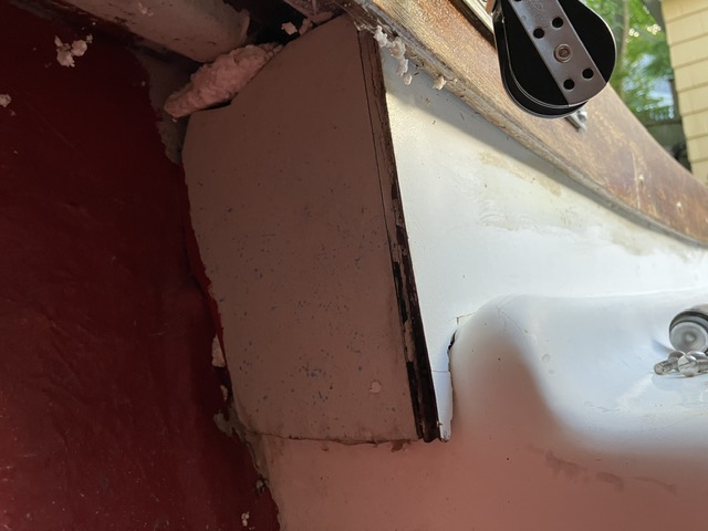

Also, plywood with styrofoam behind it that was built in between the bench and gunwale.

Looks like someone adapted the CB trunk to use the DS2 up/downhaul setup. That's what those two ports are for. If you plug them, that should take care of the water ingress. (Water will positively "jet" out of the forward one at higher boat speeds. You may not have noticed because it points away from you, but it would be expected under normal operations.
If the keelson shares a drain with the forward flotation tank (and they all have 1" drain holes that should have plugs in them) then the water in it came from the standing water in the cockpit.
