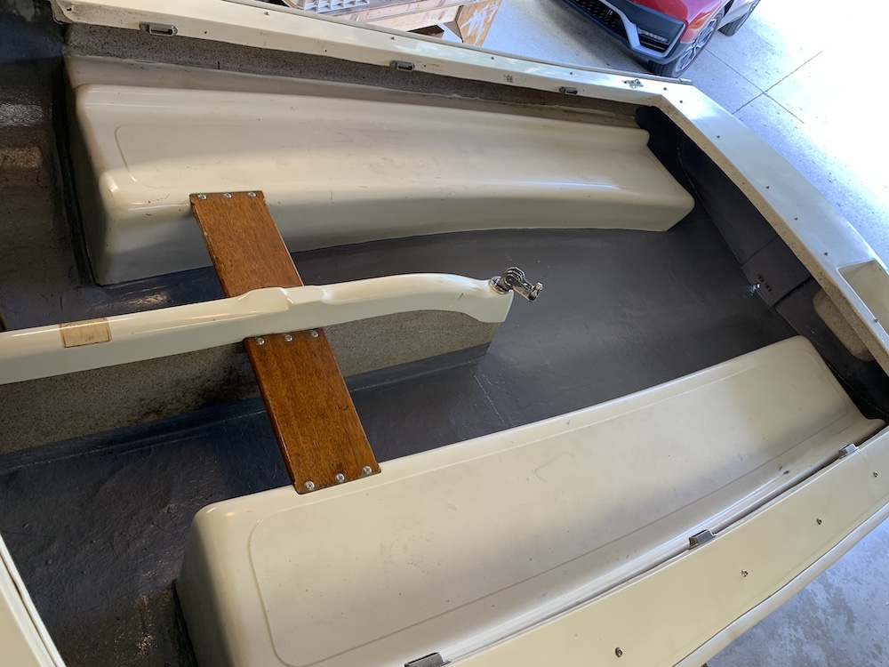

1. As seen in the photos, the bench seats and lower part of the bow appear to be completely sealed against the hull. Is this a means of floatation? Are these spaces hollow or do they contain foam? Should I drill into them to confirm that they are not waterlogged? Should I consider adding more floatation?

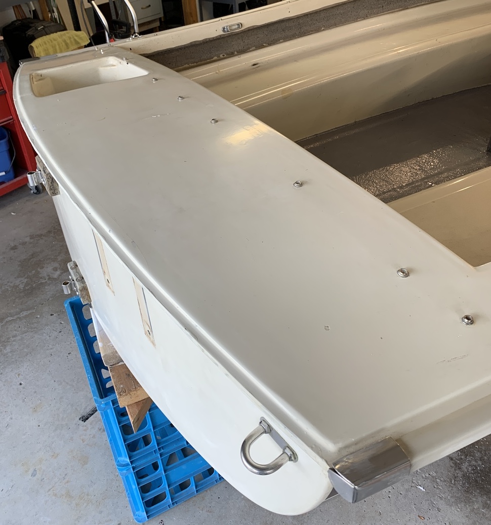

5. The upper lip of the transom looks unfinished (see photo), and I wonder if there isn’t supposed to be a trim piece or rub rail there.
6. What is the purpose of the rectangular well in the transome?

  1. The benches are flotation. You may want to create an inspection port on the forward end. This will allow you to ascertain the state of the flotation and to make upgrades. Use the largest deck plates you can fit. The same goes for the forward tank.

  5. No. Some older boats have a piece of metal trim there. If it looks unfinished to you perhaps a stripe in some contrasting color might do the trick?
  6. The transom well can be used to chill drinks or to mount a small outboard. It has a small drain hole to the outside so you could use it for wet swimsuits as well to keep the cockpit dry.

You need to install inspection plates forward on your floatation tanks to see if the stroform is wet. Mine was wet and I replaced it with new pink stroform. Along with the form up forward under the deck. I also added pool noodles just for more floatation.

The cut out on the rear deck is for an outboard motor I used a 2 1/2 long shaft Yamaha.
There was original piece of metal trim where the rear deck meets the transom.

If you want to confirm you just need to look at the boat and answer this question: is the bottom of the cockpit the same as the inside of the hull or is it a separate piece so that there is a space underneath the cockpit? If the latter there is usually a drain provided at the transom.
Your picture from the inside shows one drain. If seen from the back there's a second drain underneath that one it would proof positive of a double hull.

Thanks, there is just one plug in the transom the drains the cockpit so it’s definitely single hulled.

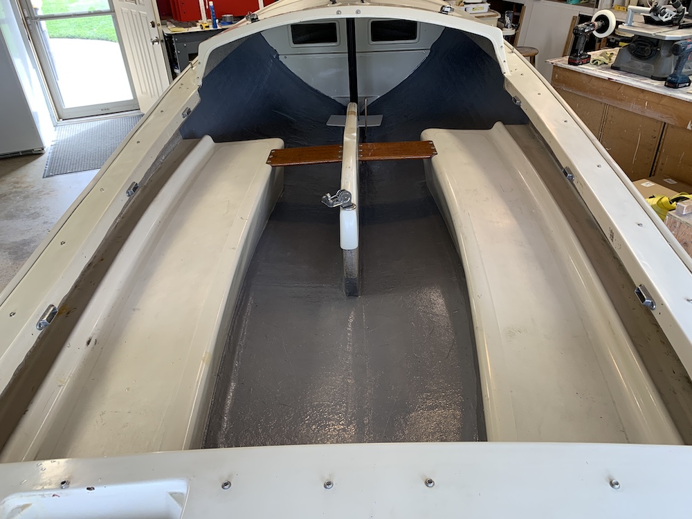

In your pictures, I am confused by the evenly spaced aluminum (?) fittings on the inside of the deck. Any idea what these are? Any close-ups?

Those aluminum fittings attached to the inside of the side deck hold fiberglass bows so you can install a cockpit cover and not use the boom. Just guessing, a previous owner used the system for a winter cover. The bows are longer than the beam so when you insert them the bows make a nice arch to support the canvas cover. I owned a Amsbury Dory and used the same system for keeping the rain out of the boat. Just like my old Daysailer , no self-baling.

Here is after thought. That row of snaps could have been used to attach the cover of the bow system. Some of the snaps line up with the aluminum brackets.

Logical explanation for both.
