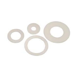

I single hand alot and always think about whether a new adjust point or tie down will require that 3rd hand while i'm sailing. 3rd hands don't grow on trees so this is what i did. I found some very wide nylon bushings and put them on the inside of the rudder pivot point. I then scuffed them up with sand paper and installed them. Wider the better, increases the amount of friction. Works like a charm and doesn't require any drilling or extra lines.
http://www.amazon.com/Made-USA-A361-763-MSC-0-031-Washers/dp/B00270PJDO
