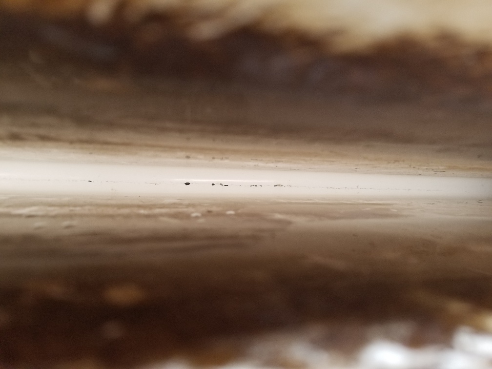

Another issue popped up with the "new" boat. I turned it on its side to inspect the bottom of the hull and check out the centerboard today. The centerboard itself needs some love, but that can wait until after the season. When I looked into the compartment, I noticed what looks like a thin crack at the very top of the centerboard slot.
Centerboard slot.jpg (159.01 KiB) Viewed 5619 times
I could barely see the crack, so I am thinking that it is a project that I could put off until I fix up the centerboard after the season (am I correct in that regard?). As this is a hard spot to work on, would brushing some epoxy on it with a super long handle brush work?

A "thin crack" that you can hardly see at the top(!) of the CB trunk doesn't sound like an issue worth worrying about. Given the location it would be near impossible to get at and it is not unlikely that it is simply a crack in the gelcoat.
