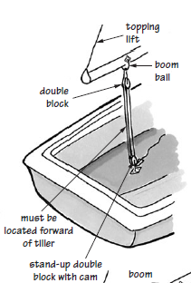

I want to change it to this style which I find has less of an issue getting tangled around other parts of the boat:
My main concern is the boom. I'm wondering if it can support the load from the one spot in the middle. Has anyone ever rigged the boom of this vintage in this fashion?

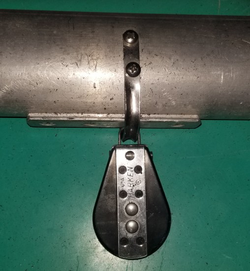

It turns out that the last block on the boom before the mainsheet drops to the mainsheet block is mounted just over a t-track where I could mount a double pulley:
I'd probably use the holes from the current pulley to mount a safely line in case the swivel on the t-rail mounted one breaks.
The current main sheet block and jam-cleat is mounted in such a way that I'd keep the mount and upgrade the block.

You could change to that setup and make it work with some attention to the process, or you could change it to center sheeting. Not that uncommon and the boom should handle it. if you can find the hardware, you might use the T track to attach a set of two blocks fore-and-aft rather than a single set of multiple blocks. That would distribute things a bit, if you are worried.
