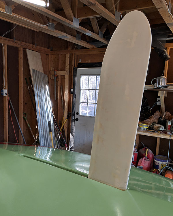

Hello, All,
I’m about to reinstall the centerboard into my 1982 DS I (Spindrift). The CB was out when I bought the boat and needed repairs to the area where the handle goes through. The hole had been destroyed and I rebuilt it with the help of an experienced and very helpful next door neighbor.
Embarrassing question but I am new to this: which way does the CB go in? The pictures I’ve seen and my understanding of the physics involved suggest that the straighter, longer edge is the leading/fore edge. I’ve never seen it in place, so I want to be 100% certain.

You got it. Another way to tell is that the pivot point is closer to the leading edge, 6 inches. For the "definitive source", look here:
https://www.daysailer.org/resources/Documents/dsbylaw3.pdf
Section 6 has the details
The rulebook is a bit fuzzy on what's the leading edge, but it's the straight side as you mentioned. For what it's worth, here's my CB... upside down in a barn, when I was painting the hull. It's fully extended, so the long side of the slot is AFT:
CB
Fair winds!
