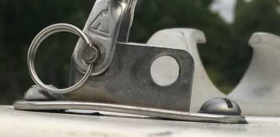

Postby TJDSII6630 » Mon Jul 01, 2019 5:47 pm
Howdy Folks,
Thought this question fit here rather that start a new thread.
Need some help with the Stemhead and tabernacle plate.
When I got the boat the rig was very slack and I've tightened things up in 3 - 4 stages.
I had adjusted the tension based on physical measurements and "TSAR" (That seems about right). Still had a slack shroud on the lee side, albeit at a higher wind as I went along.
I now have a Loose gage and the tensions are:
Fore Stay - 150 # Dieball Publication 240 - 250 # North 200 - 210 #
Shrouds - 240 # Dieball Publication 350 - 400 North 300 - 320 #
Pre-Bend - 1 inch Dieball Publication 1.25 - 1.75 North - 1 "
Top of mast to top of transom - 25' 4 " Dieball Publication 25' - 25' 3 inches (Should have measured height of mast)
Distance between the shrouds measured an inch or so above the spreaders - 41 inches Dieball Publication - Start at 36"
Spreaders are 23 inches Dieball Publication 21-22"
1/8 wire - On it when I got it
Weather Helm Much improved!
Two things I have noticed.
The top of the tabernacle has deflected down about 1/16 inch after the first 2 day trip at the present tension and there is now some interference with the tabernacle pin so I know this is new.
The stemhead had deflected up about 1/32 and I do not recall this when I got the boat. Stemhead bolts are secure and the steel plate they screw into is secure.
Both are permanent deformation.
Do I have a problem this far below the recommended tension??
When one upgrades to 1/8th wire are other parts to also be changed?
I have cut a SS plate to double the thickness of the stemhead base but did not want to weld it on until I got some advice.
I can also make a shim to take to load off of the tabernacle pins.
Teddy
Pic of Stem Head
Stem Head Deflection - 150 #.JPG (51.96 KiB) Viewed 18452 times
