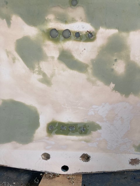

Overdrilled the holes in my transom where my rudder mounts, and filled those with Thixo. Masking tape on the inside. Easy peezy, as the thixo is nice and thick and doesn't run or sag, similar to gelmagic. Went overkill with the overdrilling at first, drilling holes that were like 5x the size, then eased it up to maybe 2x the size for the rest of the holes.
My one question is for the 3 larger holes at the bottom of this image. They are not overdrilled yet; that's their actual size. The top two are the bilge drain holes, and the bottom one is also a drain plug that connects to a cavity underneath the floor of the cabin. All get plugged by those rubber stopper doodads. I know that in theory I can overdrill those with a hole saw and then thixo them same as the smaller holes, but I'm really nervous because of their location.
If I overdrilled the top two holes, I'd likely drill into the cabin floor as well, and then would need to be sure to reconstruct it properly. And the bottom hole isn't accesible from the other side, so I'm nervous about the thixo getting in the way of the channel, although because it doesn't sag I probably won't have that problem. Any thoughts about how to go about this so as not to create another sub-sub-sub project? :)

Postby GreenLake » Fri Jul 30, 2021 9:05 pm
for through hulls/ drain holes etc. it's fine to seal the edges of the holes.

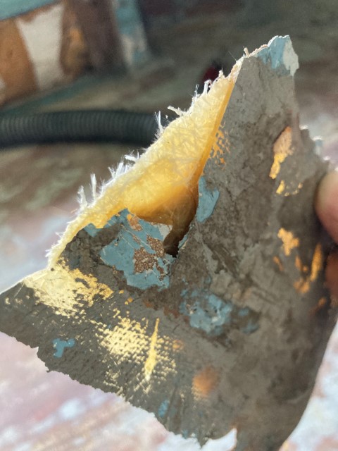

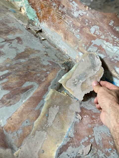

Still working with that transom, which it looks like was at some point replaced, as the existing transom appears to have been "glued in" with whatever substance the PO(s) used to do such things. They used some kind of filler to fill what was probably erosion damage at the junction of transom and cabin floor, and in the cabin floor itself. And as I'm working, big chunks of this stuff are getting loose and I can just pull them off by hand or sometimes a screw driver. I'm thinking to replace it with 3m High strength marine filler, as I can't think of anything else that's designed to hold up in such a crucial area (transom bottom inside edge) and also where it gets foot traffic. Is that about right? Would be nice if there was something cheaper than the 3m marine filler, as I'll probably need quite a bit to replace what's falling off.

What you are showing looks like fiberglass and it looks like you have an actual channel gouged out of the inside of the hull???
I get you on the pricing for the filler. It may not be the right solution for this.
I would clean out the that gouge, by solvent (acetone) and sanding. And then rebuild with laminating epoxy and fiberglass. As always, if the channel is V shaped after sanding you put first the biggest patch and then smaller, nested patches of glass to fill. You can grind/sand off any excess at the end, but don't overdo it. If you could do a cross section you would see a set of small v's nested in larger Vs instead of an inverted pyramid of short - below longer --.
Where transom meets the floor, you might want to tab that in, also with fiberglass. You need to round the corner, so you get some wood flour and mix a bit of paste with some laminating epoxy. (You could use sawdust, if you have it, or get wood flour from a vendor like SystemThree). You use that paste like you would a caulk around your bathtub, making it form a gentle transition (curve). You then put a strip of 4" wide fiberglass to connect floor and transom.
You can use the filler (sparingly) to smooth out everything when done, or to fill smaller holes

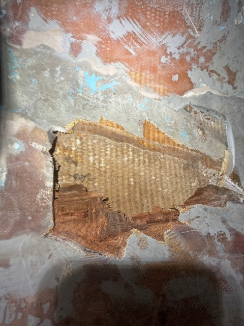

Sigh...in other news...the more I work on this old boat it seems like the further it gets from being done. I was exploring those "channels" that I pictured in my last post. One of them I was able to remove all the old glass/epoxy that was peeling off (why does it peel off and separate like that? is it because of whatever the grey stuff is that PO used? bondo? or I think you might've said it was a polyester resin?) and can just be re-filled like you said with laminate patches.
But the other one....there was a small hole through the floor laminate that went straight through to the thin cavity between floor and hull, and when I started poking around in that hole I found a lot of dry rot, similar to what I'd found in a spot on the transom last year. I haven't finished multitool'ing/grinding out all the rot, but it looks to be about a 1' x 1' piece once all is done.

Anyways, so I'm guessing I need to laminate a new piece of plywood (1/4"?) and glue it in there, beveling the edges onto the existing good floor. As seen in the above pic, the PO has that grey bondo/polyester resin stuff where the floor meets the curve of the hull at the top of the picture...and while I feel less than confident about the longetivity of that stuff, I'm starting to run out of gas/funds to keep this project going. I'd really hoped to sail this summer, but a combination of different factors, including my 1 year old undergoing chemo and spending one our of every three weeks in the hospital has seriously slowed things down.

OK. So you have a cockpit floor that's separate from the hull. I hadn't realized this (or forgotten - it's been a while since you first discussed your boat). We'll have to figure out what this means for your repair. Mainly, the issue is how to fix the floor when the repair isn't supported. We'll find an approach.
Next, your boat seems to have been put together with Bondo (or similar filler). Those fillers don't have any strength, certainly not in form of a sheet. The high-strength filler might have held up a bit better, but I wouldn't use it for anything unsupported extending beyond 1/2" of a supported area (like, it's good to add / restore the edge of a rudder/centerboard because you can build it up with some strength unlike other filler, but it's not something you can use to replace places where you'd want to use laminate.
Then, we've learned that your PO either didn't scuff sand where he applied repairs or didn't solvent wash (read the literature on your epoxy for recommended solvents) to get any traces of wax off the existing substrate. That's the reason for the separation (and yes, it's happened to me recently - luckily nothing structural - and it came off when that area was damaged and needed fixing). Being meticulous in this would be good.
Now, first, you need to get a grinder in there and grind away at the edges of these "channels" to get nice bevels at a slope of 1:12 and also to grind any wood that isn't really solid.
The openings will be too wide to just lay laminate unsupported. You can either (1) use a sheet of something that you can pull tight against the cockpit floor from below and which gets abandoned after the repair (2) laminate a very thin layer of laminate that you attempt slide in and then glue from below - in both cases held up by some wires that you can cut when the repair is done. Or, (3) you can carefully wedge a piece of good styrofoam (the builders kind, that's at least a bit waterproof) so that the new laminate has something to rest on. Again, you'd have to abandon it in place.
With the support in place, you can just lay new laminate to fill the gap. If you have a 1:12 bevel, that should be wide enough to anchor it. As some of the bevel is wood, I suggest you first seal the wood with a coat of epoxy - I happen to have a penetrating epoxy (SystemThree S-1) in my shop, and would use that. But failing that, ordinary unthickened epoxy would do. Make sure it doesn't all get wicked in, before you apply the laminate by adding a bit extra as needed.
Theoretically you could instead lay up a flat piece of laminate on some plastic/wax paper on your work bench, then saw and grind that to be a "plug" with the opposite bevel, and finally glue that in place - but the precision of the fit would make that unlikely to succeed.
If your repair isn't totally smooth (but without really big voids) you can use filler to create a smooth surface, but follow instructions on preparation!
When mixing your epoxy be really precise in the ratio - use a 2:1 if you can, they are easier to mix - and make sure to scrape bottom and sides of the container so there are no pockets of unmixed epoxy. (For the same reason, best to have a bit of epoxy left when you are done, so you don't need to scrape the final bits which are often not as good a mix. And doing so leaves a plug in the container that you can later inspect as to how well it hardened, and if you pull it out, whether there are any places where it didn't get mixed near the container walls - think of it as quality insurance).
The good news is that the actual repair, filling the gap with laminate is really no big deal; as long as the laminate doesn't bridge an open gap because you've supported it from below. If executed well, it will not come apart and be as strong as what it repairs.
PS: I would ordinarily not necessarily bother to restore the wood layer separately from the laminate, but teat it all as a single gap to fill. However, if the depth gets to be over 1/2", that might make it attractive to save on laminate. If the beveling leaves you with nicely beveled wood, you could try to fit a piece of wood with matching bevel and glue that in place with thickened epoxy - it would then serve as support for the laminate. The fit wouldn't have to be perfect, the glue should help fill small gaps up to 1/8", and you'll seal the surface when you laminate over it. Only if you can fashion something to fit with reasonable effort.
PPS: don't hesitate: if you feel like adding another layer of glass over the repair because you're not quite sure it's strong enough, go for it, It's sufficiently far in a corner that one extra layer, nicely sanded and made smooth with a bit of filler, will not look too bad. Extend 2-3" over the edge, but make sure to sand/clean that area down to the old laminate.

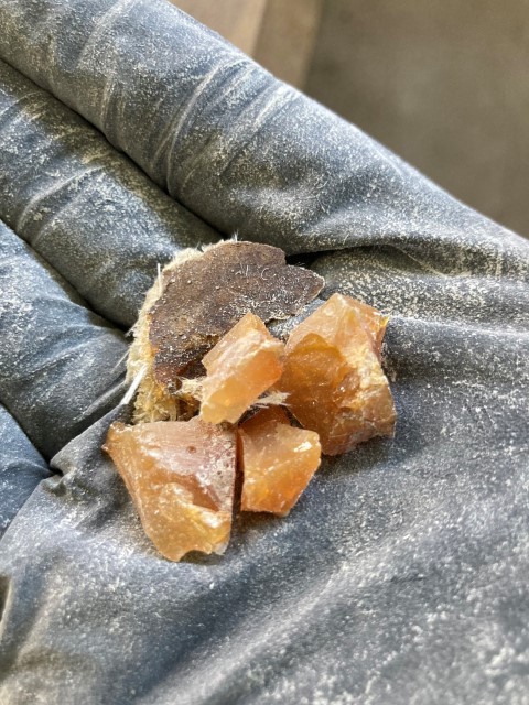

In the process of grinding away all the bondo at my repair site, I found a section that was all this amber-colored resin. I'm guessing this is what epoxy looks like after decades of break down?

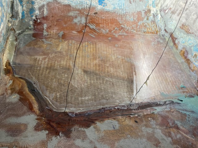

Once again, I'm turning to my trusty face shield plastic for a repair. Like you said, GL, I put a bead of glue on it and slid it under the existing floor (bottom of picture) then pulled it up for a good clamping action using some thin wire I tied off to some screws in the bottom of the rear deck. Glue was TotalBoat's version of Gelmagic (thixo). On the right hand side where the blue is where I filled in a spot using 3m marine high strength filler, because that whole spot was all that amber colored resin and there was no space there to slide the plastic under the floor (I actually notched the plastic there so it would go all the way in.) Today I will start glassing it probably. I feel pretty confident, except about the left side because I wasn't able to get anywhere near a 1/12 bevel there. I tried to give it at least a 45 degree bevel by doing a sort of fillet with my thixo there. I might just focus on the main body of the repair and then tab the sides in later. Oh, and this time I used some of the little bottle of S3 Rotfix to epoxy the remaining beveled wood - and I really like the penetration of that thinned epoxy as opposed to thickened stuff, which I feel like just sits atop the wood.
