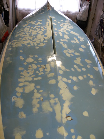

I know you are just dying to find out how the blister repair is coming along. So is my wife. Here is what the hull looks like after sealing, filling, fairing, sanding, refilling where I screwed up, refairing, resealing, re-re-sanding and re-re-sealing.
Gel coat repair. Patched and faired hull.

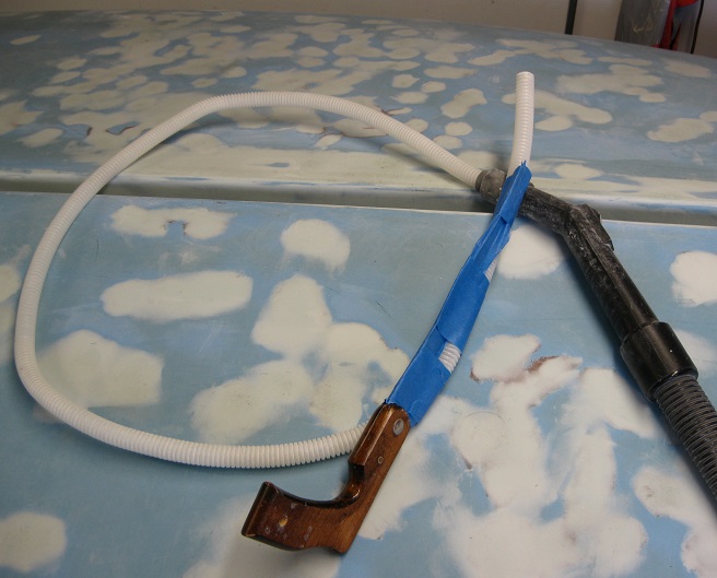

Along the way, I've had to invent several tools. My internal fiberglass patch derrick appeared in an earlier post. It turns out one big challenge is the interior of the centerboard truck, which was blistered just like the hull. Opening the blisters required putting a rasp bit on a drill extension to reach into the narrow space. To fill the divots, I cut the edge from a putty spreader and nailed it to a lathe. Sanding has been the tough one. While you want a barrier, you can't have it too thick or uneven, or the board will stick. Here is my sanding paddle, with sandpaper stapled to the end. It's not very efficient, but I am developing upper body strength.
CB trunk sanding paddle
And then how do you get all the sanding dust out of the trunk? Fortunately, I had just done a dishwasher install in our kitchen than produced a left over hose with a coupling that just happened to fit on the end of the Shop-Vac. To manipulate it, I taped it to the blade of a keyhole saw:
CB trunk vacuum extension

Postby K.C. Walker » Sun Jan 19, 2014 9:36 pm
Oh yes, fill/sand, fill/sand, fill/sand… But now it's looking shiny! You've got more small spots than I did. It looks like you didn't have to do that much in the way of fairing which is great. I had some really big areas that I had to fair out, especially near the transom. I ended up doing a lot of longboard sanding and using battens to check progress. Just think though, when it comes time to paint, it's going to take no time at all!

Postby talbot » Mon Jan 20, 2014 5:37 am
Actually, the fairing has been awful. Following the advice to underfill the depressions, I ended up with something that still looked like craters of the Moon. So then I sanded and filled again, this time going above the surface. I was making no progress with hand or palm sanding. The problem is that my hull wasn't particularly flat to begin with. In the same small area I might be cutting away at the crest of a putty lump on one side of the sander, and grinding into underlying gel coat on the other. In the end, I got out the belt sander and ripped everything down to a least common denominator. I had to then hand-sand all the belt-sander scars, but it was still easier.
The shininess is another (third) coat of sealing epoxy to make sure I'm catching any bare spots opened up by the sanding. I could have done another round of sanding, and maybe I'll get up one morning and rip the epoxy off and cut the hull down to one more level of precision. But I doubt it. I'm burned out. I think I will do a long board sand to check for any outrageous anomalies, and then bury the whole mess deep, deep in barrier coats. Like an old necromancer in a sci fi film, interring some ancient evil. And if any sorry wretches be cursed to uncover this horror, may God have mercy on their souls.
