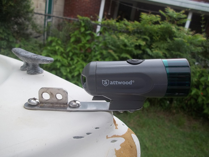

For the bow navlight mount I made this simple bracket, using the attachment base that comes with the light:
Bow navlight mount.JPG (249.53 KiB) Viewed 7476 times
Really easy to just snap the light on, and doesn't interfere with anything.
