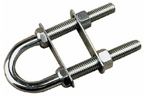

I urge installation of a stainless U-bolt rather than a single-shaft eye-bolt. Every single-shaft bolt I've ever seen on a DS has been loose. Within a few years, O'Day had stopped using single-shaft bow eyes. This is what came as original equipment on a 1979 DSII I used to own. It's from Sea Dog, 3/8" stock. $13.99 from West Marine, maybe cheaper elsewhere:

The 3/8"-16 stainless single eyebolt has a huge yield strength, especially compared with the fiberglass hull, which is the weak link. I don't think drilling two holes in the weak link makes for a stronger attachment. Based on what I've read here, I think the problem with the Daysailer's bow eye was the use of non-stainless hardware, wood backers, and nothing to keep the eyebolt from turning. I think the only thing a U-bolt adds is an easy way to keep the bow eye from turning.

My thought is that the turning is what enlarges the hole, leading to more movement and more damage. In any case, the u-bolts I have seen have been in better shape, for whatever reason.

The little plate shown for the U-bolt isn't substantial enough to really help prevent the fitting from tearing through the laminate. (Practical Sailor just had a review of backing plate dimensions and materials that's highly instructive - subscribe and get access to their online database of test reports).
I also don't think that having a double bolt helps in case of stress corrosion. Once one of the bolts breaks, the fitting is liable to pull open under moderate loads.
