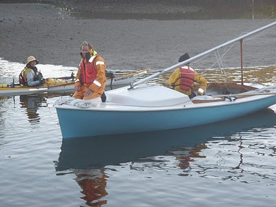

Here is a picture of a DS I from the 2010 Everglades Challenge race (300 miles). Since motors of any kind are not allowed on participating boats the boat pictured has oarlocks mounted. You can see them if you zoom in on the picture.
DS1 - 2010 Everglades Challenge.JPG (32.12 KiB) Viewed 23297 times

Looks like an O'Day. With the old wooden cockpit coaming, you could attach a side socket to the outside surface. In this case, it looks like they moved the socket outboard with a wooden block. After the DS II, the newer DS I's by Precision, Laser, and Cape Cod did away with the coaming, leaving no obvious place to attach an oarlock.

From what I read at the time the above Day Sailer I picture was taken, the owner was from England and didn't want to damage the coamings and attached the oarlocks in some temporary fashion. I read he came to the US to sail the Everglades Challenge. Bought the boat in Georgia, got it ready for the race, and sailed it finishing the race. I read that after the race he loaded the DS I on a freighter and had it shipped to England so it would be there when he returned.
