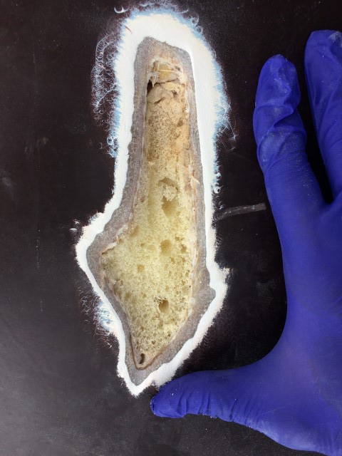

Here's what the crack looks like ground out. Turns out there was a perpendicular crack on the mid-lower left so I had to extend my sanding in that direction also. 40 grit sander worked fine, just took a while and a few discs as the edges got worn out quick.
boat repair (Small).JPG (97.43 KiB) Viewed 519994 times
My question now is: what about that foam? (I'm assuming everywhere below the waterline on the boat looks like this?) Had it just been hollow space behind there, installing a backing patch of laminate would seem easy. The foam is pretty tight against the hull, but I can push on it with a screw driver or cut it out or what have you. I imagine I wouldn't want to cut out too much though, right?

The foam is good, because it gives a place for the repair to rest against (and it's probably helping the two edges stay reasonably aligned). Just cover it with something like a sheet of plastic, so it doesn't get resin-soaked.
You are correct, it will make it tricky to put a "patch" from the inside, but even so, the repair will most likely be plenty strong. If you feel better about a 1:12 taper, then, by all means sand some of the narrower spots to where you get closer to 1:12.
Finally, if any of that dark stuff is paint, I suggest you sand just the paint off for about 2" around the repair. That will allow for better fairing of your repair when done.
PS: while you could slice a backing patch into 2" strips and wiggle them between foam and hull (with glue on), I'm not sure what that ultimately buys you. The foam already supports the area by preventing it from flexing. What do you think?

So what I hear you suggesting is to essentially use the foam as the counterforce against the exterior repair, so therefore I wouldn't need an interior patch doing that?
That sounds great, except that the foam isn't totally flush with the hull anymore where the crack was, as I ground some of it away (not much, maybe 1/4 - 1/2 inch) in order to sand off the fiberglass. My worry would be that this would create a "weak point" exactly where the patch is that could be easily pushed in. I suppose that's all the more reason to do a 1:12 taper?
A couple ideas:
-Use very hard plastic sheet as the epoxy barrier between interior hull and foam, which would be easier to jam in between foam and hull and would itself give some strength/backing to repair.
-Fill in the foam cavity that I sanded away with some kind of household product like that spray foam for filling cracks and such. Then try best I can to sand it flush with interior hull?
What you think? Also, any recommendations for epoxy brands for repairs?

At this point you are overthinking it. :D :D
To make a neat job with the same thickness laminate, you might use the plastic window of some retail packaging. That's flexible enough to squeeze in there and firm enough to bridge the hole while your epoxy is curing -- after that, your repair will be nice and strong and you won't be able to dent it (other than by using a tool or a rock). Don't worry if there's a small cavity. (The support the foam gives is for flexing of the whole side of the hull. When that's absent, there won't be any flexing at your repair site either).
You may need to divide the plastic sheet into two or three parts. Don't worry about any gaps < 1/4" or any overlaps.
More important, but far is t to make sure you get a super bond and strong laminate for your repair:
  • make sure you have de-waxed the repair area before final sanding (or all your sanding grooves will have wax in them).
  • make sure the epoxy is mixed accurately and stirred well; scrape side/bottom of container while mixing or you'll get a reservoir of badly mixed resin there
  • make sure your ration of glass to epoxy is high (don't over-saturate)
  • make sure your glass is wetter evenly out w/o white patches
  • make sure your layers of cloth proceed from largest to smallest (like nested U's).
