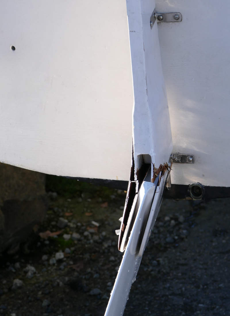

Postby GreenLake » Wed Feb 01, 2023 9:46 pm
As promised:
Rudder damage; click on image to view all
This photo clearly shows how the boat was shoved from port side and the water kept the rudder in place. The other boat never touched the rudder itself. One of the two cheeks that hold the rudder blade simply tore clean across under tension. The other delaminated inside the plywood.
After taking it apart and looking at the wood, it appeared discolored, so it looks like water had gotten in at one point. Both the outside painted surface, as well as the inside were covered with a glass sheath. Except at the break itself, these surfaces are undamaged, unlike the interior of the plywood.
Because both rudder head and blade are undamaged, my plan will be to replace the cheeks (and beef them up a bit in the process). Anybody interested in using the information here to build their own rudder might want to take similar steps for a somewhat stronger design.

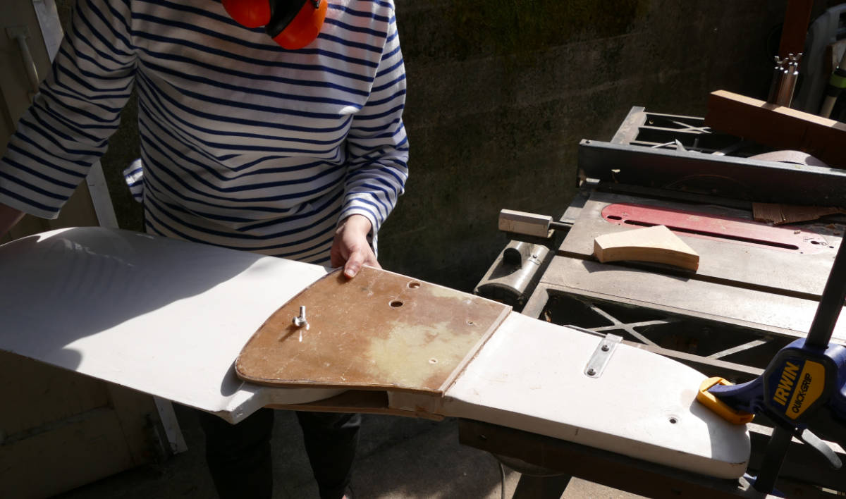

One shows the dry fitting. The cheeks are held in place by two screws that are countersunk and later covered with filler (wood dust and epoxy) and abandoned in place. They serve to fixate and also help in clamping when the cheeks are finally glued onto the main rudder head.
In the actual assembly there will be a large washer under the wing nut. The opposite side is just the typical carriage bolt head and doesn't get a washer.
Dry fitting everything

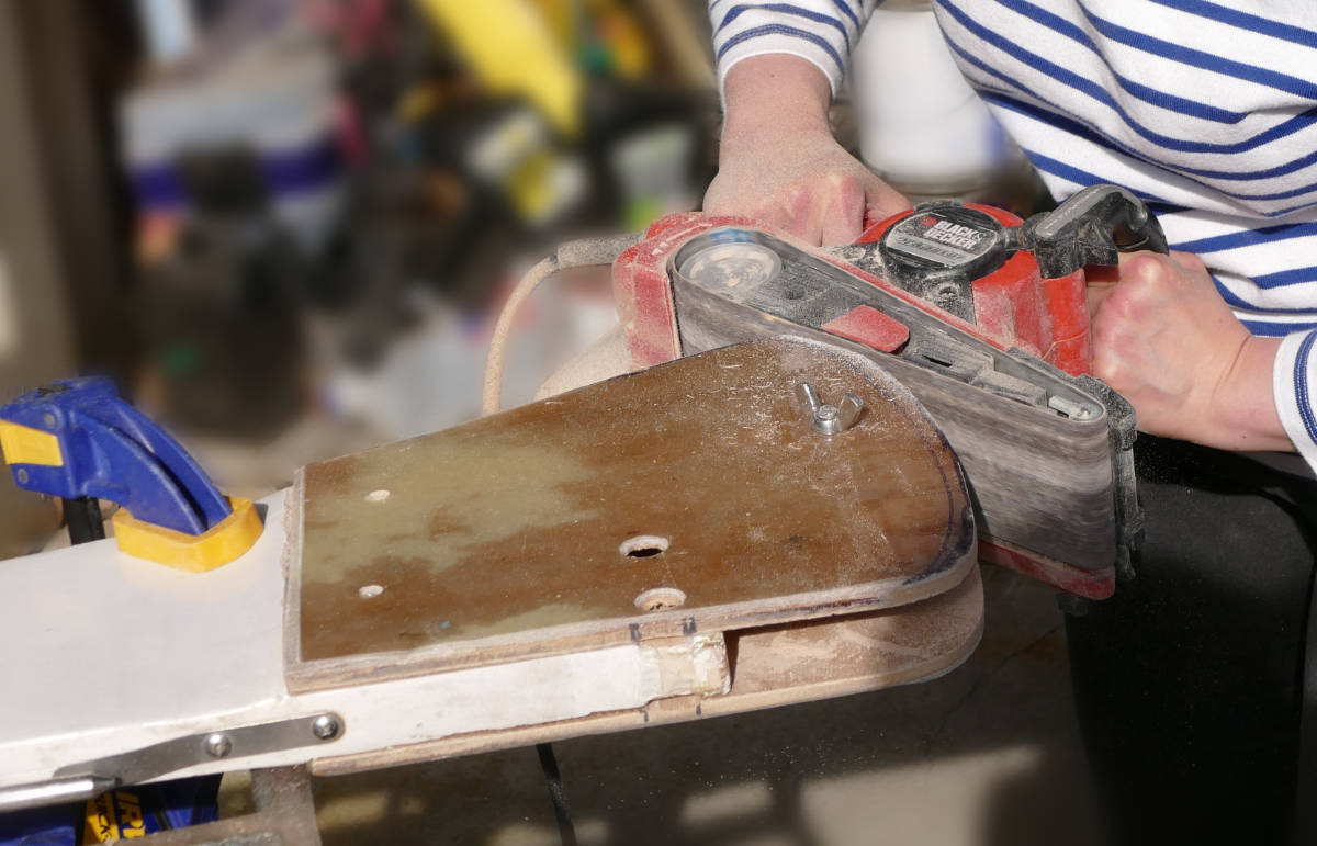

The other one shows the cheeks being sanded into final shape after rough cutting from the blanks. If you look carefully, you can see the beefed up outer layer of glass laminate (and the thinner, inner one). In order to strengthen the cheeks I opted to have the bracket for the lower pintle go into a slot between rudder head and the new cheeks, limiting the cut out to two holes that are large enough for the socket wrench for the through bolt. I was a bit concerned that I might accidentally fill that channel with epoxy, thus preventing the bracket to go in, but in the end, that part worked fine.
Sanding the final shape
Following this stage, not shown, I added another layer of cloth and a lot of filler to make a smooth transition between the part shown painted in white and the new cheeks. Both at the sides and the top. Ultimately followed by a layer of paint (Pettit EasyPoxy).
