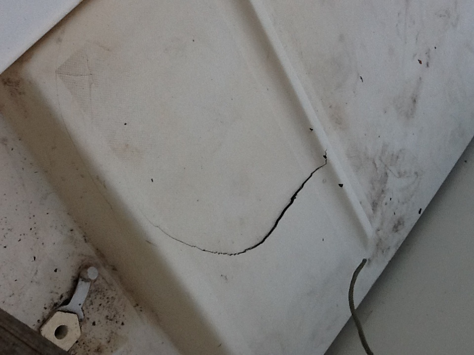

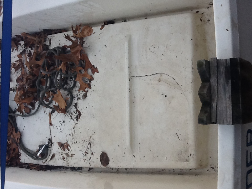

I picked up my new to me DS II this fall. This is one of the more significant repairs I need to address. The other is cracked supports inside cuddy on the ceiling supporting the deck. There are a few great posts out there addressing the Cuddy issue.
in regards to the cockpit floor, I have little experience in this type of fiberglass repair. My neighbor, Bob seems to know his stuff when it comes down to this type of project. We are planing on tackling this in the spring. I would like to have some ideas before we break out the tools. I imagine there are a 100 ways to fix anything. Ideas? Words of encouragement? Looking for input from the community here.

Postby GreenLake » Wed Nov 28, 2012 2:48 am
For those of us that don't own DSII's but know a bit about fiberglass, you could perhaps add another picture showing where abouts the damage is.

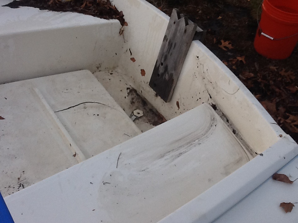

Postby Thomasjbrothersjr » Wed Nov 28, 2012 1:36 pm
There is no way to access the back of this damaged section. The damage is just forward of the transom, in the cockpit, on the floor. The bilge section is beneath it. You can also see the cockpit drain in the bottom of the picture as well.

Postby Thomasjbrothersjr » Wed Nov 28, 2012 10:32 pm
This is a better picture of its location. I love the idea of the inspection port, and it seems we are all kinda on the same page here as well.

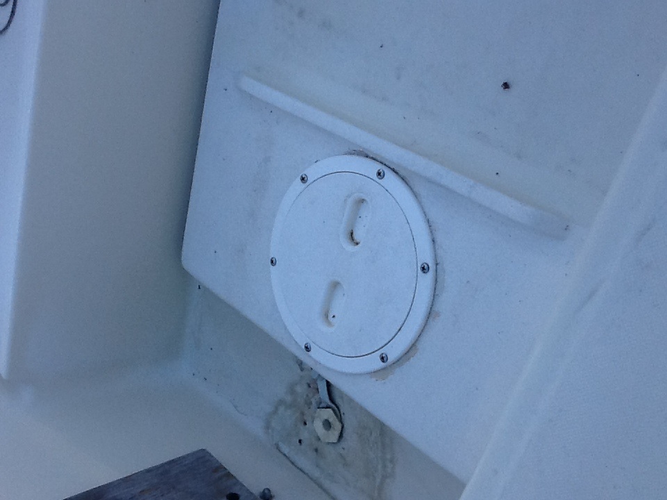

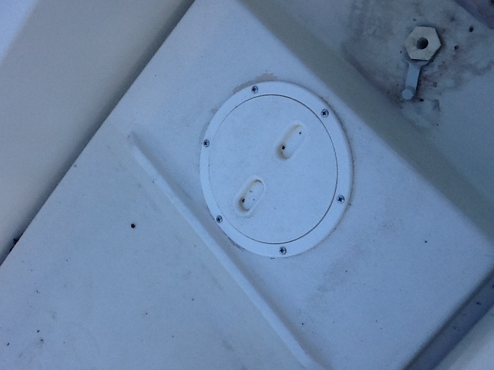

Postby Thomasjbrothersjr » Sat May 04, 2013 8:46 pm
This is the finished repair. It came out excellent. Thanks for all the advice guys!
8" port
8" inspection port
