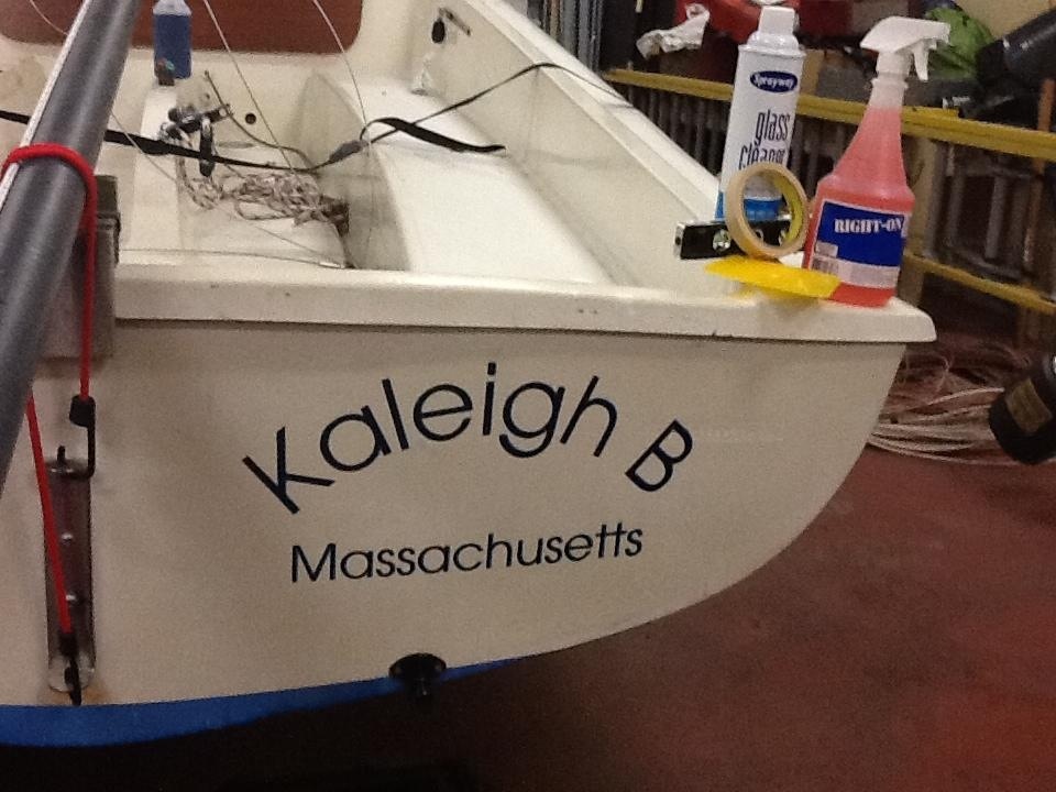

Postby Thomasjbrothersjr » Sun Jul 28, 2013 11:42 pm
Location of my bilge drain.
TBone
Thomasjbrothersjr
Posts: 77
Location: Massachusetts
Re: bilge drain installation
Postby Alan » Sun Jul 28, 2013 11:54 pm
Aha! Just as we thought...
TBone, looks to me like your drain plug is located just far enough to starboard to open into the space below the seat.
For anyone who doesn't have a DSII (or who hasn't spent a lot of time peering into its innards with a flashlight and inspection mirror, or a digital camera), the space below the seat is part of the airspace between the hull and deck moldings. The airspace in question includes the bilge.
