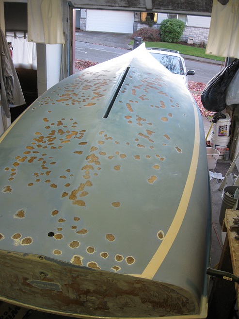

Some of you asked for photos of the gel coat repair. I consider these dirty pictures.
The first one shows the hull with blisters sanded, just before the first sealer coat.
Gel coat blister repair
There are actually several repair procedures under way at the same time here:
--gel coat repair
--repair of collision damage to keel under the bow
--repair of delamination and rot in transom
--repair of hull/deck joint.
In photo 1 the stripped transom appears at the bottom. The fairing compound smudged on the surface covers the holes used to inject low-viscosity epoxy. Also in photo 1, the after corner of the coaming shows the area where the open-to-the-water gap between hull and deck was filled and glassed in.

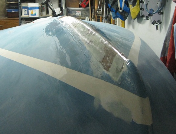

Photo 2 shows the procedure to repair through hull damage when you can't access the inside of the hull. A semi-stiff sheet of class is pushed through the opening. Once inside, it expands. Then epoxy putty is injected in on top of it, and the patch is pulled up against the inside of the hull with nylon threads (attached prior to insertion).
Hull patch

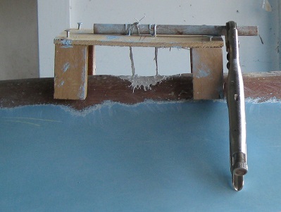

Photo 3 shows the repaired keel area prior to fairing. The patch in picture 2 had been sanded and faired, and the whole forward part of the keel has been reinforced with 3 layers of 6oz glass and epoxy.
Repaired keel area
