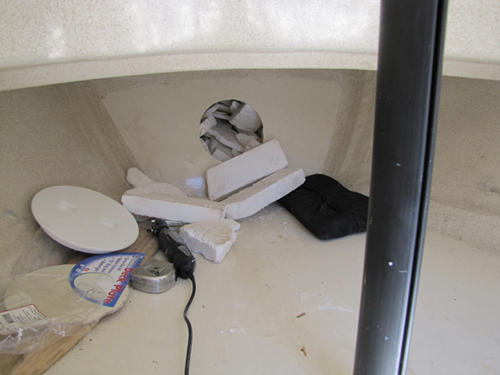

I put an inspection port in the cuddy bulkhead of my 1980 DSII. I also found a bunch of dry foam in random sizes.
bow tank opened up for inspection cover.jpg (139.82 KiB) Viewed 30890 times

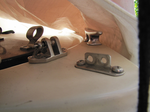

I used the access to install a second stemhead so I could attach a jib furler, here:
second stemhead.jpg (124.25 KiB) Viewed 30839 times

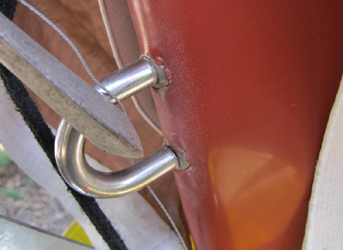

The bow hook must be original. Here's what it looks like from outside the boat:
bow hook from outside.jpg (149.16 KiB) Viewed 30839 times

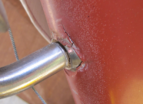

And here's a closeup of where it comes through the hull:
bow hook from outside - detail.jpg (160.18 KiB) Viewed 30839 times
The gelcoat in this area is exactly the same color as on the rest of the boat, and looks completely original. (The chipping also looks kind of ominous, especially in the closeup - maybe I should do something about reinforcing it better from inside.)
