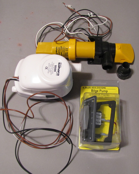

I ended up with two. My shopping was done in a state of alarm after finding a foot of water in the bilge, which managed to get there in two hours on choppy water.
I bought an Attwood Sahara 500 gpm, then read the fine print that says how much the capacity drops off when the water has to be lifted. I think it would have been down to 200 gpm by the time the water made it up and out of the boat, so I bought a Whale Super Sub 1100 gpm model. The Attwood has a mechanical float and the Whale has an electronic water level sensor.
I bought a switch for each pump with off/on/auto settings. At this point, I've got everything I need to install them except the spare time.

I saw a positive review of the Whale in one of the magazines I read. It seems really suitable for something like a DS.

As for the pump, I've read good stuff about the Whale as well. I've also read that float-type pumps like the Attwood can stick in the up position and keep running, so you come out to the mooring in the morning and find that your battery has run down.
What I know for a fact is that both pumps pump water, because I hooked them up to a battery and tested them.
As long as we're on the topic, I'd welcome opinions on where the bilge pump outlets should be. I've been thinking of attaching the pumps on each side of the mast at the keelson, then running the hoses alongside the mast, up across the inside top of the cuddy, and out through the cuddy sides. It looks like the discharge water would flow over the side rather than into the cockpit, and it would be visible from the cockpit so I'd know the pumps were in action.
