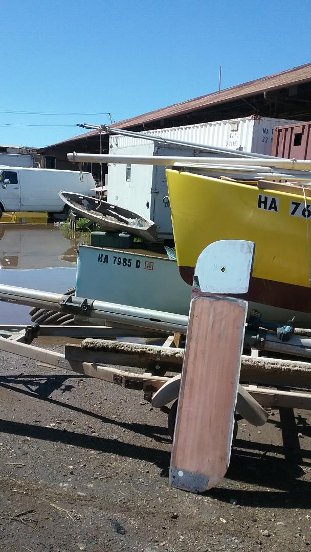

Pic below of the CB in question.
Pic taken after its beautiful foil shape was mercilessly ground off. It was too fat to fit in the trunk. Hence I deemed it unseaworthy in the event it is struck by a submerged log. It could have fractured the trunk if it got forced up in there. Somebody put a lot of time into making a really nice laminated CB with a great foil, and I ground off the foil in minutes with a monstrous grinder. Tsk, tsk. A shame, really. Now with the slimmer CB up in the trunk, there is about 1/4" clearance on each side. I will add some conciliatory new foil to it, after it comes out of surgery. Remind me to leave room for a couple coats of bottom paint.
The black/gray is lead shot. Next to the lead, you see the corner is rounded. It was straight across, as I mentioned earlier. Thinking that the 90* corner was causing it to jam and protrude (It wasn't) I mistakenly rounded off the square corner. That was before I discovered that measuring things can be really helpful sometimes. I just never dreamed the board was too fat, the cause of the tail end protruding 3.5".
I guess the straight across bottom edge shape with 90* corners was no accident, ie for performance...? Anyone know about that?
Thats an old FGlass Thistle between the yellow mystery ship and the ancient dugout.
Last nights rain flooded the yard. They pump it out. Mudville.
The trailing edge is the white edge (right side of CB in pic)

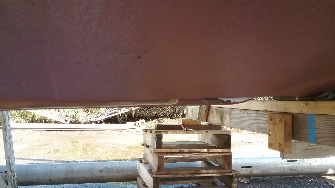

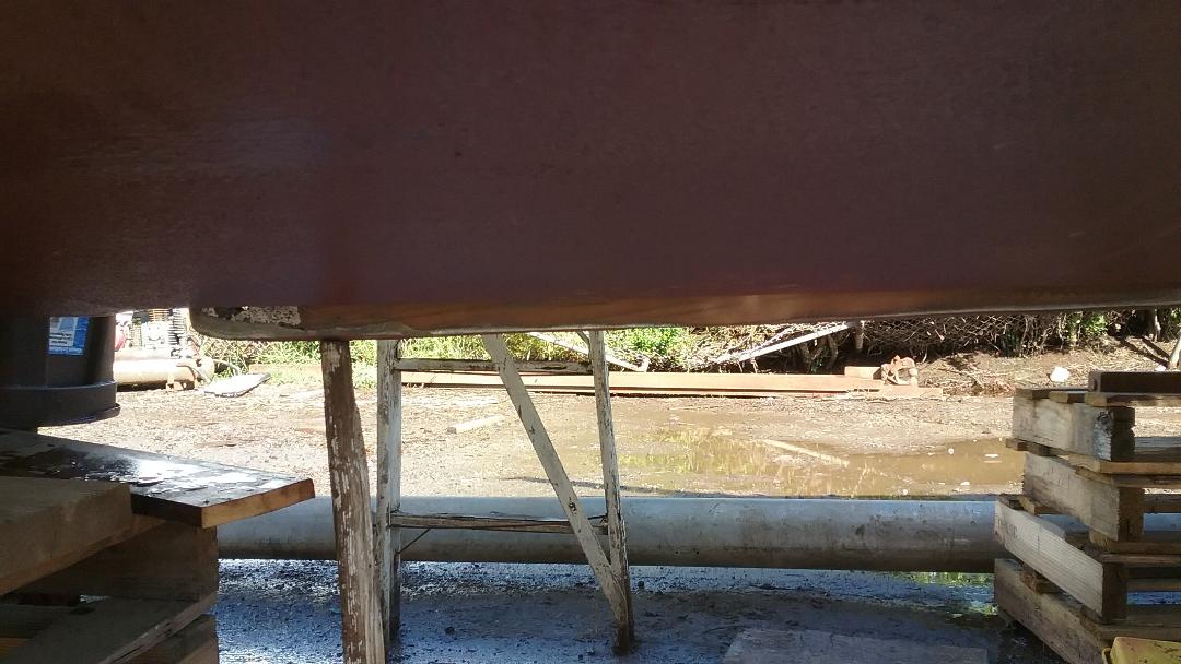

Here (pics) is the slimmer CB now in retracted position for marking cut line. Due to the pin hole's location, it protrudes when retracted. I'm not thrilled. My friend thinks I'm nuts (he's right) because I worry about submerged logs and protruding centerboards teaming up to ruin a sailor's day.
So I marked the leading edge for cutting off and reshaping. May as well get it right before re-launch.
Because it is under-wide, the after end now can tuck up out of sight, but I will cut parallel to leading edge for correct re-shaping. The wooden board is also shaped in a foil. After thusly 'fixing' the leading edge, the CB will be about 10" wide. So I think I must add some area to the trailing edge. There are a few inches of vacant trunk space available up there.
Thats the other "discussion" with my friend ie whether or not a (high aspect) foil needs to be wider. Well, it cant have much of a foil since the thickness cannot increase more than about 1/2" due to trunk width. This makes me think I should make the board wider. Thoughts?
By the way, when it was too fat, the after end protruded about 3.5 inches.
Two pics: fwd end and aft end. Poor lighting I think maybe.

I'm curious about what appears to be a "notch" in the trailing edge (?) of that CB? Seems to me that would weaken it substantially?
Re: Centerboard optimization opportunity.
Postby GreenLake » Thu Feb 08, 2018 11:17 pm
Been wondering the same.
Posts: 7371
Postby baggywrinkle » Fri Feb 09, 2018 2:37 am
TIM WEBB wrote:I'm curious about what appears to be a "notch" in the trailing edge (?) of that CB? Seems to me that would weaken it substantially?
GreenLake wrote:Been wondering the same.
Work in progress.
That prior post's pic shows rough results of grinding off the fat foil. It was such a lovely foil. before I got my hands on it. Oh well. Safety first.
The notch(es) you see are dings in the white,now nearly paper thin remnant of the thickened epoxy trailing edge, (after grinding off more epoxy, FG, and paint). The edge is history anyway. Up to 4.5 inches width can/will/may be added.
