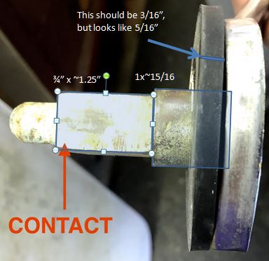

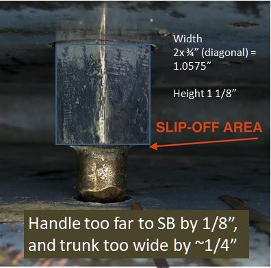

@LGSailer: Unfortunately, I do not have any pictures from the few times I've taken out my CB (and I'm not really proposing to dismount it just for that purpose) :shock: :shock: .
You are absolutely correct that the Marine Tex lacks the strength to transmit the CB handle force.
In diagnosing your situation further, it would be interesting to find out whether the real issue is that the CB trunk is too wide, or that the CB handle is too short, or perhaps mounted too far to SB. (Perhaps because of too thick a gasket?).
To that end, I've added some dimensions to your picture.
"contact" with dimensions
I know from my attempts at squaring the hole that the square section is 3/4" at its widest (it's slightly tapered). If I take that as known, I can "measure" the other dimensions in your picture. I have a spare gasket sitting around and that came in at 3/16". From your photo it looks like yours is 5/16". (I may be off a bit, so it's worth confirming). From the "pivot" photo, it looks like at least 1/8" of the square section is buried in the SB CB trunk wall. You could go to a thinner gasket and that would alleviate part of the problem.
"pivot" with dimensions
That picture confirms the 1/8" discrepancy. (You may want to double check these measurements using the real object).
However, it seems that the CB trunk is also too wide at that location. Adding just 1/8 does not allow the outer rounded section to fully insert on the other side.
However, what we've seen from the tolerances on some of these boats, having the dimension off by even 3/16" or 1/4" wouldn't really be that surprising. In use, the walls also flex noticeably. That's the reason for the retrofit like it was done on my boat.
As far as I can tell, they took the pin, milled flat the end and drilled and tapped it for the largest bolt that would fit the existing diameter of the (outer) rounded section. Then they drilled the support on the port wall to fit the bolt. When the CB is mounted, the bolt is inserted with a large washer and another gasket. The bolt is then tightened enough so the gasket seals. This flexes the P wall of the CB trunk inward, so the rounded section rests in the mount and is actually supported as intended, and also narrows the trunk so the CB cannot slide off the square section of the pin.
The milling and tapping is something for a local machine shop - shouldn't be expensive. Drilling the support on the P side is something you'd have to do yourself, unless you find a show willing to do that for you (shouldn't be too hard, really, just be sure you drill at the right location - the hole can be slightly oversized, the CB pin should be supported by the rounded outer section, not by the bolt). The bolt can be made long enough to allow a good sized gasket on the P side. But you might want to also check the dimension of the SB gasket.

Postby GreenLake » Tue Jul 21, 2020 11:54 am
Jim, you tell me.
Detail
In this picture, it does look like there's a drilled hole. In another picture, you can see that the bottom face (in this orientation) of the pin shows signs of manufacturing instead of being rubbed blank. Unless @LGSailer tells us otherwise from direct observation on site, I'm prepared to believe that his CB trunk has the required recess.
If it is a case of the trunk being too wide, then bolting the pin from the reverse will also reduce the amount of "free play" available to the CB inside the trunk. It might be further reduced by either shimming the top sides of the board and/or by narrowing the opening of the trunk by adding some strips of material. Or both. And adding a strip of several layers of fiberglass on the outside of the trunk wall should help with flexing.
