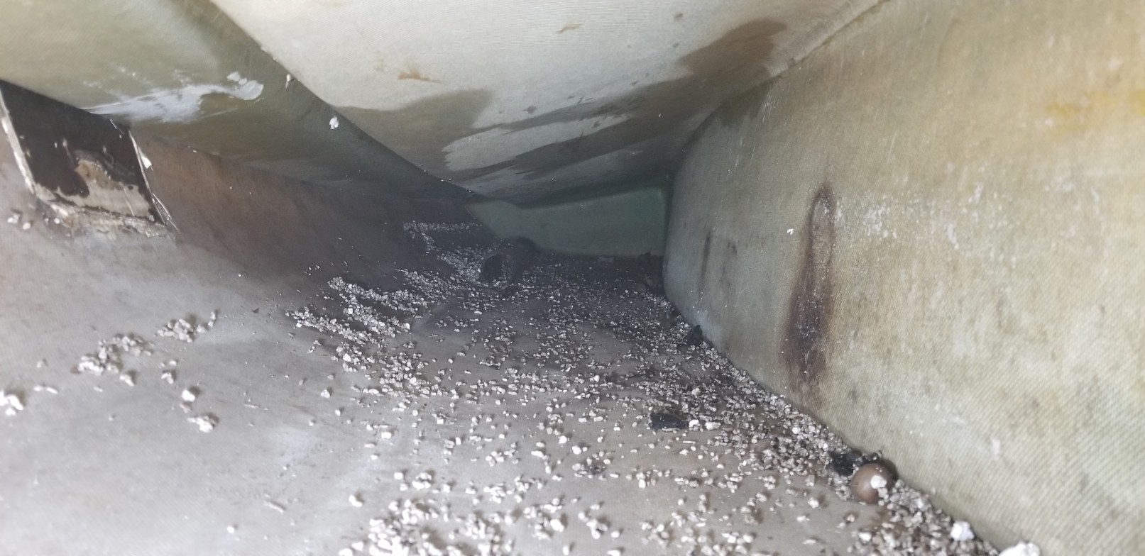

As part of the ongoing restoration project I bit the bullet and replaced the void-fill in my DS1 flotation tanks. I can across something interesting in the tanks and I'm hoping someone might know what it is. I'm guessing it's something to do with the original fiberglass lay-up of the hull but have no clue other than that. In this picture you're looking down under the starboard bench seat, through the bulkhead cover. Way at the back you can see a tubular structure affixed to the inside of the hull.
There was one in both port and starboard tanks. If anyone knows I'd love to hear what they are.

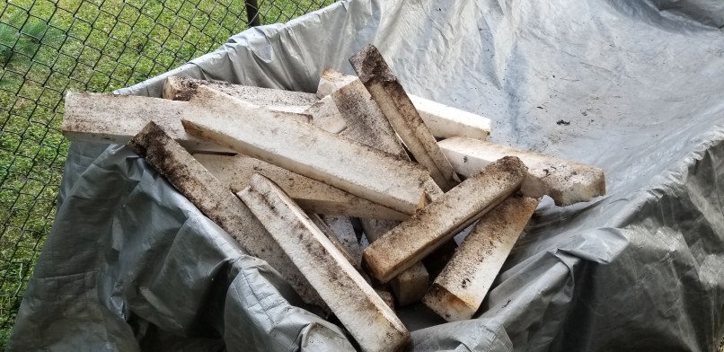

It was a massive pain but I'm glad I got the replacement done. The open-cell foam blocks were completely saturated with water. Some of the blocks were about 3lbs. I'm a bit embarrassed I was sailing around with that much dead weight. This pic is just the foam from the port tank:

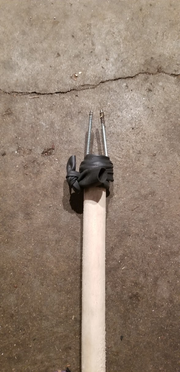

Being that heavy they were difficult to remove. I ended up making a "harpoon" with two long wood screws. Jam it in, twist to torque them against each other, and then heave-ho.

Your guess at that tube is as good as any. If it's firmly attached, it might have served as an anchor point.

I hear a lot of flexing of the hull beneath the seats when I sail. Perhaps it was put in to stiffen the hull at that location?
