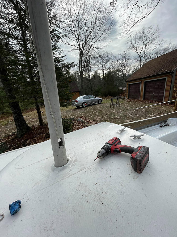

Postby Anstigmat » Sat Nov 14, 2020 7:00 pm
I got my proctor mast and the guy who delivered it I think made these cuts for exit blocks. They are pretty low down, above the slot in the cuddy. So somewhere between the deck and the slot where the gooseneck goes.
I've ordered the Harken exit blocks for the holes, but just curious how worried I should be about the structural compromise he made. If I should be worried, how can I make it a bit more sound?

Postby GreenLake » Sat Nov 14, 2020 7:31 pm
First question: how long did he sail with that?
If the boat's seen extensive use with these, that should increase your confidence.
I'm not really sure how I would rate any strength reduction. Not sure whether you can eyeball this, even. That's why, if it's been used that way for a long time, I would defer to that experience.
Also, not sure whether it is even possible to "strengthen" the mast in this configuration.

Postby Anstigmat » Sat Nov 14, 2020 8:13 pm
The dealer was sort of a marine salvage guy. I don’t think he sailed with it at all. I think he knew I needed to rig it for the DS1 and made the cuts himself. Kind of a weird situation... I’m inclined to think it’ll be ok as I am not racing and they’re low in the structure, but still kind of unsettling.

Postby GreenLake » Sat Nov 14, 2020 8:57 pm
Did you request internal halyards?
On the other hand, if he's somebody who constantly 'tweaks' boats like that as part of a sale, he may have done similar to many boats (presumably w/o most of them coming back w/ complaints of failure). Hard to know. I knew a guy who was in the business of reselling windsurfing gear and small boats and he had it down to a science wrt to doing those repairs that buyers were willing to reward. He also liked to sail a lot of his stock once or twice in a regatta before selling them on, and for that purpose, he'd do things like jury rig a spinnaker on a boat never intended for that. I would have tended to trust that guys modifications, for example.

Postby Anstigmat » Sun Nov 15, 2020 2:14 pm
I mounted the new mast today and it fits well. There was only a few minutes of dremeling to get a fit through the cuddy. Another issue is that these dang holes are mounted low. I've ordered the exit blocks I need but the process of raising and lowering the sails might be a little awkward.

Postby GreenLake » Sun Nov 15, 2020 2:21 pm
I assume your plan is to mount turning blocks next to the mast so you can pull back on the halyard while raising the sails?

Postby Anstigmat » Sun Nov 15, 2020 4:47 pm
If I find out that it’s structurally safe that’ll be the way I go yes.

Postby GreenLake » Sun Nov 15, 2020 6:28 pm
I think you'll be fine.
Any mast bend will be in the fore/aft direction at that location and that means the sides of the mast aren't highly stressed. So, should be no impact on normal operation.
In the unlikely event that you lose a shroud, the mast would be less stiff to sideways bending and may take heavier damage. However, a shroud failure always has the risk of bending the mast beyond the point where it's no longer reversible, so I'd say nothing has changed materially for you: you should already be monitoring and maintaining your shrouds, and the fact that you are less likely to get away with it, should simply be an added inducement. I lost one shroud through inattention during rigging, @zeroready just lost one in a new-to-him boat from corrosion. This does happen, but rarely. It shouldn't keep you up at night - as long as your rigging is new and well cared for.
And even without the cut-outs if you did lose a shroud, you would have stood a good chance of needing a new mast, depending on conditions.

Postby Anstigmat » Mon Nov 16, 2020 10:43 am
That makes sense, and I asked another local expert. He said much the same. So I'll stop being such a worry-wort! This is just the kind of stuff you do in the off season. Think about the boat without being able to use the boat. But I may speak to my rigging guy about having a stronger overall shroud.
