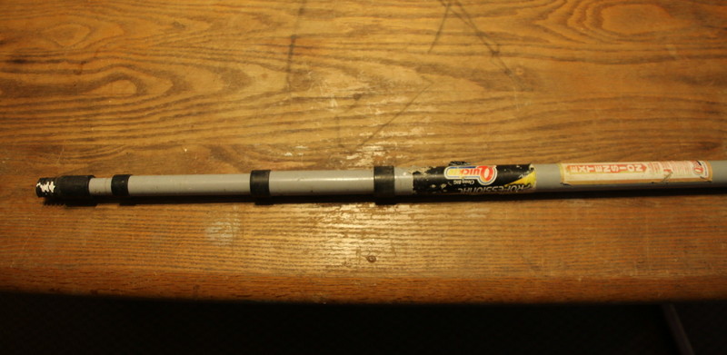

Not wanting to spend the cost of a new one, and repair parts around 50.00, I decided since I had a few extendable paint roller poles, thought one of them might work. So I disassembled both poles, and adapted the working locking mechanism from the paint pole to the whisker pole.

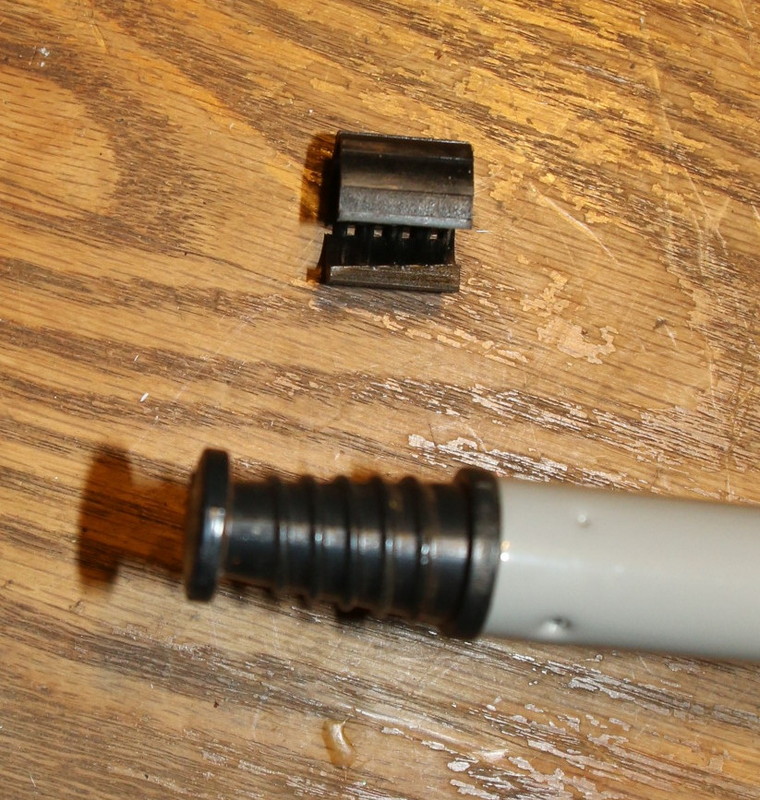

notice the taper of the threads and collar, this is what makes it expand and lock in place by twisting the pole. you also can see the retaining dimples that need to be drilled out to remove it.

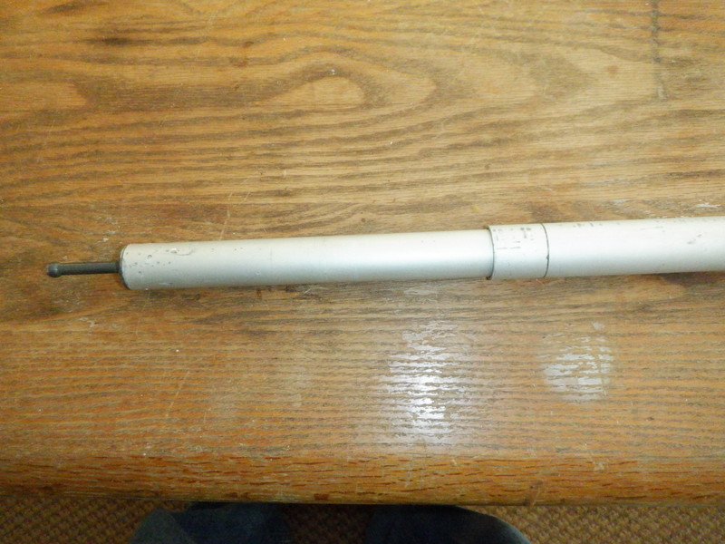

all done, sorry i didn't take any photos of actual repair process.
