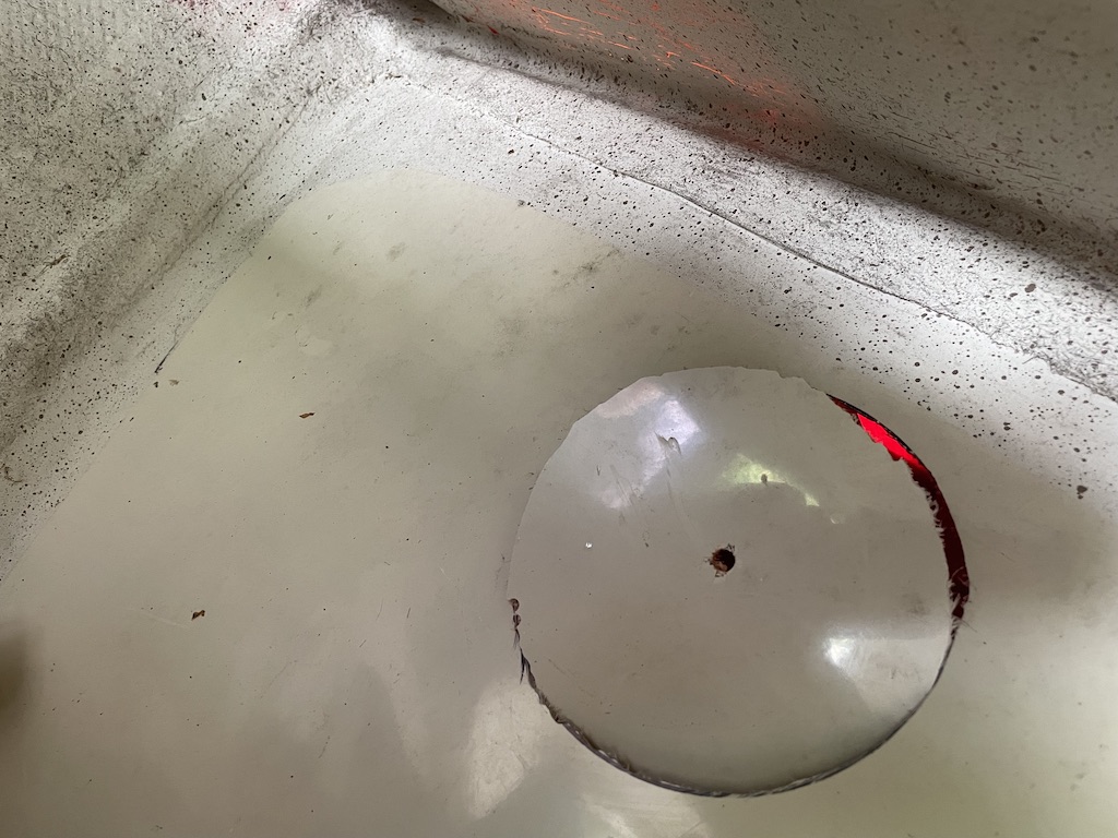

Postby RandO » Sat Jul 03, 2021 5:00 pm
Sorry for the delayed answer here, but I finally got around replacing the bow eye, and took some pictures. The picture posted by Alan really helped me go for it, so I thought I would add a few more to this thread for future reference. I was happy to see that the styrofoam filler was just chunks of styrofoam stuffed into the boat for flotation, and not a solid block that I expected to have to try and get through.
The repair was pretty straight forward. I was able to put a long metal rod into the hole left by the bow eye bolt, and found no resistance until I hit the bulkhead. The old bolt that had rusted out apparently dropped down into the styrofoam block area, and didn't need to be pushed or drilled out. I then took a long drill bit and drilled a hole in the bulkhead. I could see where the drill bit came through when I poked my head into the cuddy. Using that, I traced around a 6" deck late cover and cut the hole out. I reached, pushed the styrofoam blocks out of the way and could see the opening. The new bow eye/bolt was pushed through the opening, I used 2 large washers, one small washer, and a nut to secure the washers/bolt.I used 5200 sealant around the bow eye where it came through the hull, and tightened up the nut, squeezing the 5200 into the opening. I put the styrofoam back in, used more sealant around the new deck plate ring, screwed it in, put the deck plate cover on, and voila! Finished!
