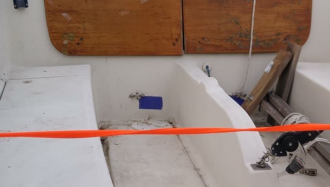

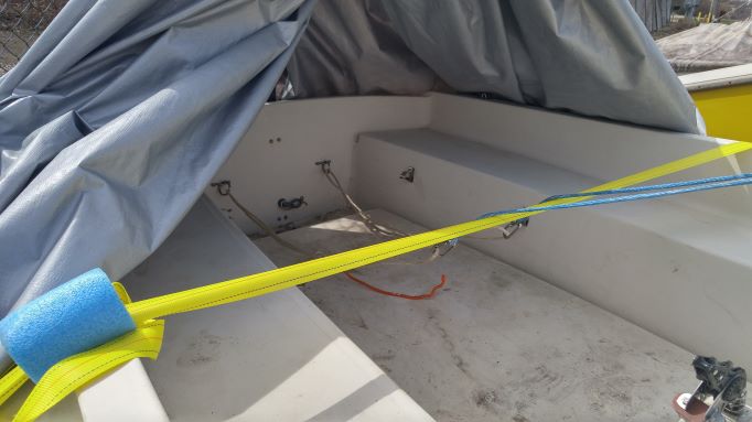

I have a DSII and it had hiking straps once. Probably rotted but the attachement points are still on the boat. I am attaching pictures. I use the stern rings for the lifting bridle now. They are through the transom and show no signs of leaking, etc. Forward eyestraps are thru-bolted to the bulkhead. Not sure you need a mid-ship fastening point. Other owners may chime in.
Chris Bartel

Nice to have the pix, Chris. With pads raised, like this, make sure there's something in your straps that allows them to give when stepped on. Perhaps have slack that just allows them to go flat, but have a bungee as part of the system to take out that slack, so they are off the floor when you are trying to get your feet under...
