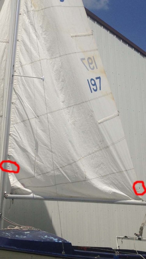

So I went to look at my sails, and unfortunately they seem to have no reef points. There is a grommet on each side above the clew and tack, but they're definitely not the distance they should be to be a 1/4 of the sq. footage, and the one above the tack is about a foot higher than the one above the clew. See attached picture below.
I googled and found a page (https://www.bwsailing.com/adding-reef-points/) that shows how to add your own reef points, and I'm a bit intimidated by adding sailcloth reinforcements (don't even know if I have a sewing machine that can handle sail cloth and that thickness thread.) And I don't even know if I need to add grommets in the middle to lash to the boom, since I have one of those rotating booms that I can wrap the sail around. After checking the sail, it seems the luff is already reinforced with plenty of width to fit grommets, but the leech is only the sail fabric folded over itself (except for additional triangles on the clew and head) and this folded section is just wide enough for a grommet and change. I'll have to canvas my sailing club to see if those guys have any ideas or pre-reef-pointed sails for sale, but what do you think about just grommeting up my existing one (after careful measuring of course) or am I out of my league once again? ;)

First, the grommet at the mast end might have been intended for a Cunningham, although it seems placed too high, if it's really a foot above the one near the clew. I can't come up with a potential use for the aft one.
Second, echoing what others have written, get your reef points installed, with reinforcements, above tack and clew. Whether you shell out for a sewing machine, hand-stitch or find a professional to do it for you, just get it done. (Most sailmakers will handle this job, even for sails that are not their own. If you don't have one in driving distance, see whether some will do it "mail order").
You do not need any grommets for sail ties, a reefed sail on a DS will stay in place if tucked in. More or less, but it's fine.

You should be able to tell from the batten position where the reef points are on my sail.
Once you have your reef points, there are two options (and no, roller reefing isn't one of them). One is to install a reef hook near the gooseneck and use a reef line at the back. The latter is used to pull the reef point down and back, so one end is positioned below the reef point and the other one is positioned a bit aft, so it ends up tightening the new "foot".
The other option is to use a reef line in the front as well, like a larger Cunningham. I set mine up to combine both into a single reefline. It works, as you can see, and needs only one cleat, but the downside is that friction prevents you from just pulling at the end. I need to reach under the boom, yank the line tight (pulling the aft reef point into position) then repeat that for the front part while not losing tension in the rear. Not too bad, if you know what to do.
Whether you use a single reef line or two, a possible advantage over a reef hook is that you don't need to use the halyard to tighten the luff of the reefed sail. Instead you use the reefline which, like a Cunningham, has an effective 2:1 purchase. (You simply drop the main halyard to a position you mark on the line, and then pull the sail tight with the reef line).
A reef hook is faster, but you need to let the halyard out a bit more, and then take that slack out again.
So there's options.

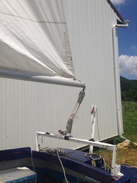

And my mainsheet is hooked up to the end of the boom by default, as per this picture. I can't remember if they joint that attaches to the traveler ropes pulleys turns with the mast or not, but it would be easy to detach from the traveler by way of one hand-removable bolt.
Or are you saying just having the mast spun on the traveler and not tied aft (as it is in this picture with the clew) isn't enough to keep it from bunching up and creeping forward?

@marcusg: sorry forgot about your special traveler arrangement. (You do have true end-boom sheeting, not the kind of hybrid sheeting that is factory standard on some models of DS and is loosely and confusingly referred to as "end boom" in contrast to center-boom sheeting; @hesedguy's post should have set me straight, but for that confusion,) You are correct that your mainsheet configuration would make roller reefing possible (as long as the boom can rotate at the end). If your gooseneck rotates, but can be locked every quarter turn, then you are free to experiment to your hearts content with roller reefing. It would certainly be less of a pain than on boats that need a reef claw.
Who knows, it might be all you need to handle unexpected conditions, but there are inherent compromises that adversely affect sail shape. Whether those are theoretical or matter to you is something you are in a great position to find out by trying it.
As you point out, it's not possible to duplicate the function of the outhaul at the new "foot" of the sail, as nothing is attached at that point that can stretch the sailcloth. The expectation would be that the reefed sail is somewhat more baggy in shape, which is contrary to what you want in high winds: there you want a flat sail to minimize heeling. We might expect that for the same wind conditions, you'd need to reef a bit deeper with roller reefing, to get the same effect.
I don't have a hard traveler on my boat, so I'm relying on a vang to keep the boom level when responding to gusts (which keeps the sail flat, even if I let out mainsheet). I find that setup absolutely essential in being able to control the boat as I get closer to where I might need to reef, because it prevents the sail from powering up just as you let mainsheet out to depower the sailplan. I would not want to have to disconnect that as soon as I had to reef, because I would then be sailing in high winds and be even more interested in a flat sail. That's my reason for not giving roller reefing a second look - the other being the need for a reef claw.
But our boats are different and if you find roller reefing meets your needs, then you certainly should have no reason for spending money on other options. But they are there, if you find you need them.
