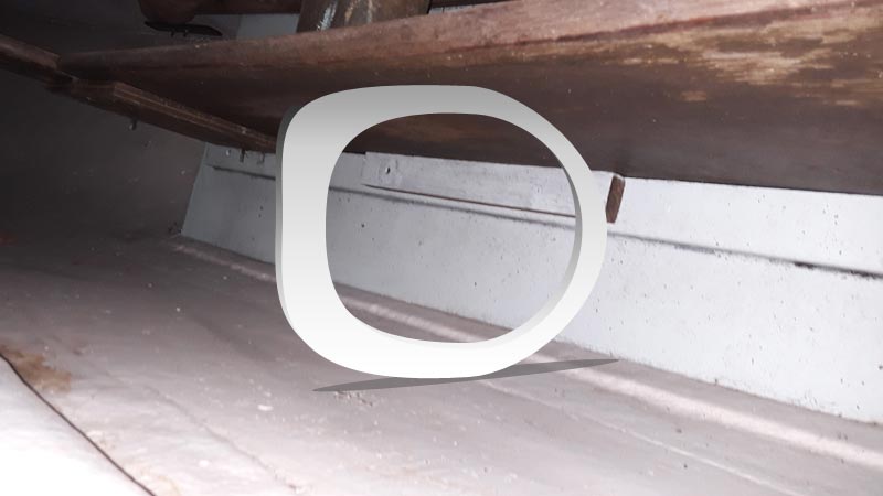

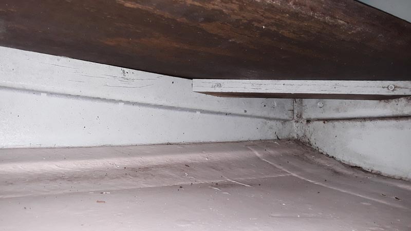

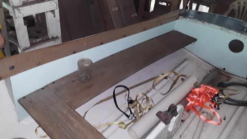

I am finally diving into my project of getting my '59 DaySailer with wooden seats fixed up and back on the water. The last couple times I have put any weight on the seat it has felt like there is more flex than perhaps there should be. Anyone with the old wood seats experience this? That seems like a pretty long span of wood to have no front side support. I have only had it out on the water 2 times since I purchased it and both times there were just 2 of us. I am planning to have 4 adults later this fall once she is ready and a little concerned about that much weight on these seats. The wood is not rotten at all, the PO kept it under a roof. But it has dried out and the coamings have a pretty good size crack that also needs repaired. So I am questioning the overall structural integrity of this setup.
Curious if others have a different setup on these older style wooden seats. Open to any suggestions you may have.
Here are some pics and a video that I shot

I've seen one of these older boats, but never owned one. Yours looks pretty much like what I remember seeing.
I don't see any reason not to add some additional support, even if it's just for peace or mind. You don't write what you have planned, so I could picture two solutions. One would be to glass in a small pedestal, and use that to attach a single "leg" to the floor which is held against the seat by a triangular bracket.
Alternatively, you could make one or more "ring shaped" supports, where the bottom and back part help the forward part act as a leg by holding it in place. In that scenario, no need to glue anything to the floor.
Why a ring and not a solid board? Weight would be one, the other is the observation that the builders changed the flotation by later added seat tanks. That points to the original flotation being possibly a bit marginal. If you have 2-3 ring shaped supports under each seat, those could securely hold one of those tubular flotation chambers, used for Optimists and other boats. That would seem like a win-win from my perspective.
Some people would tab in the bottom member of each support for extra stiffness. Just as long as the whole member is epoxy sealed, little speaks against gluing (part of) the bottom member to the floor. It prevents any movement, so no potential for rubbing etc.
The crack in the coaming. what were your thoughts about that?
I would probably attempt to glue it back - at the minimum so it doesn't extend further. For a fresh crack that can be clamped together with no gaps, I would try waterproof wood glue like TiteBond III. If there's a gap, or clamping isn't an option, I would use an epoxy glue. For a wide crack you might benefit from a filler (wood dust), for something narrower I'd simply use a non-sagging glue like GelMagic. It comes in a cartridge with a self-mixing tip that makes applying pretty straight forward. If a bit of clamping (or a weight) can reduce the gap a bit, I would use that, but for epoxy glue you don't want to squeeze out too much of the glue.
In one of the photos it looks like the coaming that sits on the transom is missing. that would give the back edge of the others some necessary support. If it was missing when you got the boat, perhaps try to replace it, or at least mount short pieces at the end to help support the port and starboard coamings.
Even with the crack your starboard coaming is adding strength to your boat.

2) You don't need front supports on the seats (actually side, I guess.. towards the centerline), BUT:
3) If it makes you happy, go for it. Maybe somehow fit them onto or against the raised "hump" running along the bilge, that stiffener bulge
4) The weak point in the original seat setup is where the front of the seat joins the thwart. That cleat/piece of wood underneath. Mine broke, I replaced it with a steel plate with chamfered screw holes (fun with my drill press!).
I got some pointers re: coamings, but will have to wait. TLDR: Cut them down, you'll want to sit out on the side decks. I usually sit on the side decks, not on the seats, as it is. I still have my coamings, but they don't protrude above the deck except at the very front and the transom. And yes, you can sit four adults in the boat - 1 astride the thwart, two on the deck/seat, and your lightest crew member to leeward. You'll be fine.

Postby tomodda » Wed Jul 27, 2022 10:53 pm
Ahn, I missed the design drawings you posted. Not to argue with GreenLake, but I question if these loops are needed. After all, if you are going to stuff inflatable bags under the seats, those will hold up the seats by themselves. All you need to do is fiberglass some attachment points into the bilge (D-rings) and maybe on the "wall", then lash the float bags to the rings. Also, I've measured.. Opti float bags wont fit (unless you keep them partially deflated, by why?). I think that beach rollers are a better idea. And then you can dual-purpose use them as giant fenders, or even... rollers.
As for the broken coaming, I'd put some re-enforcing pins before you glue them up. From experience - I have one broken corner on my starboard coming and have to glue it up AGAIN, I think this is third time? No matter how much I try to be careful, I either lean on it too heavily, or sit on it, or wedge the boom against it. Anyway, I'm putting pins in this time. IF I could find a 9 foot length of mahogany without going bankrupt, I'd just cut a new one. Oh well. Good that you still have your aft transom, you need that. It all locks together.. my boat has a nice bronze-reinforced screwhole on the side coamings and there's a corresponding hole to drive a screw into the edge of the aft coaming. Someone at Marscott in 1958 was handy in wood :).
